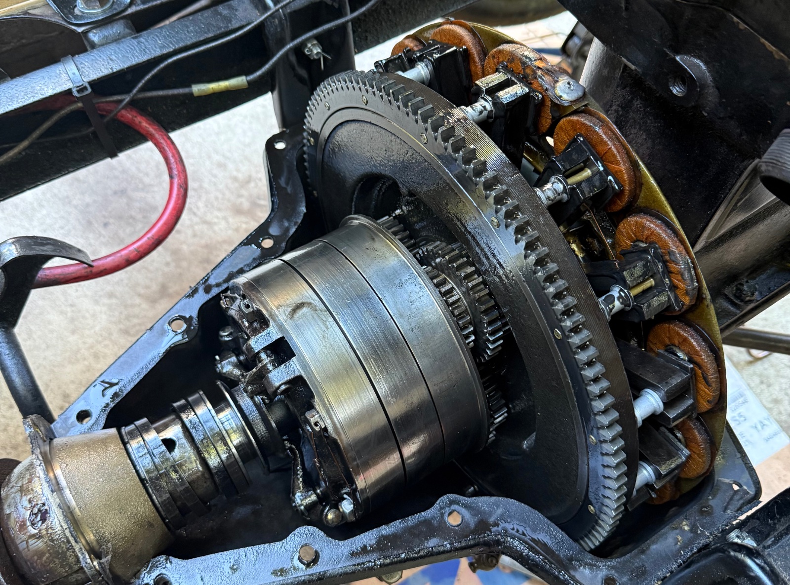

So, after a long winter off the road doing wheels, rear end, new axles and kingpins, took her for the first drive today.
Had a rotational knock noise only when rolling, and not consistent. Would happen once then fine for awhile. I thought possibly pin for the u joint slipping out. I was right. Fixed that. Drove it around again and after awhile, same noise again. Only when rolling. So I check the pin again, it's fine.
I now dig deeper. Took the cover off the hogs head and pressed each pedal. When I press reverse, I can see the triple gear that's visible, move up and down. I thought to myself, that should NOT happen! So I turn the engine over and check the others. Another was just as bad and the 3rd was as bad, but moved.
Engine and trans was professional rebuilt about 3 years ago. Was done by a guy who does mostly only T and A engines. Came recommended by Langs. He did say the trans looks to never of been touched. It did need bushings he said.
Always had a good oil level, use the Lucas classic car stuff. Changed it often. I'd say it has less than 500 miles on the rebuild.
I have a message into the rebuilder. See if he has any insight on what's going on.
Any suggestions?

If I understood what your were trying to explain is that your triple gears are moving aft toward the drums & forward towards the flywheel on the triple gear pins. Is that correct? If so you may have some issues. The triple gears are only engaged in low & reverse however if not checked for correct tolerances (0.006-0.010) with new bushing you can have some slight movement but not much, if you used the old bushings and the flange face of the bushings are way below the minimum height you’ll have even more movement. Based on the information you gave that shouldn’t be the case. Other things to consider are loose pins, loose bushings in the triple gears because running tolerance were too tight & the bushings seized on the pins. In addition could be your clutch basket wasn’t properly spaced & locked down causing some drum float. If I’m not mistaken a clearance of 0.015-0.022 is within tolerance but if the clutch basket pin is not set correctly it can cause the drums to float a bit. In my opinion you should consider pulling the engine and check your transmission others may have a different opinion. Best John

Reach in and attempt to move each triple gear around and see if there is excessive slop of if you are able to move/rotate the gear from side to side (not rotate on the pin) or move it radially toward the outside of the flywheel. Check each one- its possible as John mentioned above that one of the triple gears seized on the shaft and spun the pin in the flywheel or the bushing has started to disintegrate. Just one thing to check before moving ahead. Best of luck!

Sounds like the engine was rebuilt incorrectly. If you can see the triple gears moving then the bushings are bad. This sounds like you need to replace the triple gear pins and bushings because they wear out together. Could also be transmission problems you are not yet aware of.
Here’s my suggestion if you don’t want anymore headaches, I would pull the engine and take it to J and M Machine in Southboro Ma which is not that far from you..They are a true top tier machine shop,true pros.They have done 4 T engines for me and I have never had any issues..
What happened to you should not happen but unfortunately it does..I don’t know who did your engine but I do know of one unscrupulous builder in Massachusetts so yeah, it happens.
No, not only after and forward, but up and down significantly

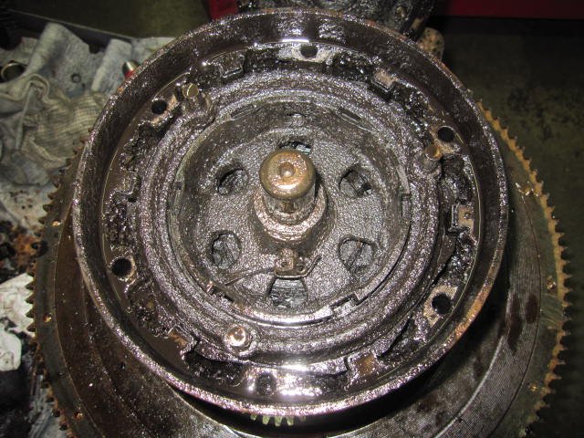

Problem with a Model T is it all has to be done, there is no 50%. The first 50% will affect second 50% and vice versa.
If they didn't do transmission, though did engine part all the dirt from flywheel and magnets will reintegrate with the engine part.
As seen in submitted picture of babbitted rear main bearing with debris stuck in it as babbitt does.
You'll see the bronze speckles .
second picture is dirty transmission. Just can't expect to get these clean by washing alone.
Money well worth doing it right rather than doing it twice.

It's all apart, well mostly. I'm deep enough to see the problem.
One triple gears bushing face chewed up, pin spun in flywheel.
Looks like a flywheel will be needed.

The pins are larger @ the base than the flywheel hole. They install from the magnet side & must be removed in the opposite direction. Never pushed thru. The pins must be a tight press fit. This appears to be your failure point. Pin bushing surfaces must be polish smooth. I understand some of the vender supplied pins are not.
The bushing face must be surfaced down to about .010 proud of the gear face. Specs in the service manual.
I believe it necessary to chamfer or re-chamfer the bushing face to the outside edge of the oil groves & be sure there is a good transition from the chamfer into those oil groves. (not done here) Plenty of oil is critical to the bushing. Assemble with oil, never grease.
Follow ALL specs from the service manual. The combination is critical for all the pieces to run in harmony.
Such a spec is the clearance between the driven gear & shaft face, it is deeper than flush.

Post by Dan Hatch » Sun Jul 20, 2025 4:40 pm
Do yourself a favor and find Herm’s thread on rebuilding transmissions. He has a lot of good time proving ideas.

Had that happen after the hill climb one year. Noisy as all H***
Find a good flywheel with decent pins, and hone the bushings to fit. A stock car will be just fine. You'll need to rebalance the whole shebang.
My 2 cents.

i am very familiar with this problem. In 2019-2021 my newly rebuilt engine & transmission suffered a series of such failures beginning within a couple of months of getting it back on the road after a 30 year sleep. The rebuilder was very aware of the importance of adequate clearance between the pin and triple gear bushings and was never able to account for why my gears hung up. He did stand behind his work although I did provide the replacement parts.
Two of the gears/bushings seized on the pins and twisted them right out of the flywheel. One had the bushing seize on the pin and the gear spin on the bushing. I suspect the pins spun in the flywheel for quite awhile to produce that amount of wear.
Each time one failed it felt like the transmission seized up. Not knowing any better, I coaxed the car back into motion, which probably was when the pins spun free or the bushing broke free of the gear. I can remember three distinct events which I now associate with the failures. Since the 2nd rebuild I have put many thousands of problem-free miles on the car so I think it was done right this time.

I rarely see a flywheel with the pin holes chewed out. The few were after current, poor rebuilds. I have seen several where the bushing seizes on the pin & the gear spins on the outside of the bushing. Even to the point of an hourglass type wear pattern in the bushing.
I suspect that such flywheel damage can be traced back to the builder gluing the bushing into the gear. (locktite) That kind of removes an unintended safety for when a bushing seizes to a pin. The un-seizure finds the point of least resistance. Just a thought.

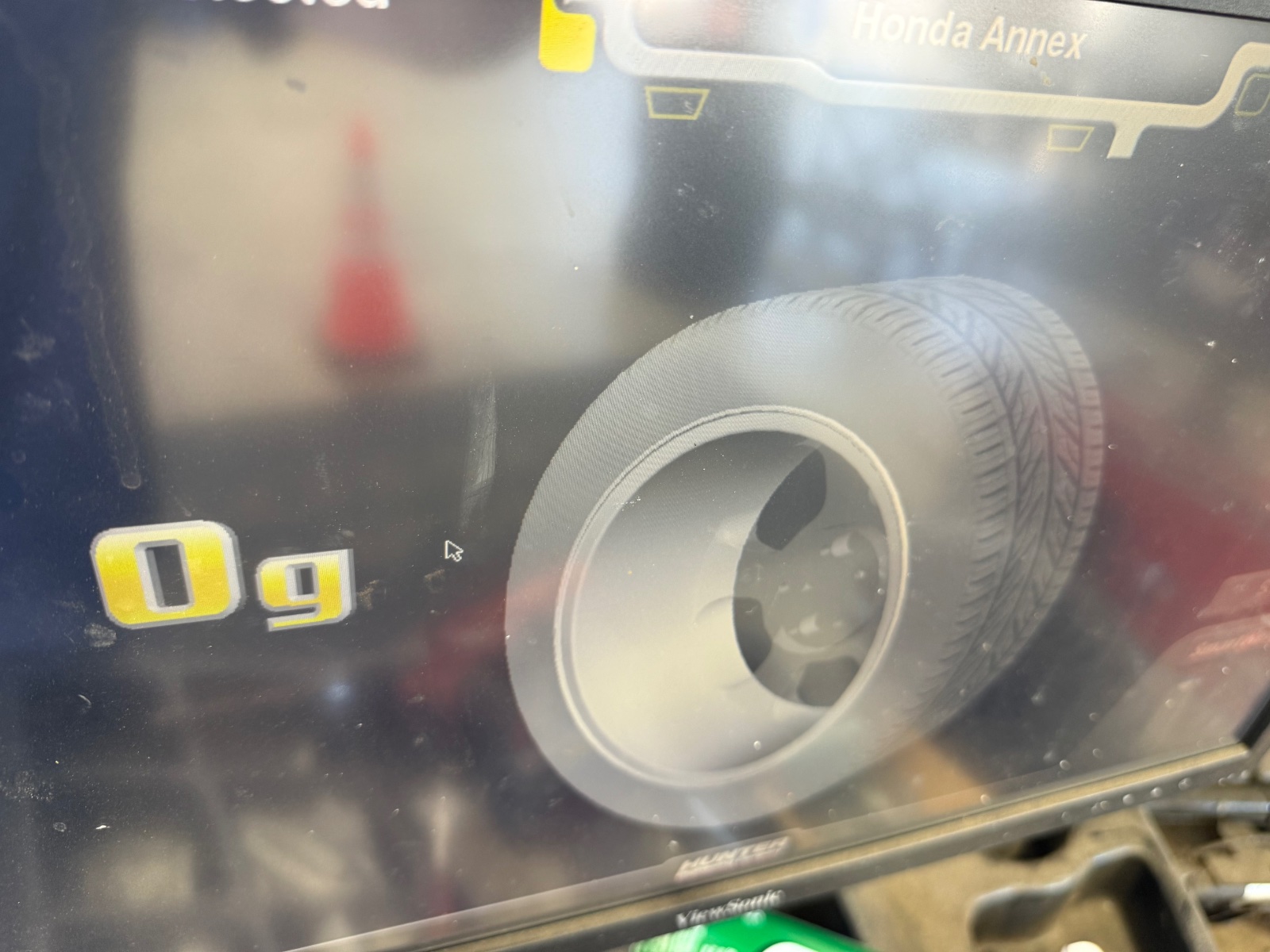

Post by nathanw90 » Mon Sep 01, 2025 7:56 pm
Update!
New (used) flywheel acquired thanks to Langs.
All cleaned up, pins measured for Dan.
New pins installed and weighed all the magnets. Cautiously laid them out. I used a harbor freight motorcycle wheel balancer to move the magnet weights around.
Work quite well. But now going to try it on the wheel balancer at work. If it looks easy enough and runout is okay, I'll do it. But otherwise I'll make a trip to a pro ;)

Post by nathanw90 » Tue Sep 02, 2025 7:03 pm
So, I tried the wheel balancer method. I believe it worked well! I started being off balance by 15 grams.
