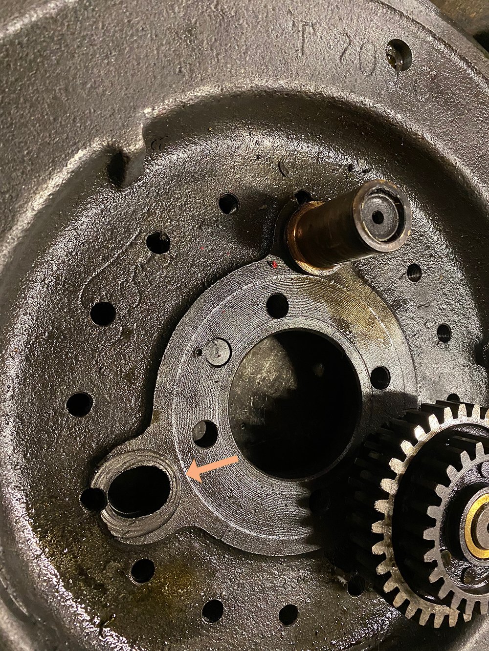

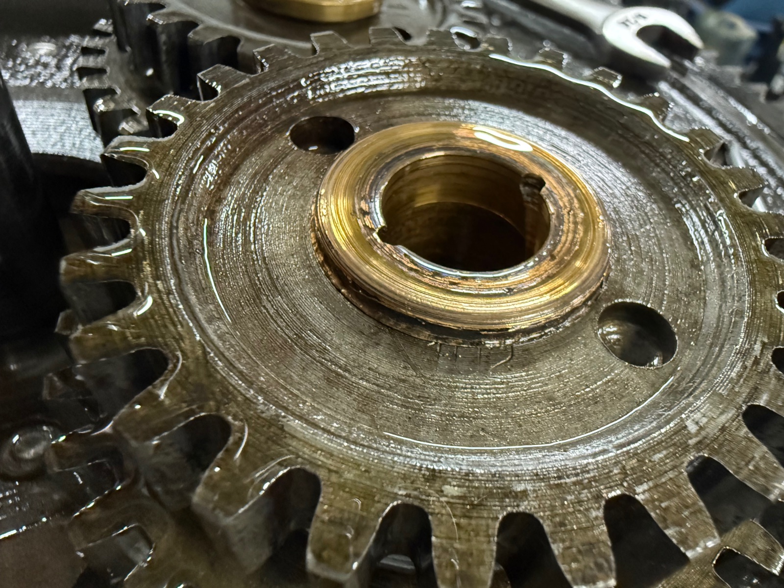

J and M Machine
- Posts: 125
- Joined: Wed Jan 09, 2019 6:46 pm
- Last Name: Gulbankian
- Location: Massachusetts
Re: Transmission issues
speedytinc wrote: ↑Tue Jul 15, 2025 11:23 amBefore pulling the motor, have a competent & knowlegable T mechanic like J & M look & confirm the problem.
Its only fair to see if the original builder will warrant his work.
Thanks for the vote of confidence.
If we look at it ,you know what we're going to find
Problem with a Model T is it all has to be done, there is no 50%. The first 50% will affect second 50% and vice versa.
If they didn't do transmission, though did engine part all the dirt from flywheel and magnets will reintegrate with the engine part.
As seen in submitted picture of babbitted rear main bearing with debris stuck in it as babbitt does.
You'll see the bronze speckles .
second picture is dirty transmission. Just can't expect to get these clean by washing alone.
Money well worth doing it right rather than doing it twice.

It's all apart, well mostly. I'm deep enough to see the problem.
One triple gears bushing face chewed up, pin spun in flywheel.
Looks like a flywheel will be needed.
- Posts: 5006
The pins are larger @ the base than the flywheel hole. They install from the magnet side & must be removed in the opposite direction. Never pushed thru. The pins must be a tight press fit. This appears to be your failure point. Pin bushing surfaces must be polish smooth. I understand some of the vender supplied pins are not.
The bushing face must be surfaced down to about .010 proud of the gear face. Specs in the service manual.
I believe it necessary to chamfer or re-chamfer the bushing face to the outside edge of the oil groves & be sure there is a good transition from the chamfer into those oil groves. (not done here) Plenty of oil is critical to the bushing. Assemble with oil, never grease.
Follow ALL specs from the service manual. The combination is critical for all the pieces to run in harmony.
Such a spec is the clearance between the driven gear & shaft face, it is deeper than flush.
Had that happen after the hill climb one year. Noisy as all H***
Find a good flywheel with decent pins, and hone the bushings to fit. A stock car will be just fine. You'll need to rebalance the whole shebang.
My 2 cents.
My 2 cents.

I have had to repair many transmissions with triple gear bushing failures. All of them were built with reproduction bushings and then set up too tight. Bushing seizes on the pin and either disintegrates or rips the pin out of the flywheel. Lang’s has Ford spec bushings but they are out of stock. The ultimate solution is Dan’s needle bearing gears. Second best is new triple gear pins and a set of original triple gears with Ford bushings. I have never seen a T transmission failure due to things being too loose. Always due to being too tight and inferior bushing quality.
