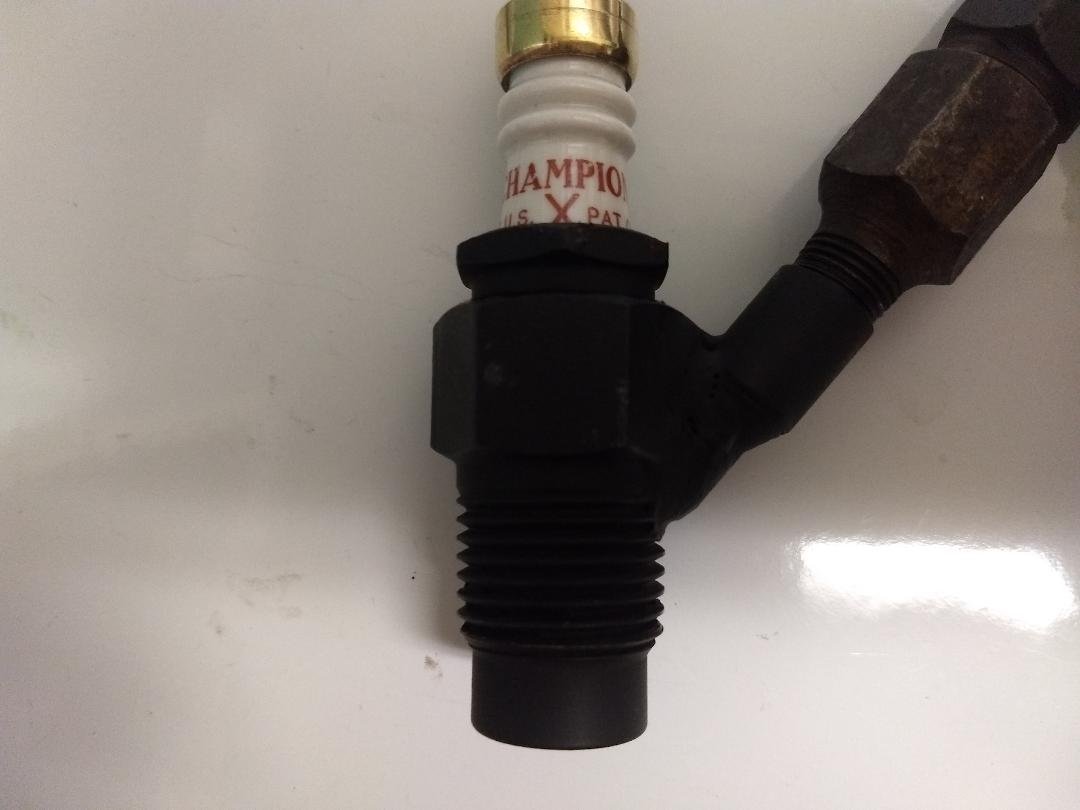

Believe you mean an “explosion whistle”.
Those devices for a T have a 1/2” pipe thread base, which has tapped opening to place any 1/2” pipe thread Spark plug. The spark plug does the ignition fire.
The whistle cylinder then carries gases of compression to make the sound, activated by the lever valve via pull chain. The spark plug and whistle component are separate.

Any spark plug can be used. Isn’t a need for a custom spark plug. Fit any brand you wish as long as the threads of the plug fit the opening in the whistle.
- Posts: 5277
Re: Whistle spark plugs
Remove the existing plug. Install the whistle. Put the old plug in the adapter. There is no special plug.

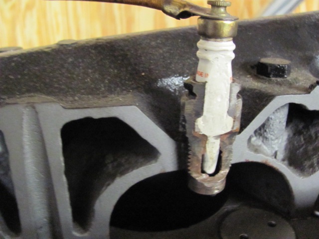

Haven't used an explosion whistle, and for that matter an 1/2" adapter in the cylinder head to install mm plugs.
IMO, it may be helpful to use a 'long reach' plug to get the electrode at least partially in the chamber.
Here is view of chamber with a standard reach plug.
The explosion whistle might be best done with a long reach, like the pretty green Splitdorf early plugs, note this collection shows these plugs with explosion whistles.

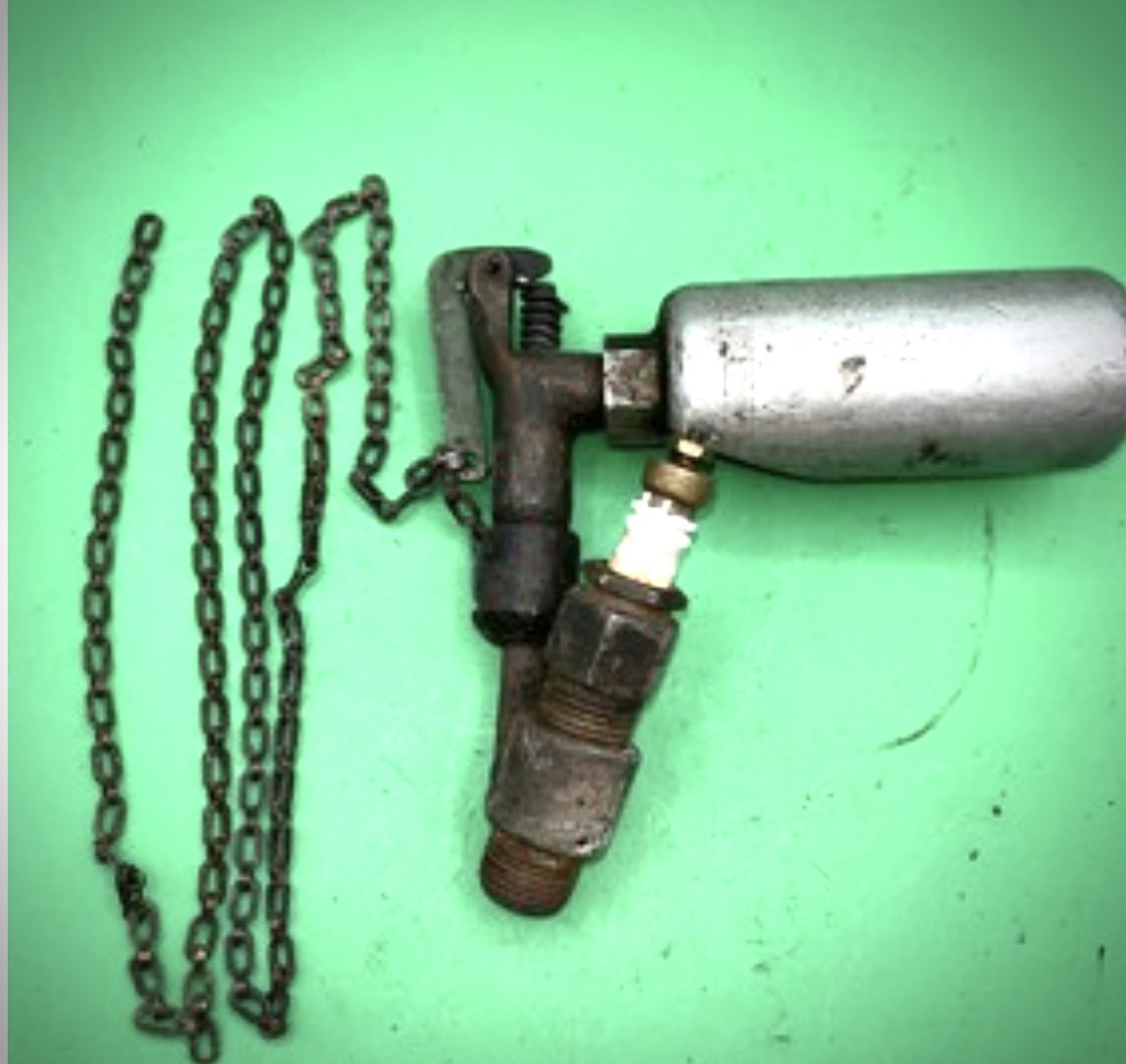

I had seen plugs specifically for the whistle that don't use the adapter...
like these....(pic stolen from a recent thread here) and that's what "sparked" my interest.

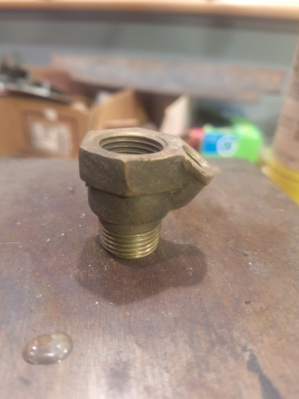

I had not seen the adapter before, but it looks like it is available from at least one of our regular dealers.
I do believe i would try to find some long reach plugs if I were to keep it on the car permanently, or find a few of the dedicated plugs -OR- try to find some long reach with the adapter.
I would imagine I'm reducing compression AND placing the spark in a less than ideal location for regular driving.... so not ideal.

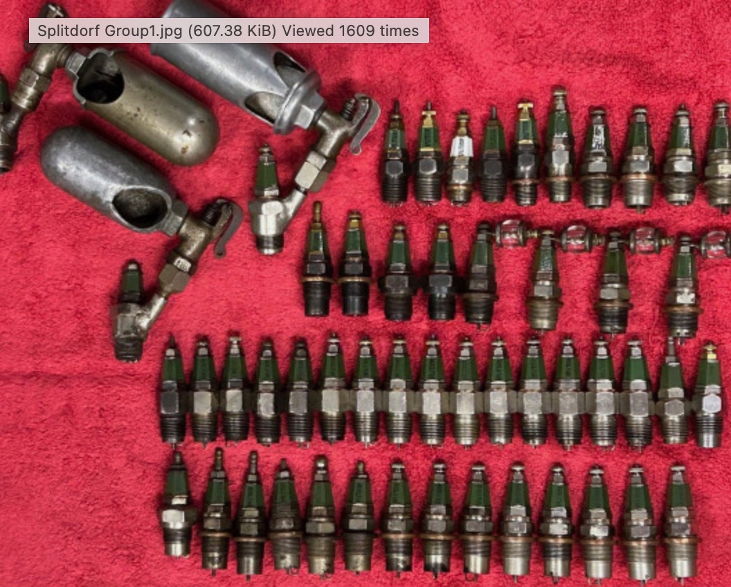

Willy, the plugs that were specifically altered for the whistles keep the spark inside the combustion chamber where it belongs, better than the adaptors that were later made. These plugs were mostly (if not all) Splitdorfs altered and sold by Buell to go with their whistles. They are pretty scarce but not impossible to find, I’ve been collecting plugs for three years now and have acquired four. Only one of which fits a T. They were made from the late teens to early twenties. Most of these old plugs will last forever though if treated with care, occasional cleaning, and a spark that isn’t so intense as to cause heavy wear to the electrode.
With a welder, drill and some tubing I imagine one wouldn’t be too hard to make out of a Champion X, if you had the patience.
I like the idea of using a long reach plug with the adapter. I tried that once with a long reach Splitdorf but it wouldn’t fit all the way through the adapter, even when I bored the adapter out some. But there are many long reach plugs out there.

Also, if you find usable Splitdorfs, they must be cleaned by hand with gasoline or some other solvent (I’ve found gasoline to work well, and it was frequently recommended for cleaning plugs during the period. Likely because it was on hand anywhere automobiles were and will cut the carbon.). DO NOT use conventional pneumatic spark plug cleaners on mica insulated plugs. The mica sheets are resistant to heat and do not crack or shatter as porcelain does, but the sheeting is thin, brittle and flaky to the touch, especially after excessive wear. These are tough old plugs and resist dropping/cracking (a big selling feature at the time), but the mica is like paper and a wire brush or grit from a pneumatic cleaner will ruin one.

I think I’ll hold out for a splitdorf plug or two, depending on the going rate…
The adapter should be under $20 including shipping if the splitdorf is too expensive.

"With a welder, drill and some tubing I imagine one wouldn’t be too hard to make out of a Champion X" Credit to Tadpole.
There is the solution.
Spark plugs with the outlet built in are quite rare & big $$. A matching set with one with the outlet built in, like the splitdorfs are mega $$$
Using the adapter pockets the spark making for poor running.
There is no deep reach plug that will extend the plug thru an adapter.
Take apart a new champion & weld in a pipe nipple @ the base & reassemble. Use the same champions for the other 3 cylinders.
Another project to my list.

The explosion whistle should do no engine harm at light to moderate throttle at light engine loading, Running the spark a little late might modulate the sound and further reduce engine stress. I would not operate the whistle on a steep upgrade for more than a second or two.
The wolf whistle can be modulated using the throttle and the pull wire. A slightly richer than normal mixture might be a good idea if using the whistle a lot.

If you're thinking of the Splitdorf plug with the whistle adapter, and you actually can find one, you're likely to end up with a used-up or "not so great" plug. These types of things work better as shelf decorations for spark plug collectors. In other words, it most likely will not be cheap and will also likely not work well.
As to the long reach plugs, for use in the more traditional style of explosion whistle, just be sure that the whistle adapter has room within it to accept the extra length.
Yeah, the existing modified plugs may very well be "used up" and that would explain why there are more whistles than modified plugs available on the ebays....
looking at online pictures of the adapter that is currently available....
I'm betting I could get it machined to sit deeper, and/or modify it to fit a long reach plug better/deeper into the chamber for more efficient combustion.... at least as good as stock combustion, or close enough that it won't matter.......

In making an adapter, I'd want to get the spark gap as close as possible to the stock position and keep the inside volume of the adapter on the cylinder side of the valve as small as possible.

I spoke with a gentleman at an online vendor and he had a suggestion for a plug to use with the adapter.....
If the experiment fails I'm out $15....

I got the whistle adapter AND a 14mm plug adapter.
The longest reach 14mm plug I have found has just over 1" reach.
With the two adapters together the 1" reach just may be negated by the use of that second adapter.
I'm still going to buy a long reach 14mm plug. I'll swing by napa after work.
I will be plugging the whistle part of the adapter and comparing the stock plug and the 14mm plug and adapter for driveability.
I could machine the whistle adapter so the plug(s) sit closer to the combustion chamber, but I don't think it will be a significant amount.
adapter is 2" maybe I could trim it up to 1.5", I could trim up the 14mm adapter to sit flush within the whistle adapter, but still at best it would be 1.5" deep.
1” is the first mark/center
Second mark is how far I would be able to machine the adapter down. I could also remove the upper lip of the 14mm adapter and internally thread it to the whistle adapter.

autolite 3095 is 1/2"-14 with a .84" reach... napa has them for $5.49 each... $21.96 for a set
champion 425 has a 1" reach but it's $39.99 EACH!!!
I may forego the 14mm plug and adapter and get a set of the autolites since the reach is close enough...
maybe when I'm rich I'll get a set of the champions.....
just realized I have no idea what I have in it now.... could already be a 1" reach....
I like having parts on the shelf anyway....
the 14mm NGK 4469 has a 1.043 in reach, but that would be negated by the unmodified adapter, AND it's $16.49 for one plug....

I don't think the spark knew or cared that it was a 1/2" from where it used to be....
the drive in was unremarkable...
I'll pick up my spare autolite plugs and toss em' in with the other spare parts....
that was a lot of concern about nuthin'

I says they are 1" reach... I'm not sure if they are measuring base to tip or what, but that's not what I was measuring....
I was being generous saying it was 0.75"
I was going to just check the tuning with the adapter and plug off the whistle hole, but I couldn't find a plug for the whistle hole.
I had shot some used motor oil in the whistle mechanism last week, and had expected to have to take it apart and re-seal it, but it seems to be functioning perfectly....
I'm happy I got all the noise makers I have learned about, but so far this one is the least impressive sounding....
I don't know if I have a true favorite, maybe the bevins bermuda bell?
If the cutout for the aermore wasn't so leaky, it might be my favorite, but I haven't taken it back apart to see if my fix will work, maybe sunday?

Prototype/proof of concept. My answer to the unobtanium splitdorfs plug.speedytinc wrote: ↑Mon Jul 28, 2025 11:50 am"With a welder, drill and some tubing I imagine one wouldn’t be too hard to make out of a Champion X" Credit to Tadpole.
This will solve my & others rough running from the deep pocket of the brass adapter.
1/8" pipe adapter brazed to plug body.
Tadpole

speedytinc wrote: ↑Thu Aug 07, 2025 8:18 amChampion mod.jpegspeedytinc wrote: ↑Mon Jul 28, 2025 11:50 am"With a welder, drill and some tubing I imagine one wouldn’t be too hard to make out of a Champion X" Credit to Tadpole.
I would be extremely interested in a step by step, with lots of pictures...
where and how are we drilling it?
Looks awesome!
Sent from the panic room, via two tin cans attached with a string, and a jail broken Marconi, while wearing a Tin Foil hat.
- Posts: 5277
1/2" rod. Tapped 1/8 npt. Od cut down to .437. Thru drilled .156" Tapered lower section. Plug base clamped @ an angle. 3/8 end mill for the adapter piece to sit. Drilled .156 hole in plug base. Brazed together.
That ought to be enough info to reproduce.
Be careful to clear the base taper where the copper gasket sets.

Thanks so much, I'll get started on those as soon as I can, is there a special recommendation on the plug used?speedytinc wrote: ↑Thu Aug 07, 2025 2:55 pm1/2" rod. Tapped 1/8 npt. Od cut down to .437. Thru drilled .156" Tapered lower section. Plug base clamped @ an angle. 3/8 end mill for the adapter piece to sit. Drilled .156 hole in plug base. Brazed together.
I have champion X plugs installed, but supposedly have some autolites coming from NAPA...
- Posts: 5277
Has to be a take apart plug I think. Champion X.
WillyR
