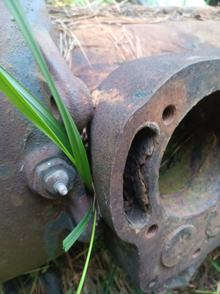

Craig Leach wrote:
Wed Aug 06, 2025 8:25 pm
Hi John,
You should be able to fit the 26/27 trans in your 3 dip pan & use the 23 hogs head, you just can't use the wide band as it will not be centered
on the drum & you can't use the 26/27 hogs head because the ears collide with the back of the block.....
Are you sure about that? I have an early (generator) not 26/27 block with a 26/27 hoggshead and early transmission here. The ears on the hoggshead clear the block. The brake band is not centered on the drum as expected. Also the 4 dip pans have a bulge to accommodate the larger drum/band. It may clear in a 3 dip without the band over the entire drum, not sure what the clearance would be.
Craig Leach
Posts: 2014
First Name: craig
Last Name: leach
Location: Laveen Az
Re: Wide brake drum vs. narrow drum interchangability
Post by Craig Leach » Thu Aug 07, 2025 12:33 pm
Hi Chad,
My experience has been that the bulge in the back of the earlier block collides with the ears on the 26/27 hogshead. I just barrowed a 27 block
to mock up a speedster ( the engine going in it will have a 26/27 hogshead on a early block with the ears cut down) so I want the pedals to fit.
My recollection is the wide brake will fit in a 3 dip pan but the wide band will not & it might be good to cut 3/16 off the end of the wide drum
to do it. Gregg, All previous branches of the diagnostic tree would be good info in the first post.
Craig.

Craig Leach
Posts: 2014
First Name: craig
Last Name: leach
Location: Laveen Az
Post by Craig Leach » Fri Aug 08, 2025 12:14 pm
Hi Chad,
Good to hear that some 26/27 hogsheads will fit the early blocks I just haven't had that kind if luck with that combination.
Craig.

babychadwick
Posts: 732
First Name: Chad
Last Name: Azevedo
Location: Henderson, TN
Post by babychadwick » Tue Aug 12, 2025 9:14 am
Hi Chad,
Good to hear that some 26/27 hogsheads will fit the early blocks I just haven't had that kind if luck with that combination.IMG_3692.jpgIMG_3691.jpg
Craig.
Guaranteed to go on when the engine is out of the car. Once in the car deals off lol.
Posts: 5400
Last Name: Hatch
Location: Alabama
Post by Dan Hatch » Tue Aug 12, 2025 9:56 am
Early blocks are square on the back of block. Later blocks have a sloping rear. Easier to remove HH. No sure of change date.
Posts: 7133
Post by Allan » Wed Aug 13, 2025 5:32 am
The lug ears on the 26-7 hogshead in Craig's post have been modified to allow it to fit. Normally the block side of the ears is flat against a flat land on the 26-7 block.
