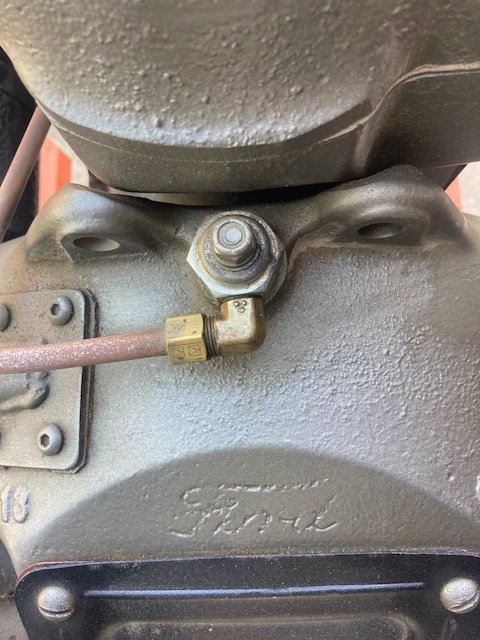

Are you sure about that? I have an early (generator) not 26/27 block with a 26/27 hoggshead and early transmission here. The ears on the hoggshead clear the block. The brake band is not centered on the drum as expected. Also the 4 dip pans have a bulge to accommodate the larger drum/band. It may clear in a 3 dip without the band over the entire drum, not sure what the clearance would be.Craig Leach wrote: ↑Wed Aug 06, 2025 8:25 pmHi John,

Hi Chad,
My experience has been that the bulge in the back of the earlier block collides with the ears on the 26/27 hogshead. I just barrowed a 27 block
to mock up a speedster ( the engine going in it will have a 26/27 hogshead on a early block with the ears cut down) so I want the pedals to fit.
My recollection is the wide brake will fit in a 3 dip pan but the wide band will not & it might be good to cut 3/16 off the end of the wide drum
to do it. Gregg, All previous branches of the diagnostic tree would be good info in the first post.

Should fit...
I assume you intend to run a 4 dip pan as a 3 dip won't fit with the band on the 26/27 hoggshead."Those who fail to plan, plan to fail"

Good to hear that some 26/27 hogsheads will fit the early blocks I just haven't had that kind if luck with that combination. Craig.

Guaranteed to go on when the engine is out of the car. Once in the car deals off lol.Craig Leach wrote: ↑Fri Aug 08, 2025 12:14 pmHi Chad,
Good to hear that some 26/27 hogsheads will fit the early blocks I just haven't had that kind if luck with that combination.IMG_3692.jpgIMG_3691.jpg
Craig.

Early blocks are square on the back of block. Later blocks have a sloping rear. Easier to remove HH. No sure of change date.

The lug ears on the 26-7 hogshead in Craig's post have been modified to allow it to fit. Normally the block side of the ears is flat against a flat land on the 26-7 block.
The 26-7 wide brake drum and its attendant driven plate will fit in a three dip pan with no modification. The wide brake band will not fit. There is nothing to stop you from using the narrow band on the wide drum, with the attendant hogshead with its evenly spaced pedals.
Machining the wide drum to the same width as a narrow one is pointless. The drum will fit as it is. The benefit is there is a continuous drum surface for the band linings. Often when building a transmission with the small drums it is difficult to get a drum and a driven plate with matching diameters. As the outside diameter of the driven plate forms part of the brake drum surface, it is preferable that there be no step between the diameters of the two components. Using both the 26-7 drum and its driven plate also removes the necessity to modify the bolt circle holes in an earlier driven plate to make it fit a later drum.
All that said, the restored chassis I bought with the Holden body on my 1924 tourer has had a relief worked into a three dip pan so the wide band will fit! It has the usual 24 hogshead with equal pedal spacings, so if a wide band is in use, the ears have to have been shifted forward of centre on the bands. I have yet to have a need to check out just what has been done. It hasn't broken, so I haven't had to fix it yet.
