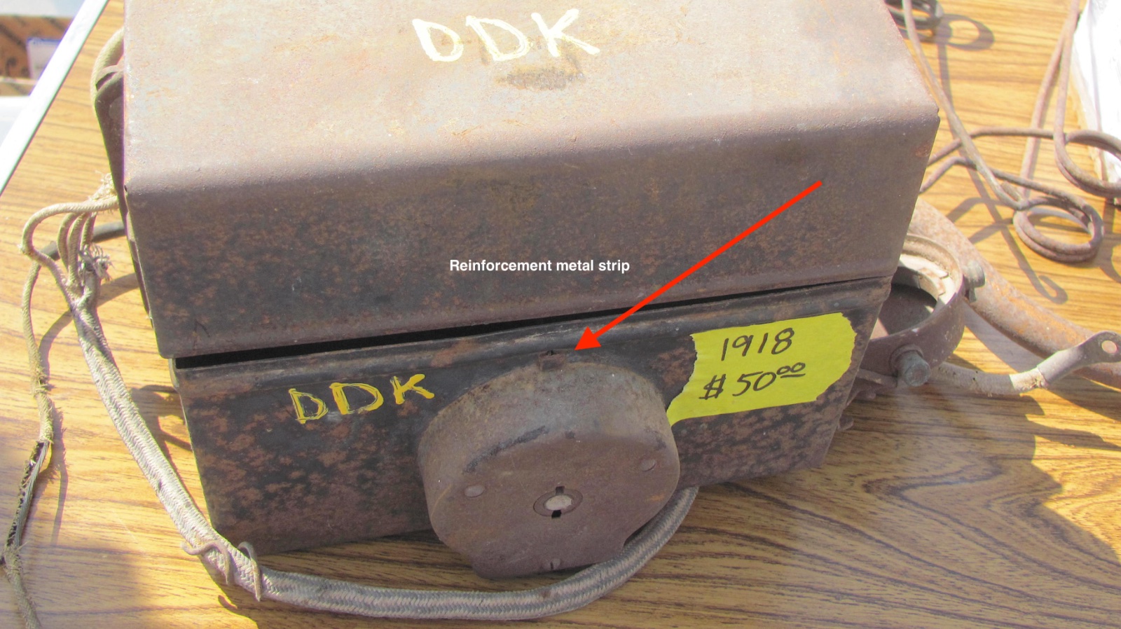

Here is a 1918 box with steel face switch and sure enough has the reinforcement strip from front to back wood. Was searching my old Chickasha photo files just ran across this one , oops :(

I am certain that I have had and seen a lot more coil box metal bodies that did have both the switch and the reinforcement strip than I have seen ones that had had a switch but without the reinforcement strip.

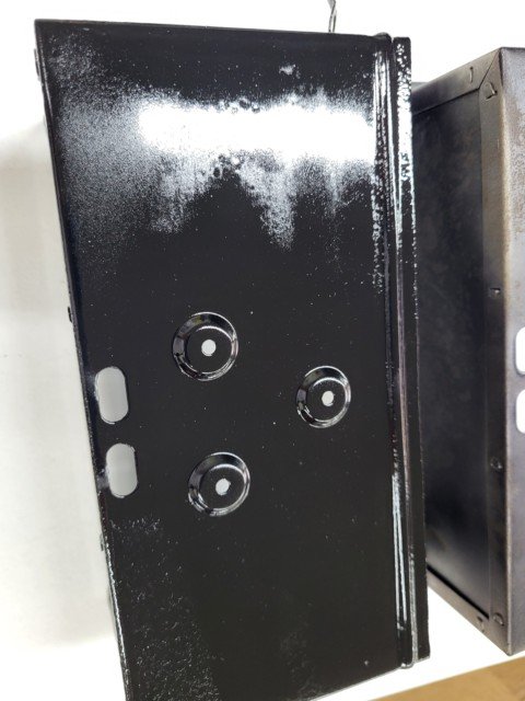

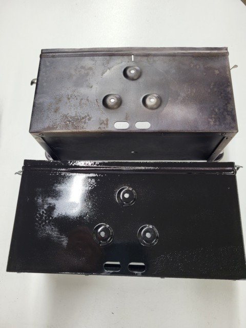

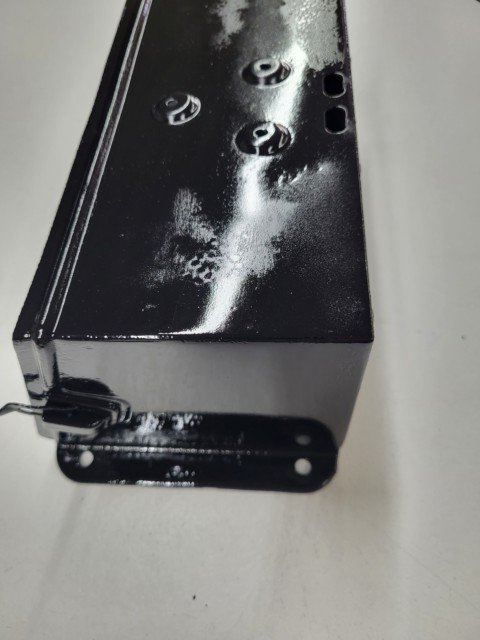

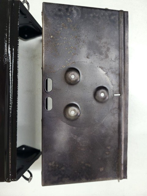

Here are the two boxes that initiated my original question as to year is issue. Both had front mounted switches. The no slit box may have had limited time in production.
Dan easy on the crow, maybe it is better with seasoning.

Does the no slit box have round mounting holes or square holes?

Kieth: yes the no slit box has round mounting holes

1915-1916.
