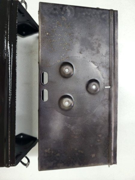

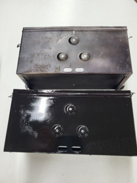

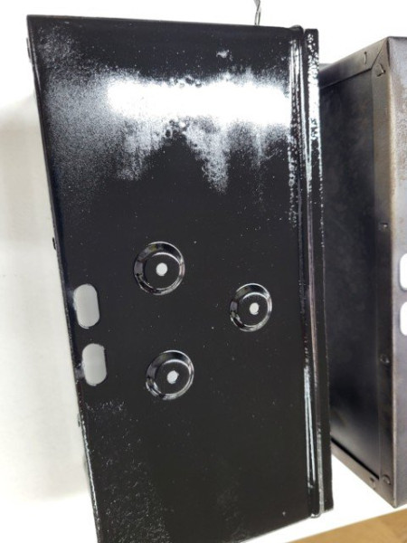

Post by Jack Putnam, in Ohio » Mon Sep 15, 2025 9:28 pm
Here are the two boxes that initiated my original question as to year is issue. Both had front mounted switches. The no slit box may have had limited time in production.

Does the no slit box have round mounting holes or square holes?
