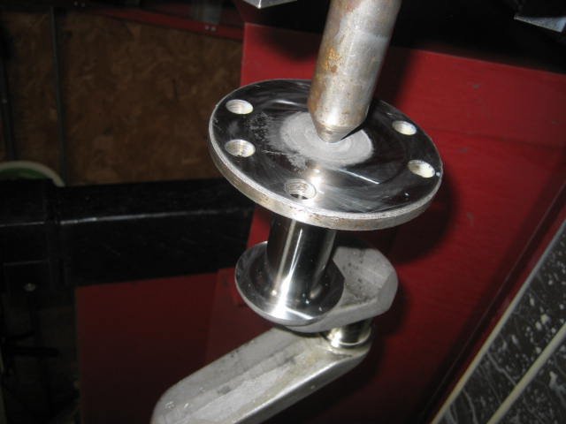

OK, I'll kick it off this time. I spent the first day of the month in Tulsa for a work day in Mike Bender's shop.
The main shaft was a mighty tight fit, so it went in the lathe for a little shave.
We fought runout for quite a while, but we finally got it under .001".
Balancing. The duct tape keeps shavings off the magnets.

Nice little series, Steve & Mike

You are very fortunate to have someone so close by with that knowledge !!!
That's for sure. Videos are nice, but nothing beats working with the actual guy with the right tools.

Another work day in Tulsa. It shouldn't have, but assembling the transmission took up most of the day.
Checking the new brake drum for balance.
Looks like it's ready. Looks can be deceiving.
The first hangup was .038" where there was supposed to be .017" - 022". That wasn't too bad. All it took was a change of washers.
Nobody will ever know what's in this 1915 unless I tell them.
A more difficult problem was excessive tail shaft runout and binding. We thought maybe the triple gears were standing too tall, so Mike faced the bushings. That wasn't it. Problem not solved. Eventually we figured out that the brake drum bushing was sticking out of the drum enough to cause the binding. A minute in the lathe fixed that, and curing the binding also fixed the runout.

Transmission assembled after a difficult day.

Gonna be a smooth running engine Steve.

Crank that we're grinding for a 1927 Model T.
