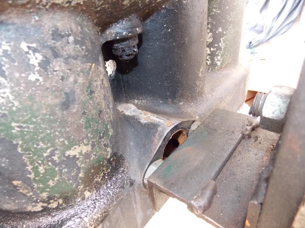

Excessive cam shaft end play revealed that this hole in the bearing is oversized.
The cure was to build up the bolt with a little brass.
After this got a turn in the lathe it was a perfect fit. No more back & forth shaft.

My latest project is taking apart this rear axle to see what I need to buy/replace so I can use it. Some parts have a little rust and will be enjoying a treacle bath.
