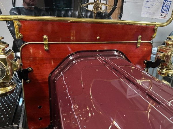

I am restoring a 1914 T that will be getting a new firewall. When I restored our 1911 Touring, I used Laurel Mountain Forge antique cherry stain, based on recommendations on the forum site. It really is a good match for the original stain Ford used, when comparing it to the portions of the firewall that had been hidden for over 100 years.
This weekend I looked to buy another bottle of LMF cherry stain, but the few online places that carried the stain show that it is out of stock. I have sent a message to LMF to see if or when it is still available, but in case it is not, does anyone have another stain recommendation? As can be seen in the picture pasted below, the stain is quite red, as the firewall is in the areas that had been hidden from view.

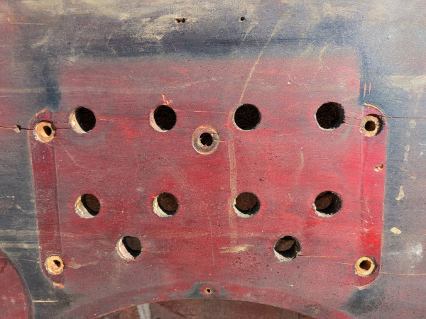

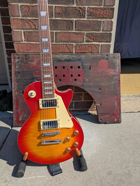

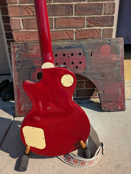

For those that have never seen what the original Ford stain looked like, here is a closeup of the area behind the coil box on the 1914 firewall that I am replacing. Also shown is the red cherry stain from the replica 1959 Les Paul guitar with the flaming cherry paint that I built two years ago. It is a transparent stain that actually matches surprisingly well! :lol:

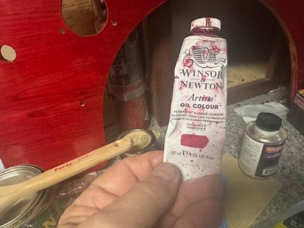

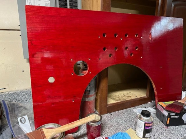

This is a stain made by using one part Windsor & Newton artist oil color and 20 parts mineral spirits. I am just finishing my 1914 firewall and used it on my 1911 seven years ago and it still looks great. It took three coats of stain to get the color I wanted followed by three coats of spar varnish. It takes several days for each coat of the stain to dry or else the next coat thins the previous coat. Art
