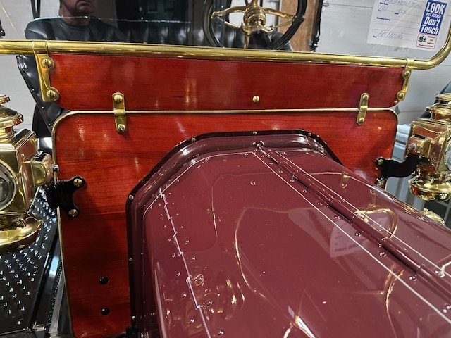

Last September I asked for some suggestions for cherry stain for the firewall, since Laurel Mountain Forge stain was not available at that time, and when it would be available again also unknown. Last week I checked another muzzle loading supply house and the situation has not changed, so it was time to go with my plan B.
Rich Bingham mentioned an old HCCA article that provided the stain "recipe" that included using Alizarin Crimson artist paint, combined with linseed oil and turpentine. I got some artist grade Alizarin Crimson from Michaels, but was not going to go the linseed route. Here are the steps that I used, and a picture of the result.
1) I used the old firewall as a drill template for the holes needed for the side lamps, windshield brackets, and attach points to the body. The firewall does come drilled for the chassis brackets. This way any splintering would not happen in the finished firewall.
I also added the slot cut in the hole for the steering column. I noticed that this was done on the firewall that I removed, and after some research found out that Ford did this on the 1913 and 1914 firewalls. It is nice to have that because I did used the slot when removing the column and did not drill out the rivets for the little arm for the timer rod.
2) I mixed 1/2 a tube of the paint with 4 ounces of mineral spirits and used it as a "stain". It soaked into the new firewall from Snyders reasonably well, but not as well as the Laurel Mountain Forge stain that I used on our 1911 firewall. I repeated the process until the mixture was out.
3) I mixed the last 1/2 of the tube of paint with 4 ounces of Minwax "tung oil". This product is a mixture of tung oil and varnish that appears to be thinned some. I followed the Minwax instructions of brushing it on, waiting 5 minutes, and wiping the excess off. After drying for about 24 hours between coats, I repeated this process until the mixture was out and then did one last application of Minwax without paint. The successive coats of this "wiping finish" approach results in a very nice finish that does not have runs, bits of debris, brush strokes or excessive gloss. It has the gloss and finish like a piece of furniture, which is what I like.
Here is a picture of the finished firewall. Overall I am happy with how it turned out, and it does match pretty well how red the 1914 and earlier Model T firewalls were.
