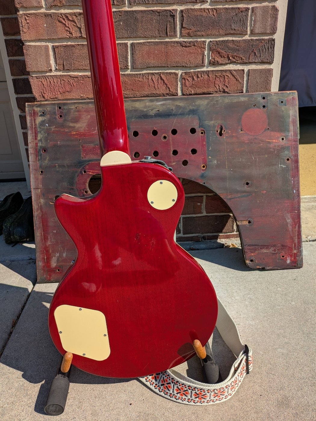

I am restoring a 1914 T that will be getting a new firewall. When I restored our 1911 Touring, I used Laurel Mountain Forge antique cherry stain, based on recommendations on the forum site. It really is a good match for the original stain Ford used, when comparing it to the portions of the firewall that had been hidden for over 100 years.
This weekend I looked to buy another bottle of LMF cherry stain, but the few online places that carried the stain show that it is out of stock. I have sent a message to LMF to see if or when it is still available, but in case it is not, does anyone have another stain recommendation? As can be seen in the picture pasted below, the stain is quite red, as the firewall is in the areas that had been hidden from view.

A restoration tip from the HCCA in the 1950s recommended making your own stain using artist’s oil paint. Alizarin Crimson tube paint diluted to a working consistency with a 50/50 mixture of spar varnish and boiled linseed oil. I used this mixture to “refresh” the failing dash on my ‘13 when I first got it, and the color on cherry wood is very acceptable.
One caveat, if you go this route, be sure you buy a professional grade of paint, full bodied pigment in linseed oil. Student grade colors are extended with fillers, and beware of “oil” paint that “cleans up with water”. Walnut oil or safflower oil yields weak paint films.
