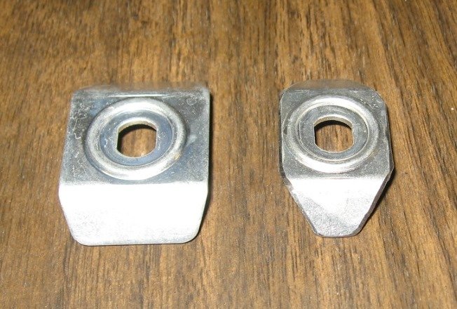

The current bridge washer offerings are not made correctly. They got the thickness and shape correct, but didn't do the stamping correctly. Why? There is a round stamping around the stem hole to help the bridge washer seat on the tube. Is there anyone anywhere, that is capable of doing this?

The Model A bridge washers available from the vendors have the proper stamping, but the wrong outer shape. They can be cut down and de-burred to match the shape of Model T bridge washers. Why a supplier can't do the last step to get the proper outer shape is a mystery.

It is not that they are reproducing the bridge washers wrong, it is that those bridge washers are made for modern truck tire inner tubes, not Model A's or Model T's. They may be similar, but they are not the same, and as people are finding, they do not fit the original clamp on style metal stems or tires.
