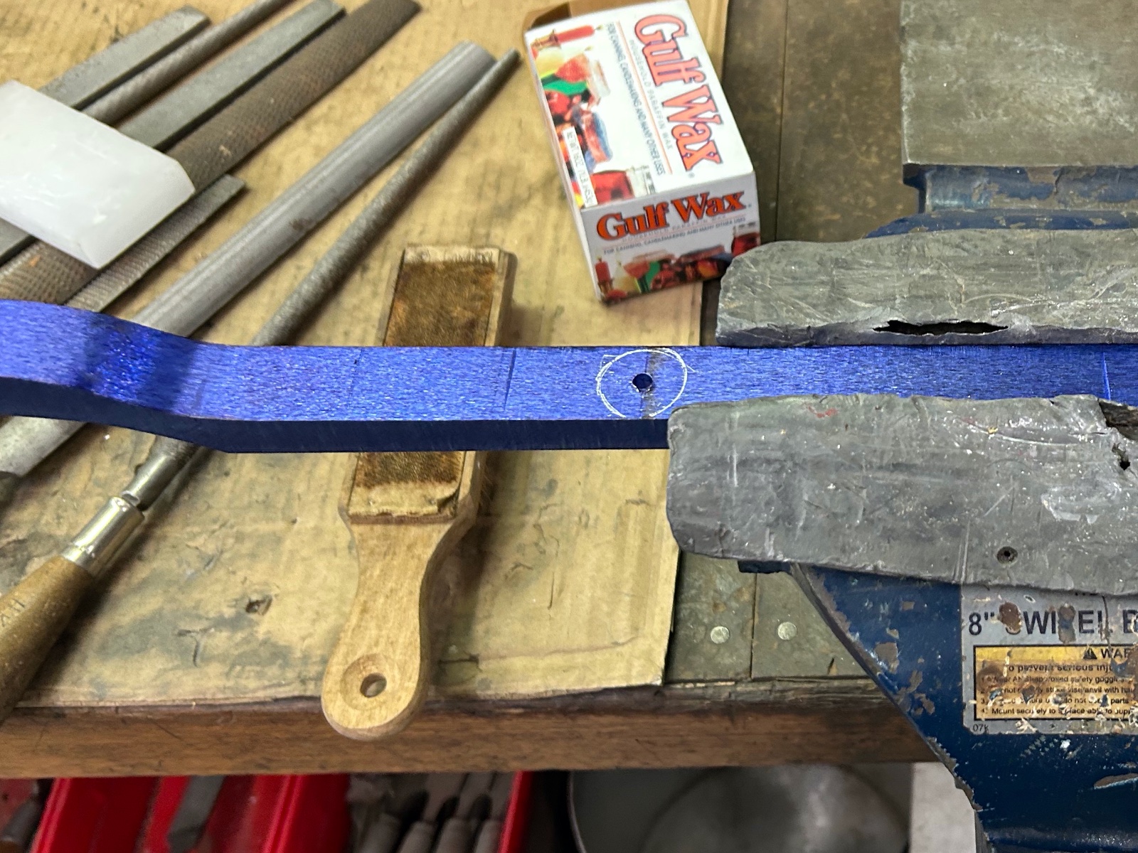

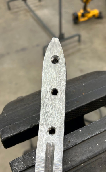

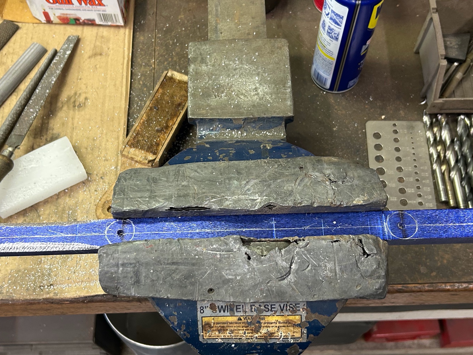

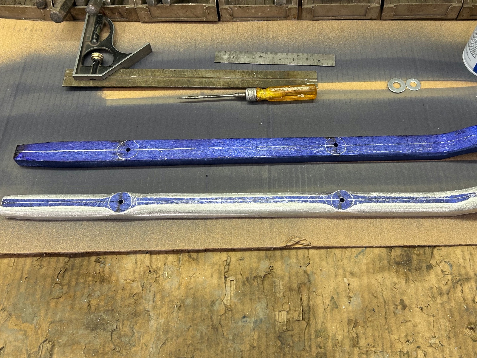

From years back.., keeping my word to assist in the parts that do not exist. Installing a Vega Steering Box, High angle wedge for the column drop, and custom billet aluminum windshield stanchions. Posting this to show others how to do it. The key in making these, you must use a variable speed metal capable band saw at half speed, canning wax as a lubricant, and patience.
Please Note: Not interested in doing more...., I am just keeping my word.

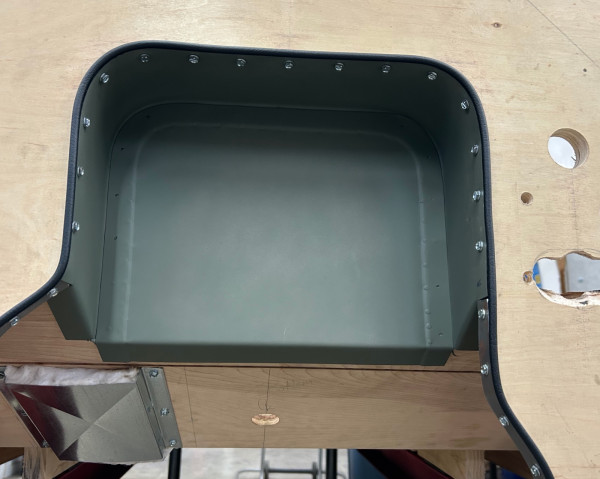

That is one of the most informative posts here and a long time not only did you show how but you included how and what you used to compete the project. I wonder where you found that cowl piece, did you make it or find a vendor. I have the same wood firewall and would like to add a form bent cowl as shown.

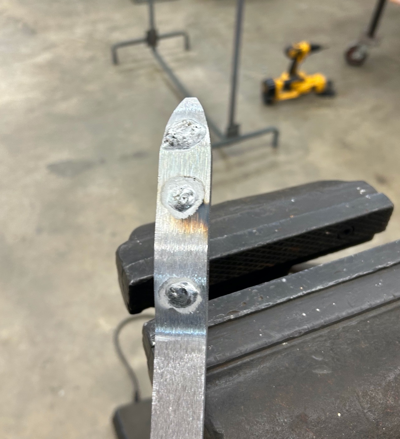

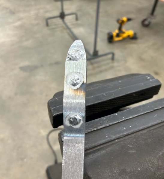

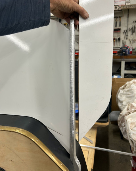

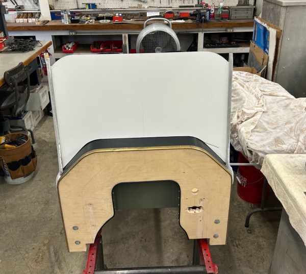

Well finally finished up the truing of the billet on a vertical belt sander using 40 grit. I drill completely thru the stanchions and then TIG up the holes for a full depth thread.., old school. Now making windshield/wind-wing templets and setting the style as we agree on the final design. Next will post pictures on how to carve the billet the easy way.
Stay tuned for more magic.

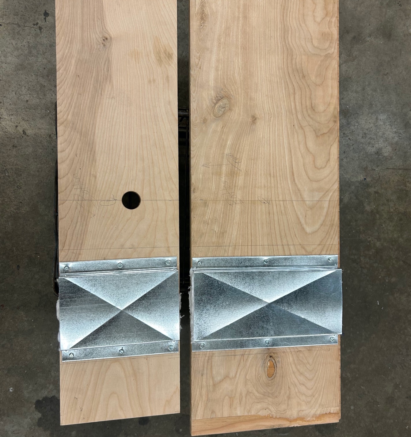

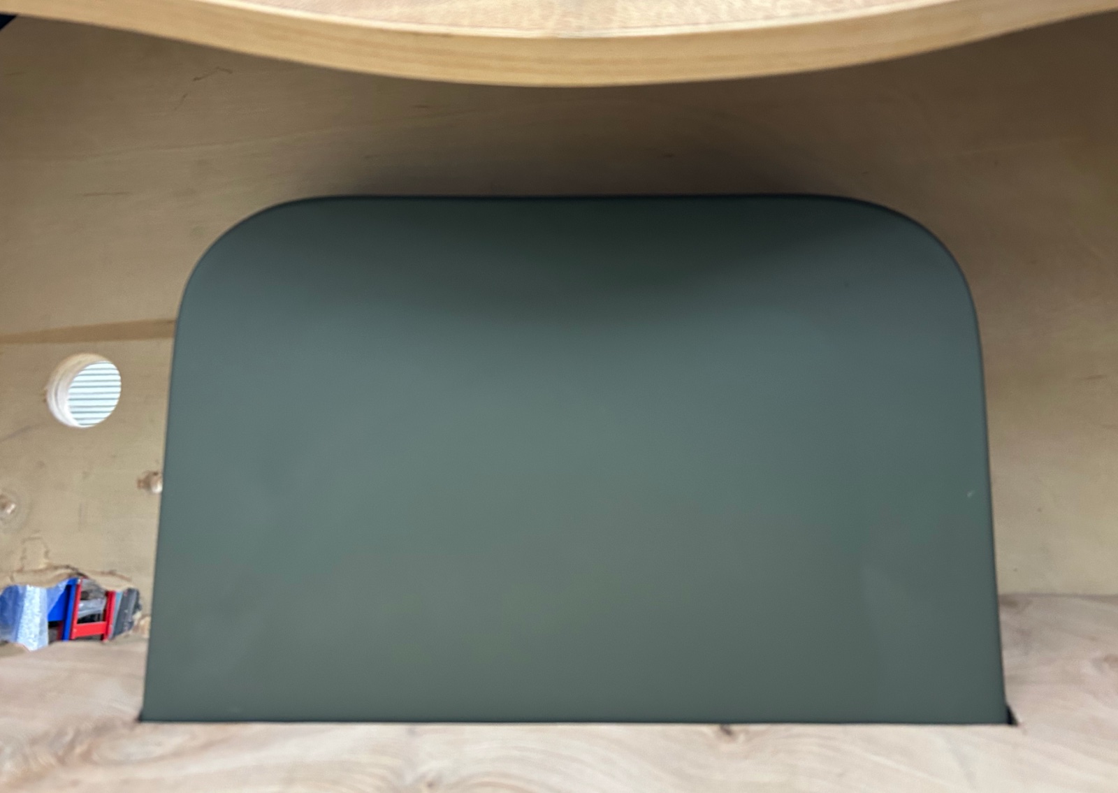

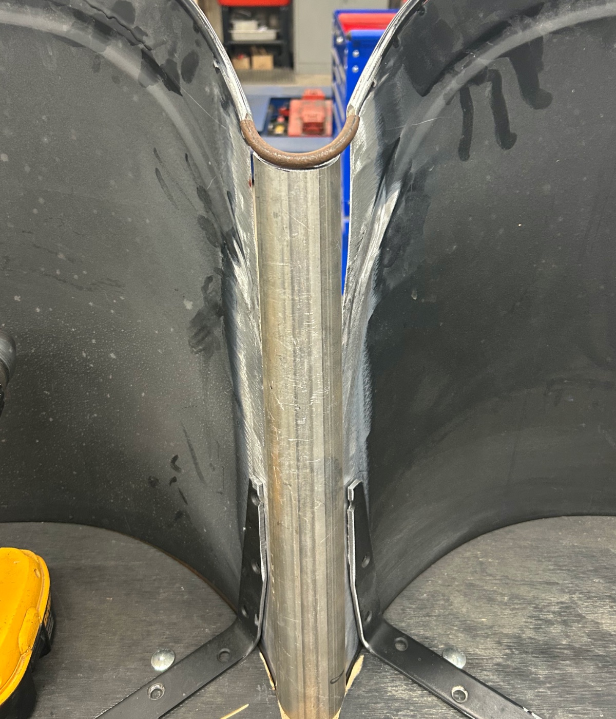

Some added items......,

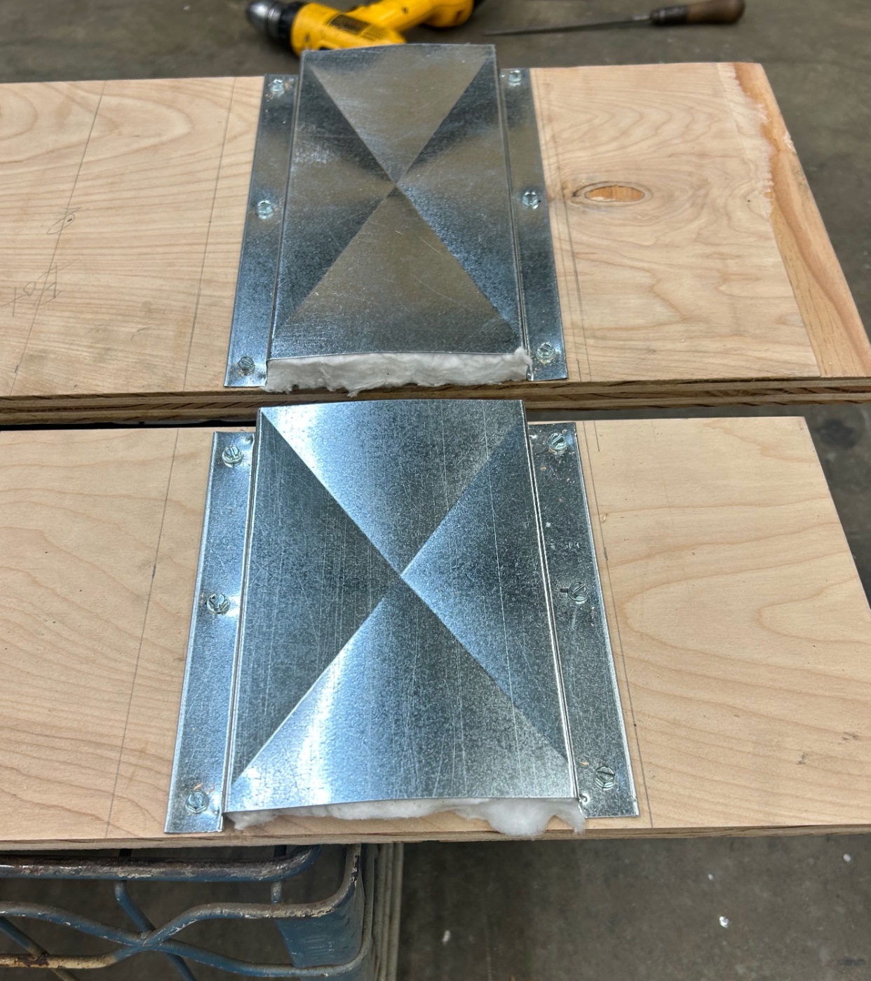

Firewall dishing for an overhead conversion! Lower floor board heat shields are a must!

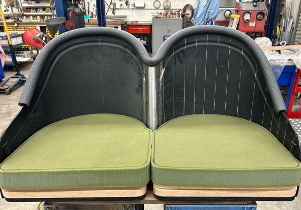

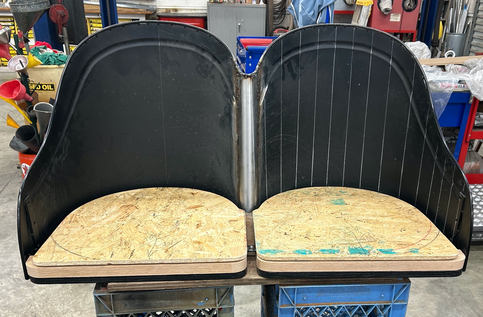

Post by Henry K. Lee » Tue Nov 04, 2025 5:33 pm
Bucket seats are nice but they do not meet the stature requirements for modern old aged folks...., converting to a love seat design!

Curiosity...
Is the aluminum piece on the cowl, tube or solid?
For the heat shields, did you use a bead roller or a press?
Is the seat center vertical piece aluminum or steel?

Re: Helping a Friend with a Promise
Post by Henry K. Lee » Tue Nov 04, 2025 7:26 pm
Billet T6061 aluminum (solid).
Galvanized sheetmetal formed on a box brake with 4,000 degree proof rock wool behind it.
Seat was supplied by customer (steel) just modifying for comfort.
