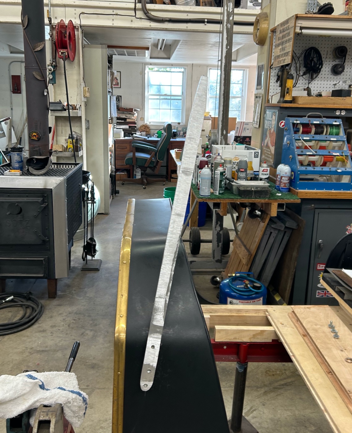

From years back.., keeping my word to assist in the parts that do not exist. Installing a Vega Steering Box, High angle wedge for the column drop, and custom billet aluminum windshield stanchions. Posting this to show others how to do it. The key in making these, you must use a variable speed metal capable band saw at half speed, canning wax as a lubricant, and patience.
Please Note: Not interested in doing more...., I am just keeping my word.

It will have wing wings as well.
Will provide more as this project progresses.

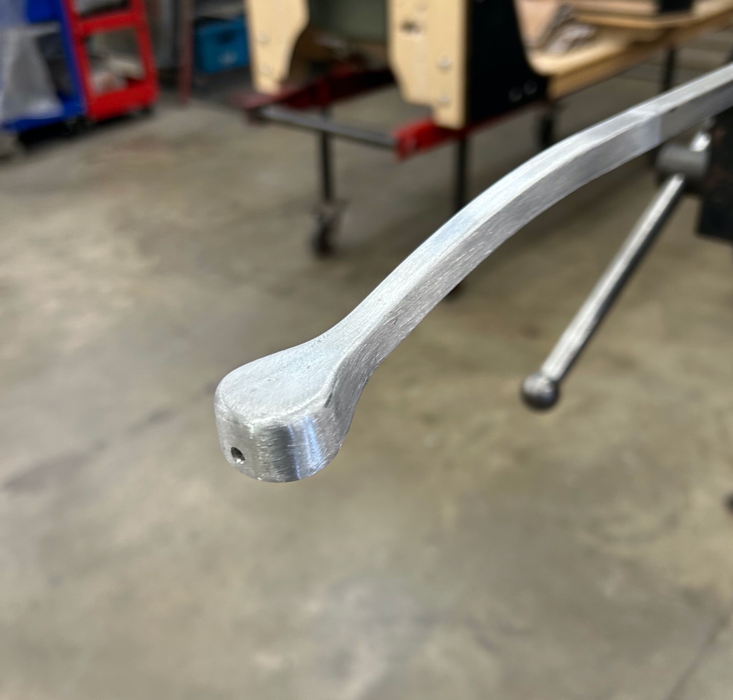

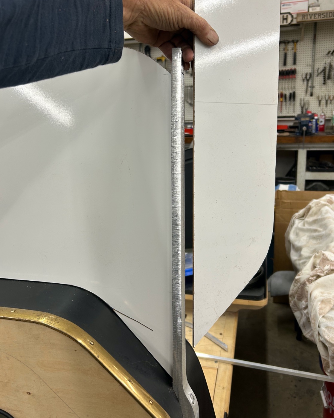

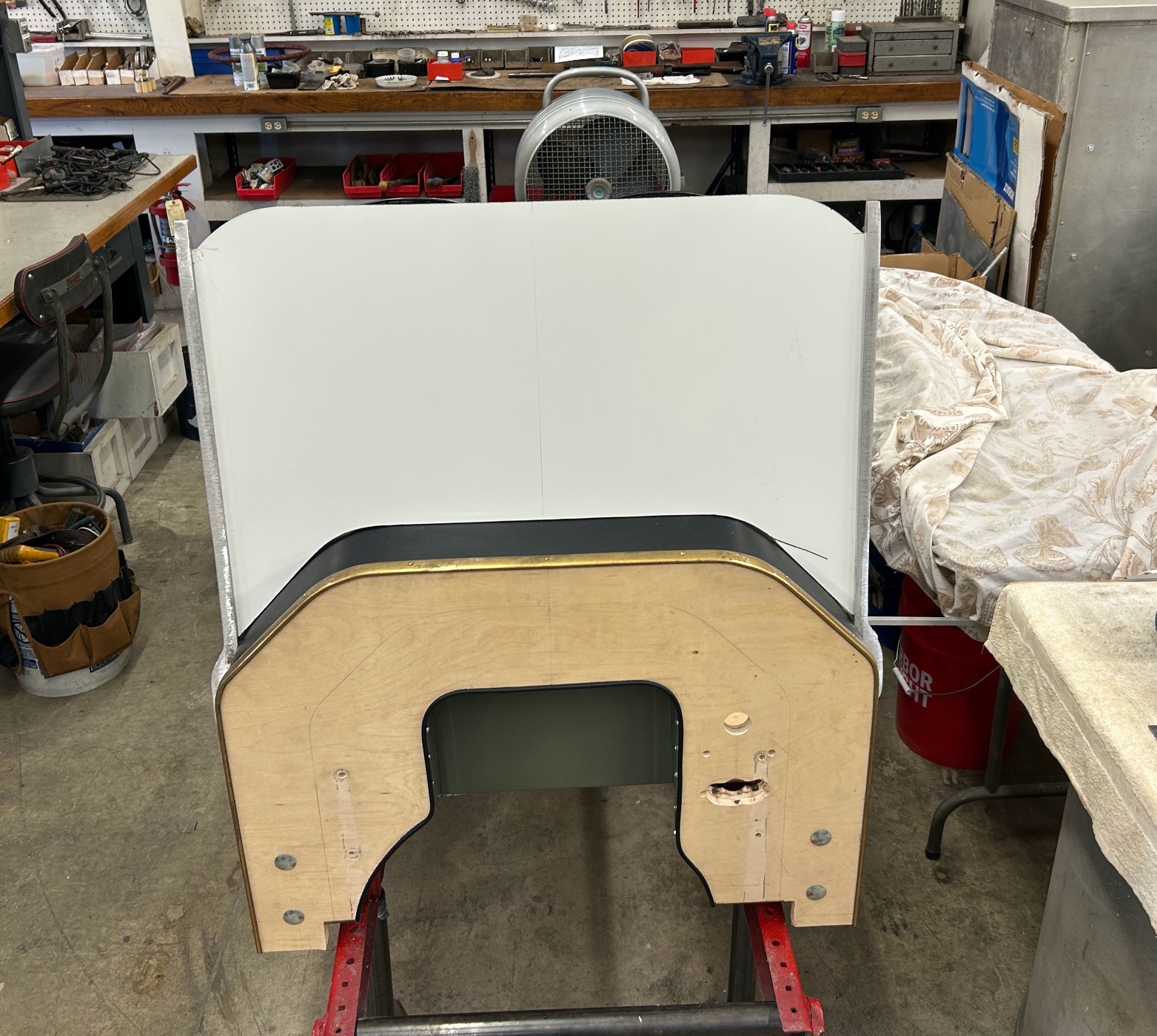

Well finally finished up the truing of the billet on a vertical belt sander using 40 grit. I drill completely thru the stanchions and then TIG up the holes for a full depth thread.., old school. Now making windshield/wind-wing templets and setting the style as we agree on the final design. Next will post pictures on how to carve the billet the easy way.
Stay tuned for more magic.

Some added items......,
Firewall dishing for an overhead conversion! Lower floor board heat shields are a must!

The key in a good job is quality material, T6061 billet, good files and rasp. When ever you are working any soft material use canners wax by means of rubbing your file. They never plug and clean up easy. Watch your pressure when cutting on the strokes. I use lay out dye for a good contrast.

I have been using the same files for over 12 years. After 2 cups of coffee this morning.., one is in the rough.

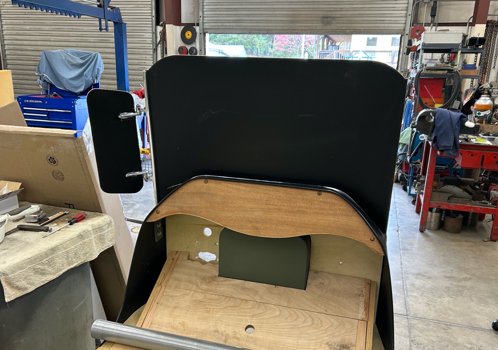

Well both frames are in shape today. Did some shopping for peep mirror mounts and they all look like flimsy crap...., Soooo I started making dagger style.
