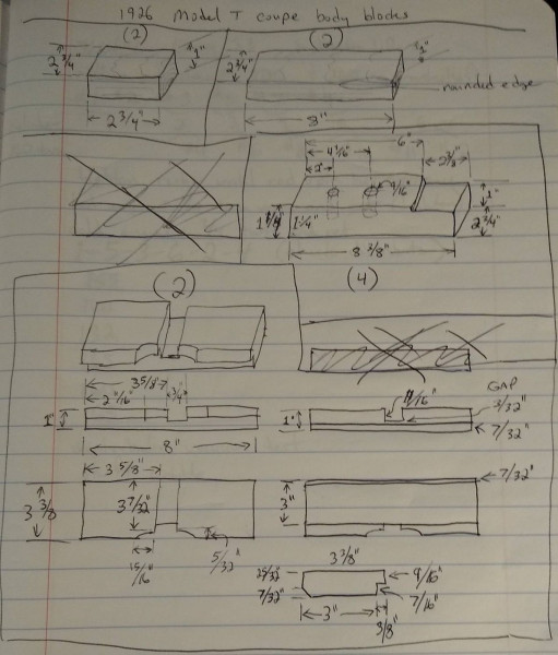

My 26 coupe is missing some of the wood body blocks and I wondered if anyone had the measurements for these that they could share.

Antique Auto Ranch has a page with dimensions for 26/27 body blocks.
Found in this previous post that has additional info.
https://mtfca.com/phpBB3/viewtopic.php?t=25552

I have dimensions, but I do not know if they are "correct".
Vern (Vieux Carre)

Type of wood for originals?

The surviving originals from my '26 were hard maple. jb
