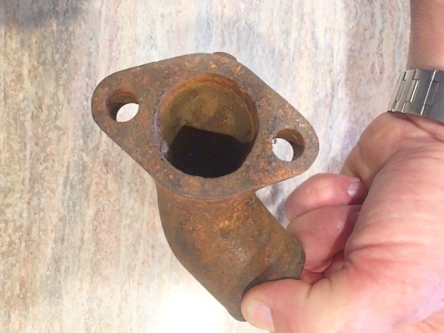

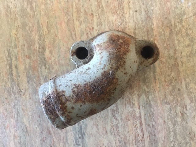

I was just searching through my spare parts for some needed bits and found this part.
Here is a normal water inlet I found:

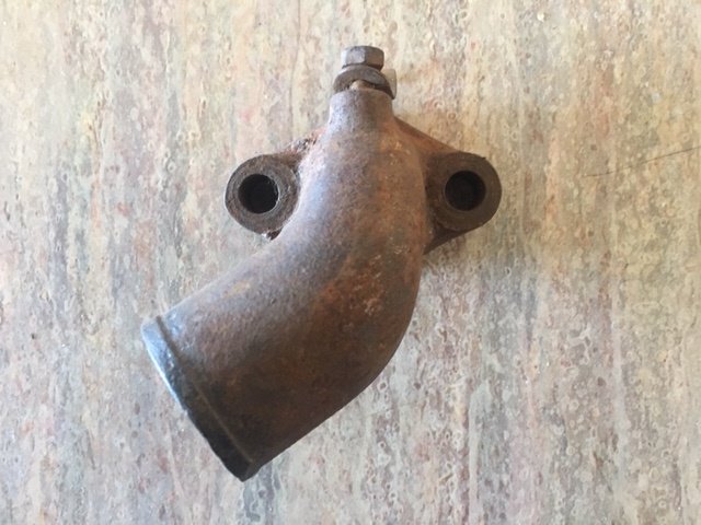

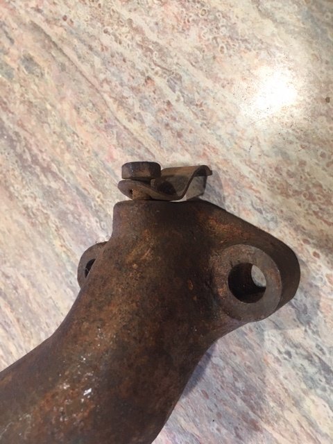

Here is the one I think is unusual.
It has a bump on the inside, the hole is not drilled through.
It has a bolt with what looks like a conduit clamp.
The only thing I can think of is a clamp for the horn wire, what's your guess? Have you ever seen one like this?

Re: What's this bolt for?
Model A's used a bolt there for the generator conduit. Could that be for a Model A?
Rich is right, Model A Ford.
Thanks, I thought I had some sort of rare, unusual aftermarket T part. Instead it is a relatively worthless part from a gooney little known car!
(tongue firmly in cheek)TH
