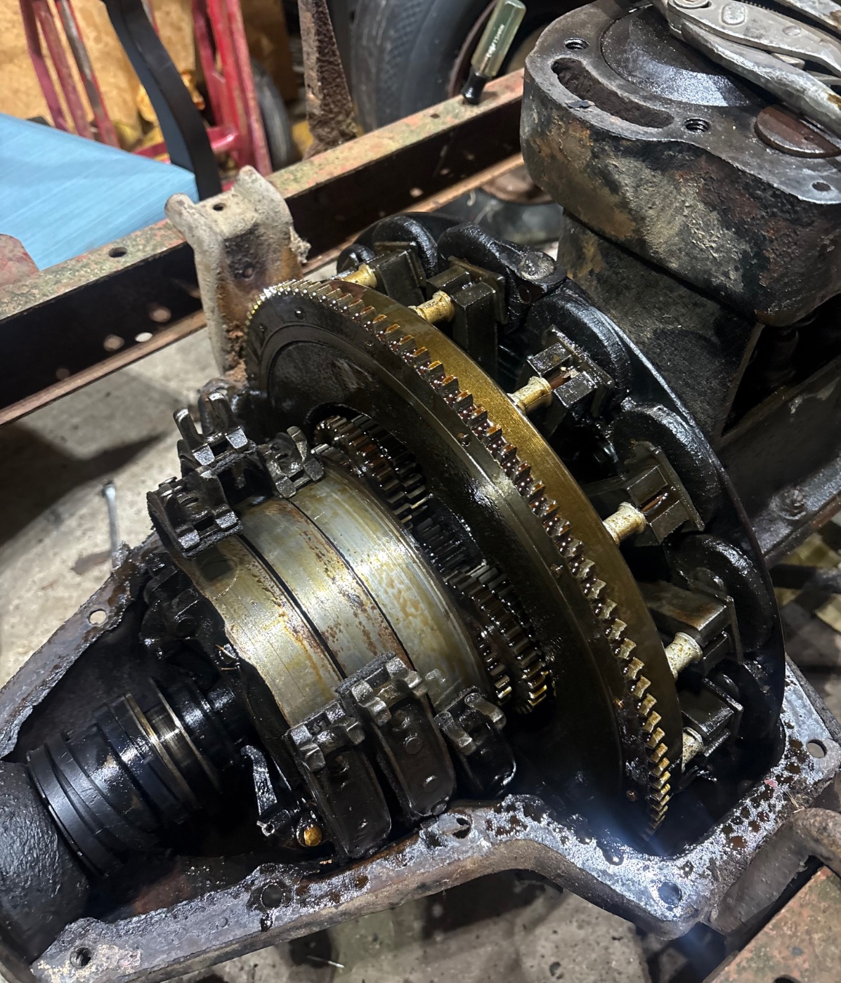

Another question for the team, when recharging the magnets on a magneto in the car, do you have to touch each magnet individually or just at the mag post? i’m working on a 1925. I have the hogs head off to inspect the coil rings. Everything looks good but the mags are weak. I was planning on doing the flash charge with a DC welder.
Thank you

I set the chassis east and west , used a compass to determine north and south . Ended up using the 3 battery set up to flash with the positive on the solder button and striking ground to the engine block , it worked somewhat , but the magnets aren’t as strong as I feel they should be , but they’re stronger than they were if that makes sense .

Very good advice !! I will definitely clean up the area before moving forward , I pulled this unit out of a barn quite a few years ago and am looking forward to getting it back together . They are the two piece valves , the whole thing needs cleaned up and out .

Tried the welder method @225 dc , flashed ground , no change , magnets will let the compass read north and south , but that’s all the magnetism I get ….

A socket to see if it sticks to the magnets , it does not . Magnets are very weak . Would rather not pull the flywheel and transmission assembly but I may have to.

OP shows his engine with the flywheel attached.Mike Silbert wrote: ↑Wed Jan 14, 2026 7:24 pmTo check for magneto ring coil shorts or opens:
1) Line up the magnets to the coils like you are charging it. Skip this if it is a loose ring coil bench test.
2) Hook up a 6V battery or 6V charger to the ring coil like you are charging the magnets. Don't leave it hooked up long as it will heat up parts.
3) Go around the the coils and see if a big wrench "sticks" to the coils.
Most importantly check the last one in line that is on the generator side of the engine next to the post.
I have seen ground shorts between and in the coils (taking some of the coils out), bad connections, bad ground rivets, and windings shorted between the layers before.
If you suspect there is a problem with the ring coil it is an easy test.
Mike
How can you test the field coils individual coil strength as you suggest in #3?
What am I missing? If you have a magic answer, I would add this to my diagnostic bag of tricks also.

The car in question has the hoggs head removed in a picture so you can actually get in there.
This test will not work with the hoggs head installed.
He says the magnets are weak and will barely hold anything, this test will not work very well on a fully charged set.

Ok , did mikes test with 6v charger , all reachable coils are magnetized when hooked to the charger , the first one left of the blob and the right one as well , I think I’m just going to put it all back together and start it up to see if it runs on mag .

Ok , today I am eating an entire humble pie !! I went out to the barn determined to find out what was wrong with my magneto and it turns out that I was the problem , my DC welder is not a DC welder , it’s an AC welder . So … re set up with the three battery set up again and recharged/flashed the Magnets , now I have decent magnetic pull. hooked up a 6v lamp to the blob and turned the engine over by hand , bulb lights up as it should , gets brighter the faster I pull … thanks for everybodies help and suggestions . Guess I need to start by paying more attention to the facts and maybe get my eyes checked , because I was sure that damned “A” was a “D” , thanks again for your time and effort/support.
This pie tastes good though , and I’m sure I’m not the only one who has ever tasted it !!

I am sure we have all been there before, I know I have.
At least your pie tastes good and it will be back on the road soon!
After many years of field service and lab repair work you learn that sometimes the issue is the thing you believe to be correct.
When things go wrong and don't make sense, step back and go over everything.
I have returned to the beginning and tried to reproduce the problem many times.
Sometimes you fixed the problem and did not know it.
Humble pie, Eating crow, Egg on your face, Can't See the forest for the trees, If it was a snake it would have bit you, or just plain a mistake, it happens sometimes.
Now you have a good story and will never forget this.

Congratulations Travis, I’m thankful that I am not the only one that sometimes misses the forest for the trees, been there many times. A great asset to do the recharge in the car is an electric golf cart. They are usually 48 volts but can be jumped to provide 8 volt increments which is handy. You can drive them to the site, batteries are designed for heavy load, and are easy to recharge. Visit when you can.

Golf cart is a good idea. I think batteries would be the best source of a heavy jolt of pure DC current. If you use car batteries in a series hook up, be sure ALL of them are in good condition and fully charged.

Congratulations.
I figured you were using an ac welder.
The big clue was 225 . Thats the common lincon arc welder.
Been there done that once also.
