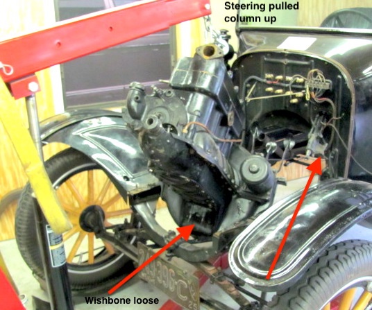

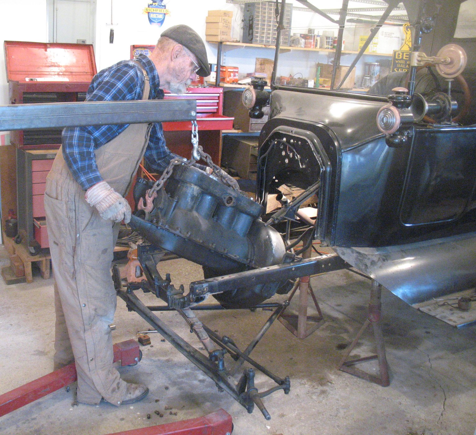

Would agree likely a magnet keeper made of steel with thin sharp edge slipped away and tore that narrow gash. Esp. since bent edge of pan was forced outward.
More simple and direct way, can't really do short cuts is to remove the Ford powerplant as the engine was named in the day. The pan is the foundation, and all of the short block and trans cover have to be removed to fix the pan.
One man job with the tools, a cherry picker, lift eyes, and follow instructions in Ford Service Manual. Remove all wires and attachments (exhaust, fuel line, or manifolds, plugs, wiring ) to the engine, unbolt steering column bracket at frame and dash, push up out of the way. Detach universal , remove engine to frame bolts (pair each side), detach wishbone at base of pan, remove front spring / pan cap which releases front of motor.

The oil pan on the T is also the engine mounts, half the transmission case, frame cross member, and front and rear axle attachment point. You cannot "drop the pan" as with most other vehicles.
It might be possible to remove the hogshead and fish out whatever loose part or parts that damaged the pan, and determine if the offending object (s) can be replaced without further disassembly. A number of people have managed to retrieve small parts, or fragments of parts, that have found their way into the bottom of the pan, and posted information on how they did it by using rags, magnets, chewing gum, compressed air, or whatever. It would be important to account for ALL loose items, and do a proper job of replacing them and assessing any additional damage that may have occurred. IF you can account for ALL loose items, and repair any possible internal damage or missing items without further disassembly, it should be possible to solder the cut in the pan without pulling the engine.

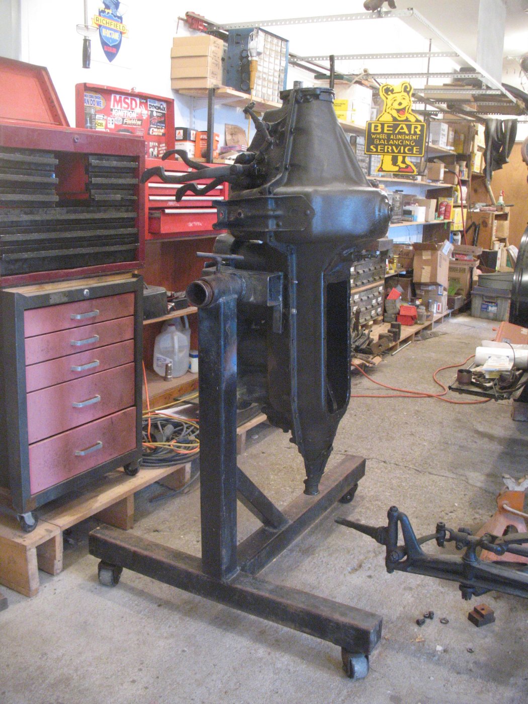

IMHO, I would not bother taking the HH off first.
Something flung. Surprising you didnt hear the BANG. Even if its a lone magnet keeper, the transmission has to be removed for access around the field coil. Not to mention the carnage to the field coil & a careful check of ALL the other magnet keepers & magnets.
Yes, the motor is lighter, but, you would certainly reassemble the motor completely on your engine stand & re-install with the HH properly fitted with the 4th main & sealed in place. The power plant goes back in as a COMPLETE unit.
See the picture Dan T provided.

Pulling the engine is not too difficult, if the parts are clean and the proper procedure is followed. However, taking the engine and transmission apart is best done with a proper stand to mount it on, and reassembly has several critical steps. I'd want to avoid that if possible. Some things don't seem to add up to me, particularly the lack of noises and lack of a MASSIVE oil leak.
