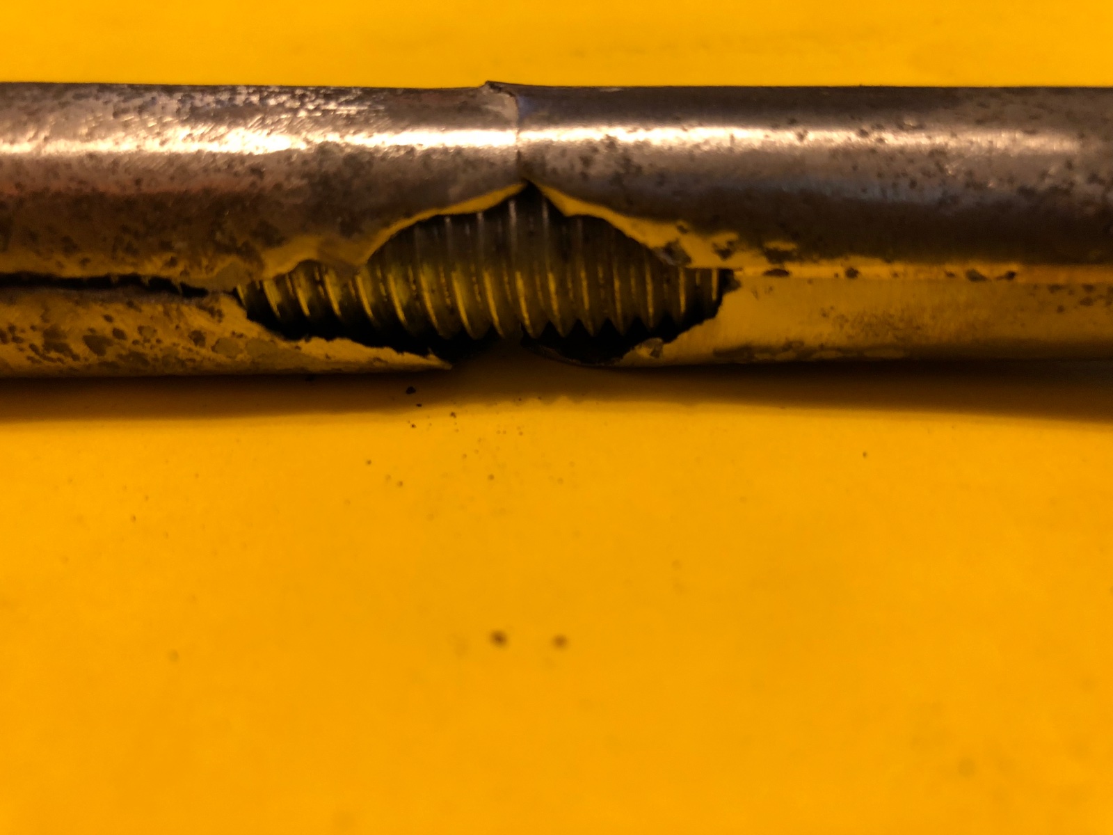

JRSpada4
- Posts: 99
- Joined: Sun Jan 20, 2019 12:39 pm
- First Name: Jim
- Last Name: Spadafore
- * REQUIRED* Type and Year of Model Ts owned: 1925 Touring
- Location: Fairmont,WV
Re: How to repair this
I repaired one and the same spot by putting a piece of all-thread inside it and welding it back together. The all-thread core gives it support and something for the wire to bite to. Mine was also missing metal. The previous owner had “fixed” it by filling it with body filler. Once you clean it up with a grinder and some sandpaper, the repair disappears.
