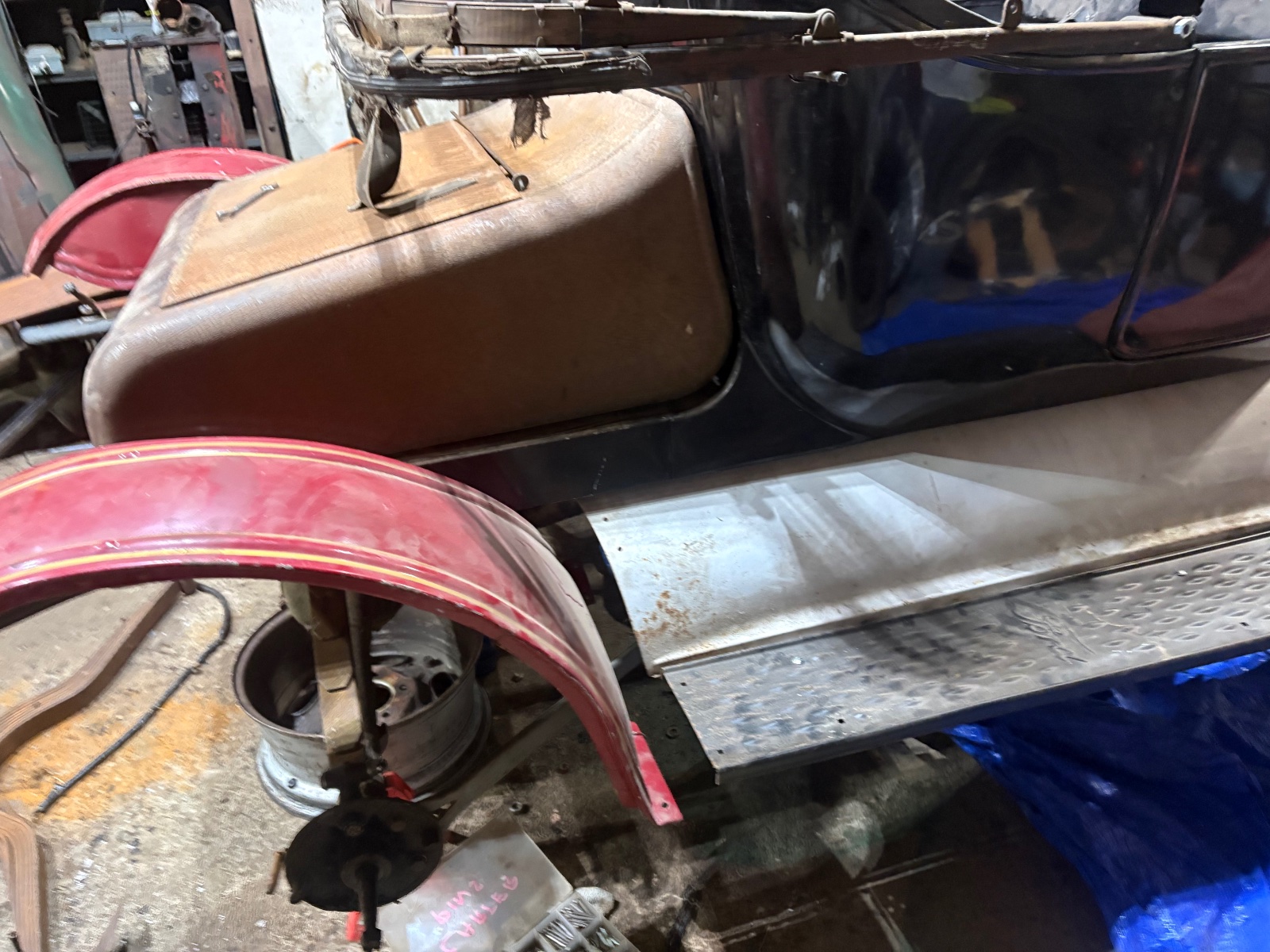

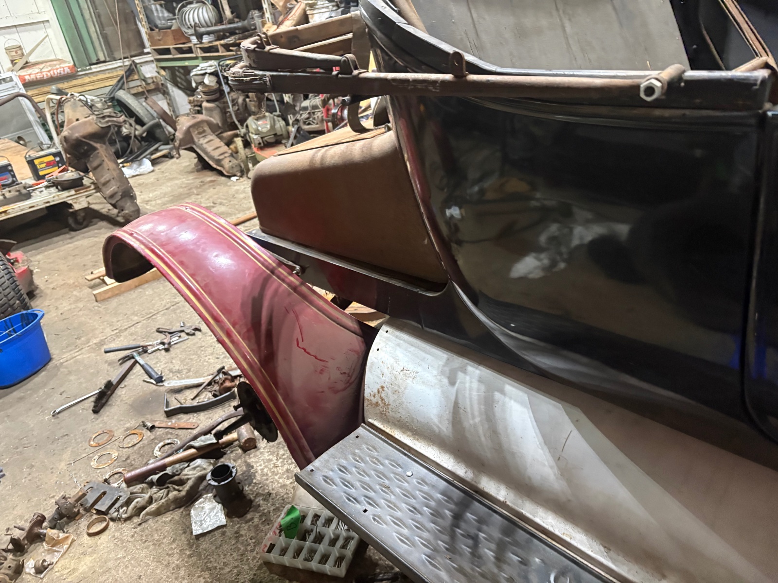

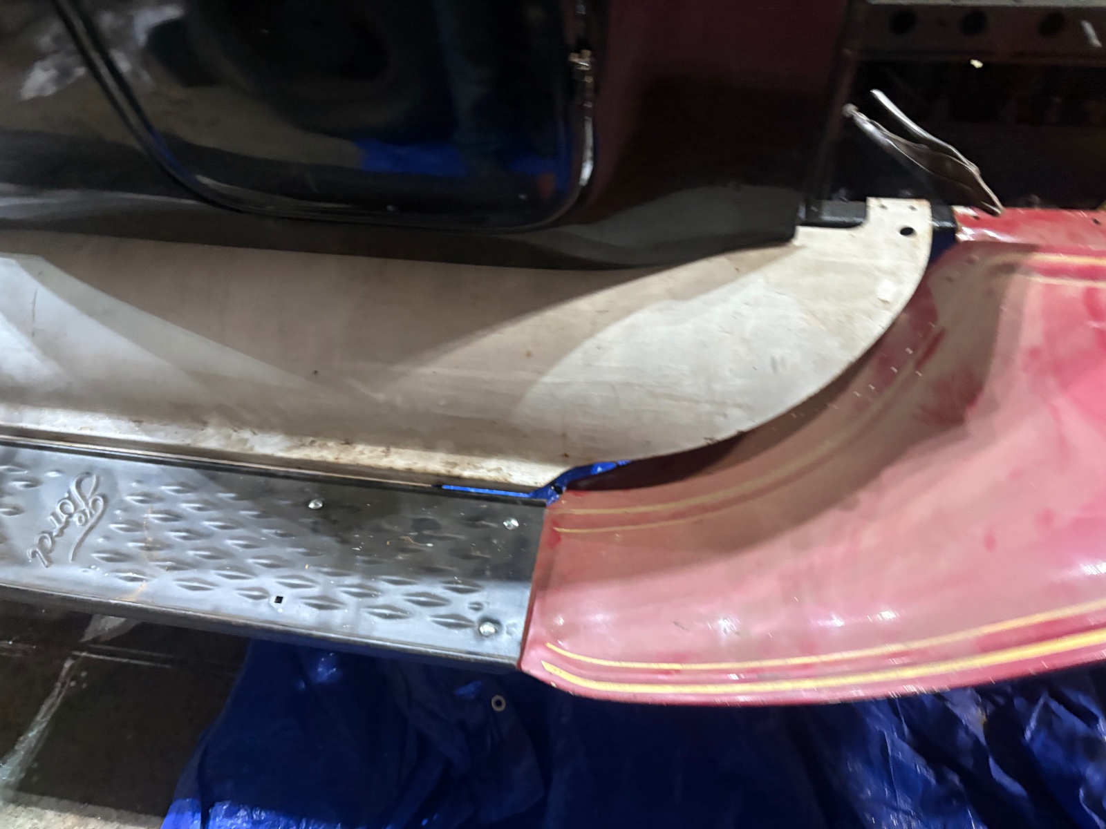

Good morning , another question , when bolting the fenders to the running boards , do the ends bolt directly to the boards or is there supposed to be blocks between them , this is my first pre 26/27 car so….
Thanks in advance .

Blocks between the fenders and running boards on "black" T's (1920-1925 range) is a mildly debated point due to conflicting data.
The general consensus is if the car says it needs blocks or spacers then use them, if the car says they are not needed then don't install them.
This is still the era when many people were making the bodies and fenders and then we add replacement metal to the mix and get a mixed up mess.
My advise, do what you need to to make it look good and "right"
See
https://www.mtfca.com/discus/messages/1 ... 1303397926
https://www.mtfca.com/discus/messages/3 ... 1364837847
https://www.mtfca.com/discus/messages/2 ... 1170435525
Mike

In 1925, the period fenders would have had raised embossments around the 2 holes that attach to the running board. It was intended to have a washer placed between the bottom of the running board and the top of that embossment. I honestly do not recall if those embossments were to eliminate the washer, or be in addition to the washer but for my assembly, placing a washer there was surprisingly just the ticket for final successful attachment of things. You wouldn't think such a small additional thickness would make much difference but it did for my project. As far as a block of wood being there, by '25 with the inclusion of the raised bosses around the fender holes, those blocks had been designed out of the assembly.
With respect to the wood between the running board braces and the underside of the running board, I rely less on the "correct" thickness of wood, and rely on the angle/height of the running board brace-to-running board to determine what belongs there. I find that no matter how precise you are in bending/prepping those braces, once it comes to getting fender/running board/dust shield all lined up, THEN you can do the final fit of the running board blocks (sometimes they require a slight taper or different thickness' to let the running board fit to all elements AND sit parallel to the ground.
I personally despise this type of work and the last time I did it, I was fitting new dust shields to a car - the reproductions were gorgeous and did not appear to vary in the slightest from the rotted originals. Despite this, it took me 2+ looooong days of frustration and no small amount of moving holes and tweaking the shields to make them fit the front fender correctly as well as getting fenders to align squarely without putting anything under strain.
