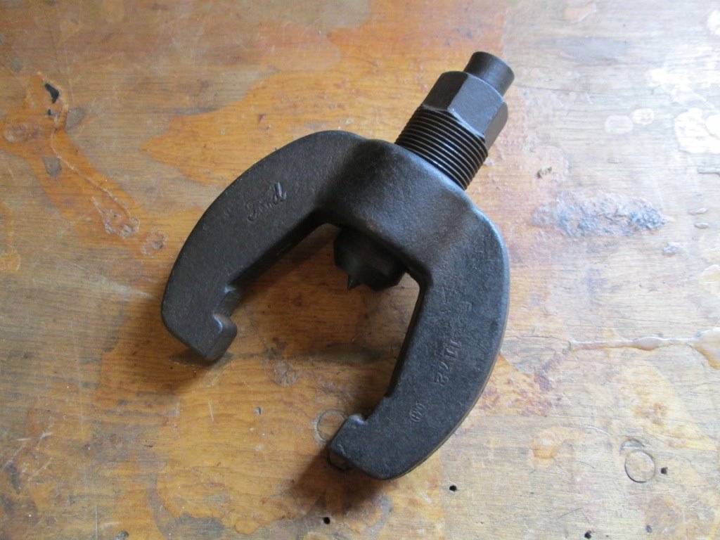

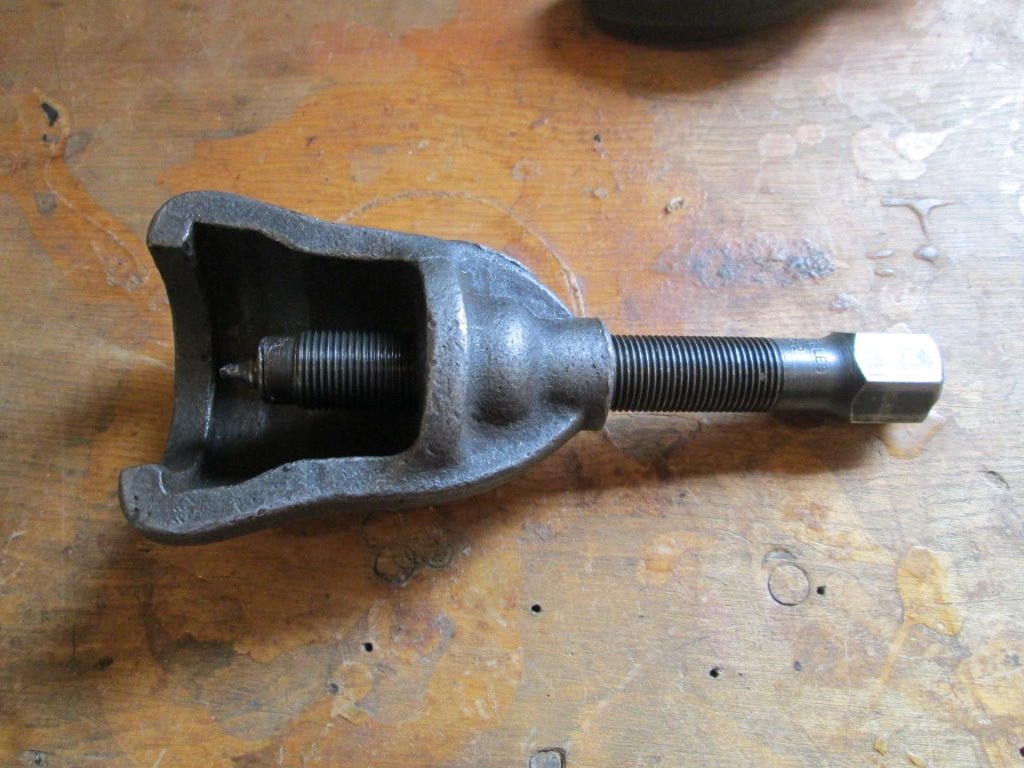

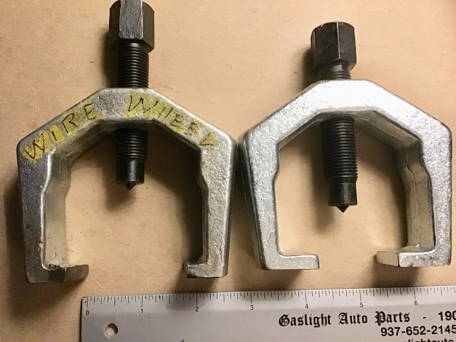

Post by RajoRacer » Wed Jul 10, 2019 8:14 pm
Here's what the original Ford puller looks like and a well built accessory one.
