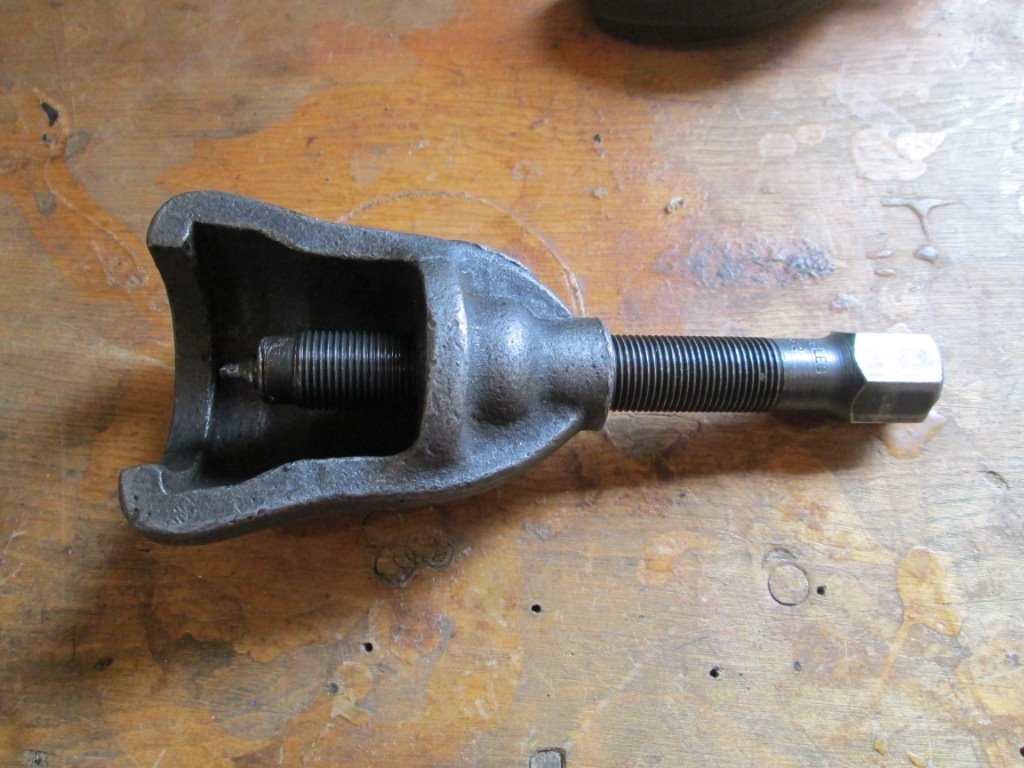

Will this hub puller work?
Post by paddy1998 » Wed Jul 10, 2019 2:56 pm
Getting ready to install the disc brake kit and I need to pull the rear hubs (large drum, wire wheel).
Will this puller work? https://www.amazon.com/TruePower-20-2029-Universal-Hub-Puller/dp/B012P0QV5K/ref=pd_lpo_sbs_263_img_2?_encoding=UTF8&psc=1&refRID=57PZC6VNA3WJ1RMZRP3E

No that puller will not work, there is a Model T rear wheel puller available at most vendors.
Posts: 5263
Re: Will this hub puller work?
Post by RajoRacer » Wed Jul 10, 2019 3:38 pm
You need a special puller that was specifically used on wire wheel rear hubs - Snyder's has a Model A puller that might suffice.

Purchased this fairly strong steel forged Pitman Arm puller at auto parts store, ground the opening a bit more wider, to fit hub groove, 1 3/4" wide.
Slips right on and gives good pulling power....smack that thick bolt head with a sharp whack of heavy hammer, off comes the hub ;)
Posts: 5263
Post by RajoRacer » Wed Jul 10, 2019 8:14 pm
Here's what the original Ford puller looks like and a well built accessory one.

Just to wrap things up, the puller I ordered arrived and I greased it up and used it.
I engaged the parking brake, pulled the pin, ran off the wheel nut and fastened the puller to the hub.
Then I released the parking brake and began to torque down the puller. Strangely I was not getting any resistance.
I grabbed the puller with both hands to make sure it was snugged down on the hub and just pulled the hub/drum/puller right off (and nearly smashed my toes!)
So now there's that . . .
Posts: 5403
Last Name: Gregush
Location: Portland Or
Post by Mark Gregush » Sat Jul 13, 2019 7:16 pm
It's a pain, but after you put the hub back on, retorque it a couple of times after driving so it is tight. Unlike what you found out when you pulled yours off. Besure to check the keyways. 100-120 fp is good. I start at 90 and turn to next cotter pin hole. If it needs more then the high number to reach a slot for the cotter pin, try a different nut or file a small amount of back of nut keeping it level as you do so.
