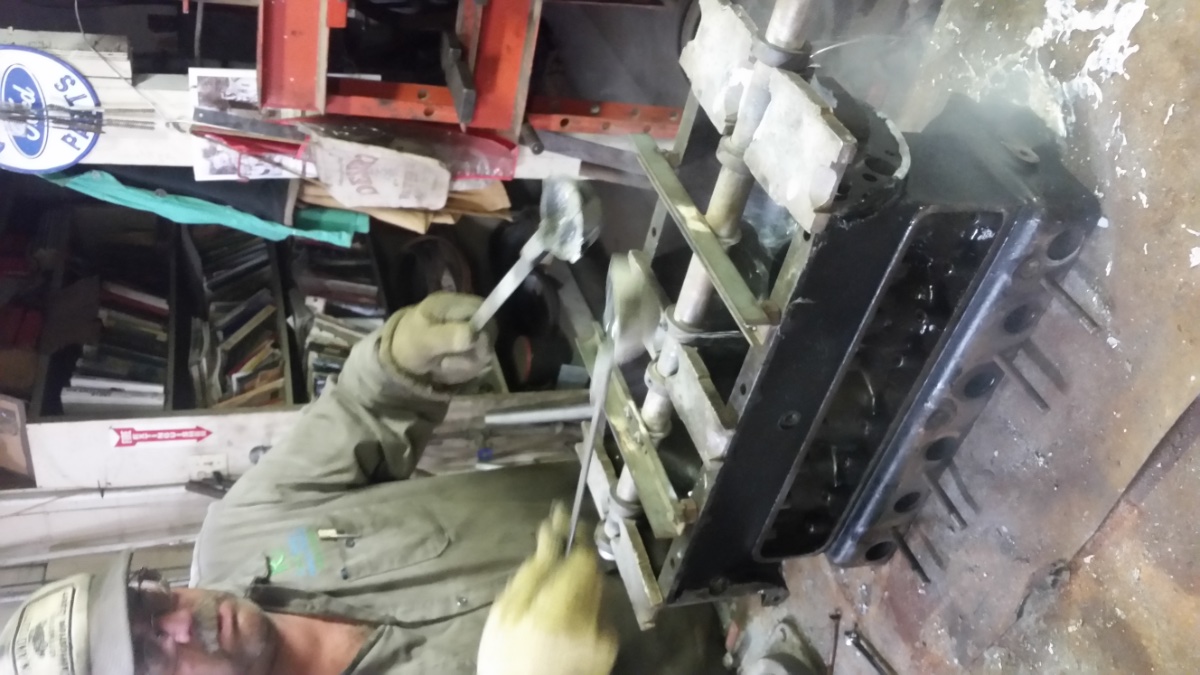

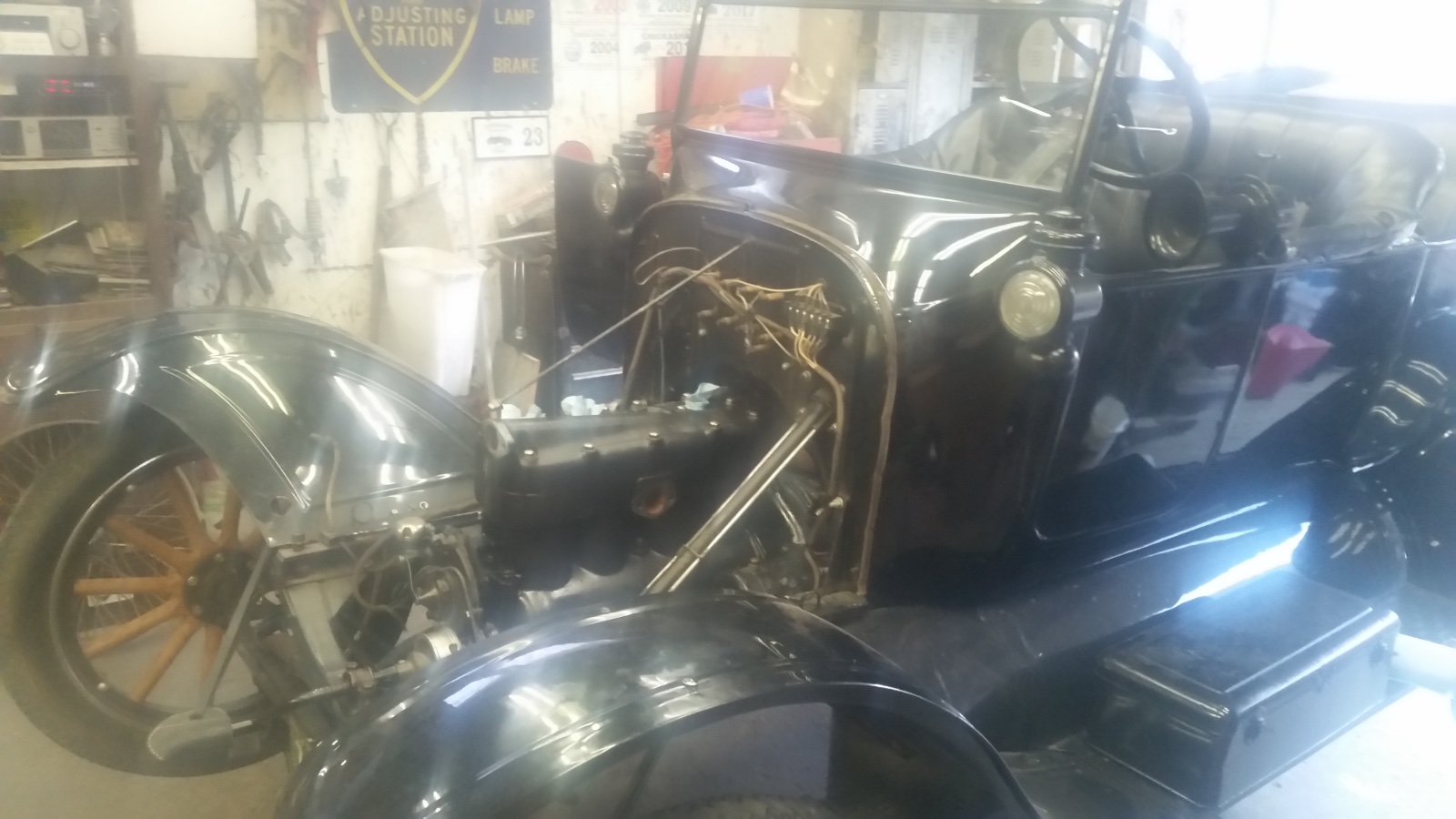

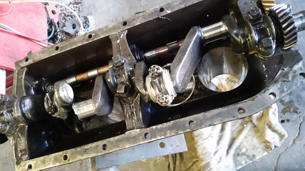

At one o’clock today I arrived at Erik Barrett’s Rumble Seat Garage in Auburn, CA. towing my father’s and my 1924 Touring with a broken crankshaft. Under the watchful eye of his 85 year old father and two dogs we, in just over an hour, had the engine out and Erik and his cohort Robert were tearing it down to just the bare block. By 4 o’clock Erik was torching out the babbitts while Robert prepared refurbished connecting rods and piston assemblies. At 5 o’clock we were pouring 900 degree molten metal in to the new babbitt jig. At 6 o’clock Erik was milling them to aerospace smoothness. And, at 8 o’clock we were drinking beer and eating pizza on the apron outside his roll-up door.
This was an amazing day. The Rumble Seat Garage has every tool, machine, and jig imaginable and some that I had never imagined. Erik has dozens of magna fluxed crankshafts hanging in factory style bags from the rafters and a warehouse of segregated piles and shelves full of Model T parts enough to build a parade of cars. It's a well oiled machine. I was honored to be witness to how this family of professionals so passionately approaches their craft.
Tomorrow morning we will be back, elbow deep, into it again milling the ends of one of the babbitts so that the new crankshaft will be positioned properly front to back, (thrust). Then we'll load all the engine parts etc into his fancy parts washer, paint those that should be painted, and begin putting the car back together. We have been at it 7 hours now and the end is already in sight. I will post more about that tomorrow so please stand by.

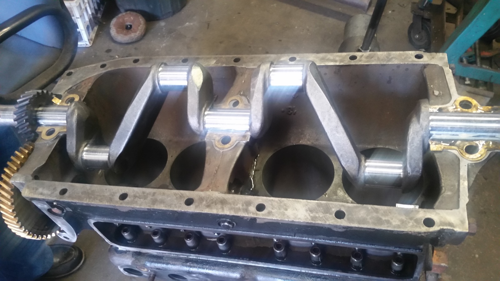

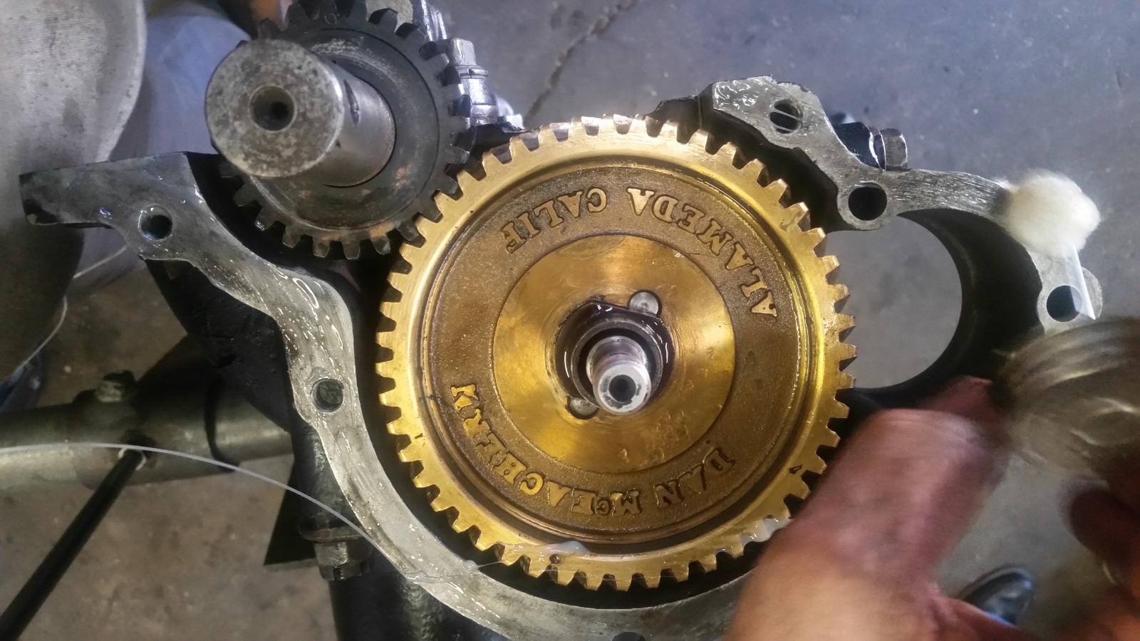

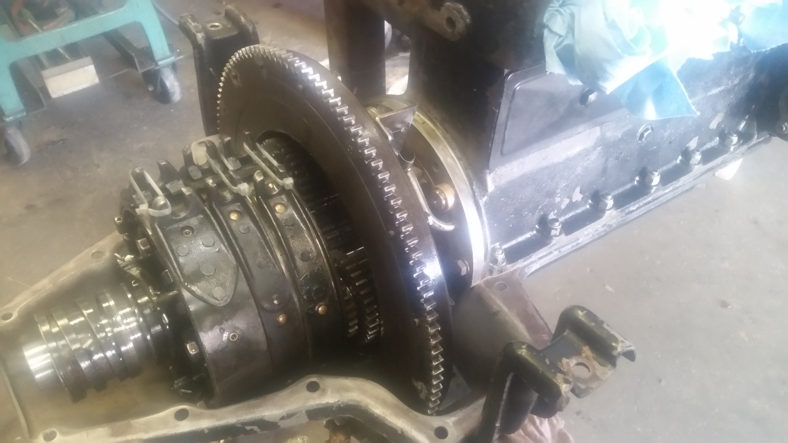

Day 2 of this crankshaft replacement went as well as the first. Erik set the thrust on his lathe and squared the butt of the crankshaft. He, Robert, and I put the engine back together with Erik constantly checking and adjusting tolerances to the micron. The engine is now back in the car with the transmission bands, wishbone, starter, generator, manifold and exhaust, timer, oil circulator, and headlights all squared away. We will start again tomorrow at 9:AM with the goal of having the car "tour ready" by noon, 47 hours after we started. Stay tuned. I will let you all know how that goes.

In answer to your question, you can see where the crankshaft broke in the first day's pgotographs up near the start of this thread. There's was no bent pan. Although, Erik has a massive solid steel block of a jig to straighten any pan back to factory specifications. Also, no damage whatsoever to the block. Erik tells me, "if you're going to break a crankshaft this is the best way to have it happen".
So, this is a roundabout way for me to tell you that we don't know why this Ford T crankshaft broke. The Amazing story here, however, is how it got replaced. I haven't had this rewarding of an experience in a "Rumble Seat" since my high school prom.

Arrived in Auburn, CA. with a two-piece crankshaft at 1:PM, Friday, July 5th.
Fired the car up at 12:45 PM today, Sunday, July 7th and drove it to the Auburn Valley County Club for brunch and full body massages with the mechanics. Praise be to Erik, dad, Robert, and the Rumble Seat Garage.

Well, it was quite a weekend. I had an ideal combination of parts, equipment, and people helping to make the project a success. Steven and my model T partner and best pal Robert Weitzel were troopers on this job.
This is a car I got from the estate of a local club member. I did not build the engine other than looking it over and putting in a Stipe cam and a few other goodies. It came time to find a new steward for it and I found the Chase family at Bakersfield. A few months later Steven joined the infamous two piece crankshaft club. Many here will recall the thread about that. So at this point there was only one appropriate course of action, and that was to return the car to tour ready condition as I promised it to be. In so doing now I have not a customer but a new friend, having spent the weekend fixing the car and making plans to enjoy model T’s together. We are taking it to two car shows and a club tour next weekend. This is good stuff.

I stopped by to consult with Erik today and met Stephen. He’s a great guy, even jumped in to help with my engine.
The bad news is my engine will cost more to refresh than to replace. I have a new gear on my Stipe 250 cam, one I drilled for 7.5 degrees advance yesterday (a job which is rediculously easy). That and my valves and lifters will be used again.
The good news is Erik still has my original (numbers matching) block. I hope he can get that to work, if not I saw at least four ‘26-‘27 blocks in inventory. See that photo of cranks above? One of them will go into whatever engine I end up with... my crank will get a regrind and eventually go to the rafters.
One of the great things at this shop is Erik has everything a T needs right there. The best thing is that Erik knows more about T’s than anyone I have ever met.
This shop will do what you want. For Stephen it was everything start to finish. For me I walked in with a block on my engine stand and a box of parts. You pick how much you want to do!
Well, I am done until I hear Erik’s report on the pressure test of my old block.
TH
TH

All things are possible. I am going to try to reunite Terry’s model T with its original engine block that matches the frame number. It’s a sad case that is going to need a lot of work, but will be worth the effort if it can be done.
