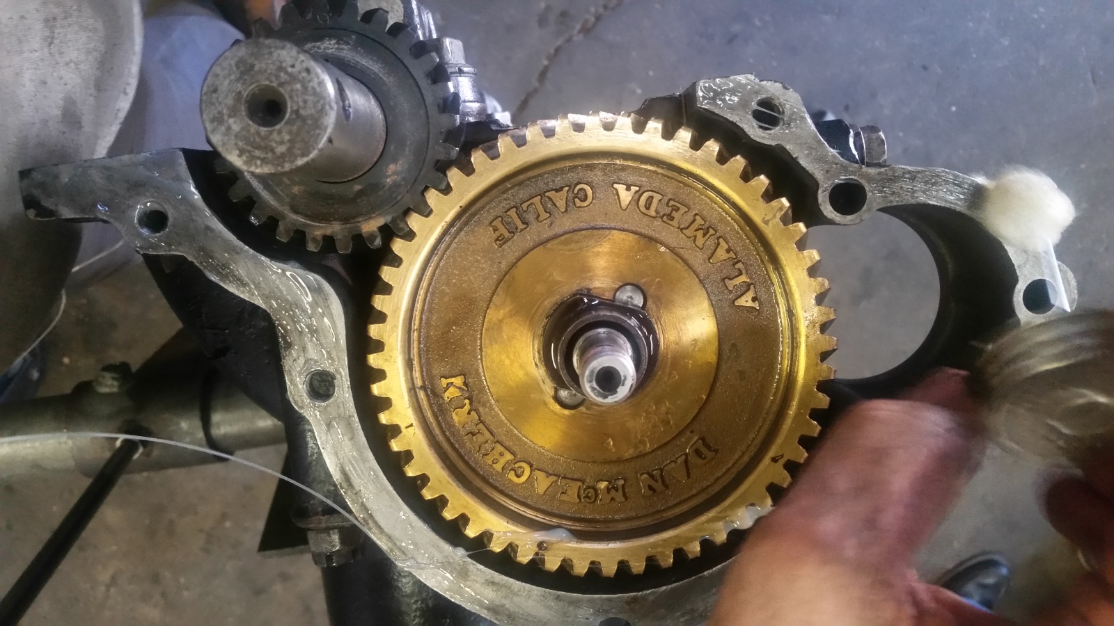

Day 2 of this crankshaft replacement went as well as the first. Erik set the thrust on his lathe and squared the butt of the crankshaft. He, Robert, and I put the engine back together with Erik constantly checking and adjusting tolerances to the micron. The engine is now back in the car with the transmission bands, wishbone, starter, generator, manifold and exhaust, timer, oil circulator, and headlights all squared away. We will start again tomorrow at 9:AM with the goal of having the car "tour ready" by noon, 47 hours after we started. Stay tuned. I will let you all know how that goes.

Well, it was quite a weekend. I had an ideal combination of parts, equipment, and people helping to make the project a success. Steven and my model T partner and best pal Robert Weitzel were troopers on this job.
This is a car I got from the estate of a local club member. I did not build the engine other than looking it over and putting in a Stipe cam and a few other goodies. It came time to find a new steward for it and I found the Chase family at Bakersfield. A few months later Steven joined the infamous two piece crankshaft club. Many here will recall the thread about that. So at this point there was only one appropriate course of action, and that was to return the car to tour ready condition as I promised it to be. In so doing now I have not a customer but a new friend, having spent the weekend fixing the car and making plans to enjoy model T’s together. We are taking it to two car shows and a club tour next weekend. This is good stuff.

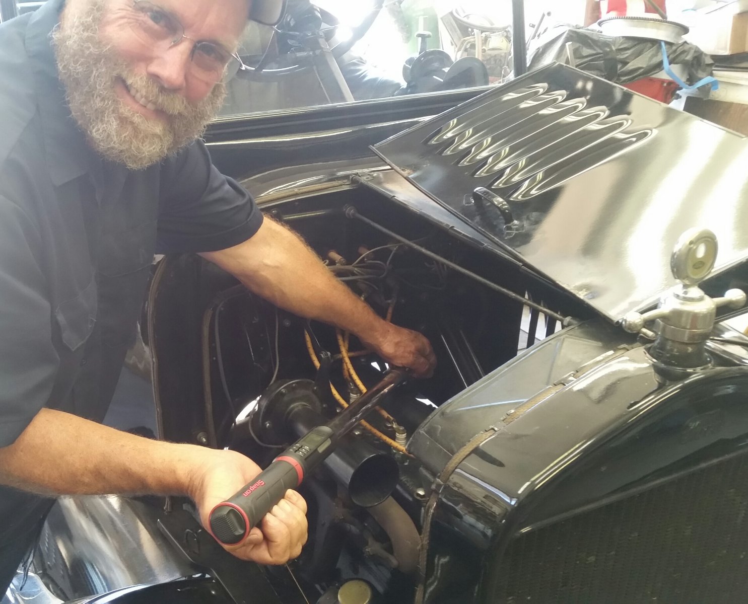

Post rebuild torquing of the head bolts. 50 lbs. Third time after driving car in between. We'll do it again this afternoon and a fifth time tomorrow after the Auburn Beat the Heat tour.
Posts: 6727
Re: How we replace a broken crankshaft at Rumble Seat Garage
Post by Scott_Conger » Sat Jul 13, 2019 2:47 pm
Take it easy there...they should be set already...it's 20HP and 100 y/o cast iron.
