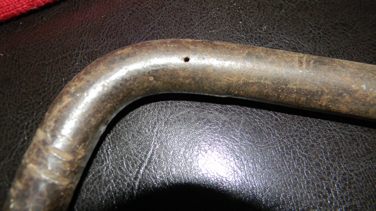

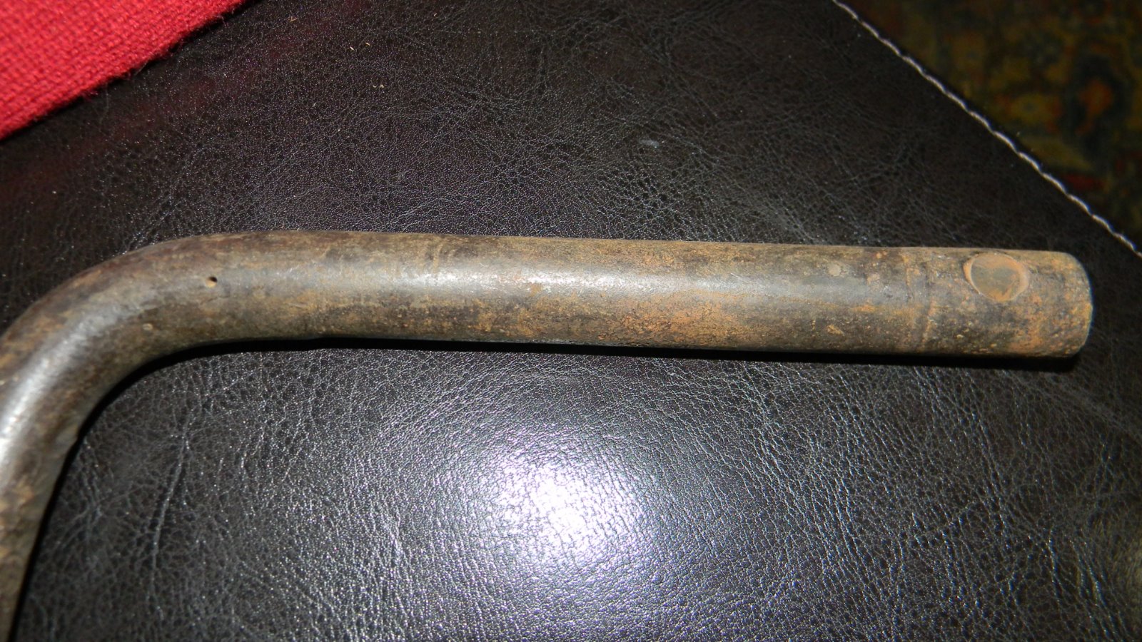

Is there supposed to be a small hole near the end of the starting crank arm for the spring to attach to? I can't seem to find one on mine, but it's been recently painted and I don't know if the hole was filled in with paint.

Yes they all have a hole 5 3/4" from the end on the right side in line with bottom of the hole, Bob

Thanks, Bob, that's kinda what I thought but couldn't remember exactly where the hole was; your photos and measurements helped tremendously!

It's very common for that hole to be so filled with paint and/or crud that it's hard to find.
