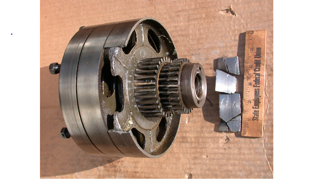

A couple years ago, I began installing new ductile iron low speed drums from Nolting Machine in every complete engine and transmission assembly I build. It is an extra measure of durability and insurance in case the end user doesn’t drive the car right, or makes incorrect adjustments. The new ductile iron drums are able to withstand extreme overheating and still maintain their structural integrity.

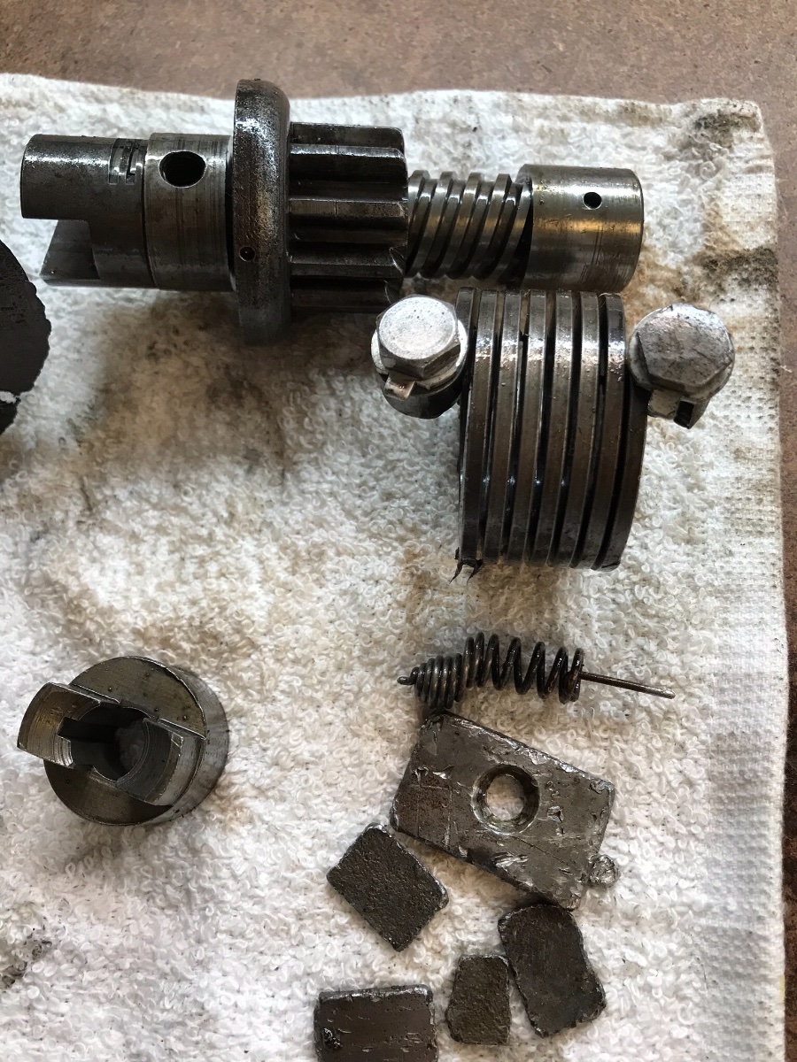

Yes, it has happened to me. About 30 years ago I was driving my dump truck loaded heavy to our club swap meet. It had a Ruckstell, Warford, and no auxiliary brakes. They were not available new at that time and I had been unable to procure an original set. Spare me the lecture, we all know it was a dangerous situation. I knew it at that time and found out just how dangerous it was. Coming down a long hill into town I was keeping the speed down alternating between the brake and reverse pedals. Yeah, with the benefit of experience I know that’s not a good idea either. I touched the reverse pedal at one point and may as well have pulled the pin on a grenade. The sound was apocalyptic. The drivetrain locked, now my rear wheels are skidding and the truck is beginning to swap ends on the highway. To restore control my only option was to slap the Warford into neutral. Now the ride really began. The effect of the “emergency” brake was minimal at best. I rode that sucker about half a mile and blew through two red lights with my air horns tied wide open at about 50 mph. I owe my survival to the fact it was 5AM on a Sunday and there was near zero traffic. The devastation was complete. Punched holes in the pan and hogshead, broke the cylinder block and crankshaft. Almost every moving part was scrapped. After that my father said even when I put in another engine I wasn’t going to drive it again until I had some kind of brakes.

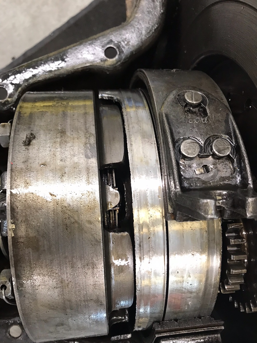

I did have kevlar bands, but that was not what caused it! When I first placed the new bands, I noticed the low drum was bluish color. This was caused by overheating. It finally led to the catastrophy shown in the picture.
The actual cause was worn low cam and low notch. These are the tapered parts which cause the low pedal to move right when you push the low pedal in. They were so worn that the band could not be tightened enough to keep the band from slipping. It would operate when the pedal was below the level of the floorboard. Consequently, in order to get the low to work at all required tightening until the band was dragging even when in neutral, high or reverse. Of course it required frequent adjustments to even have a low gear and finally the drum collapsed. When I pushed the low pedal, the car skidded to a stop and could not be moved even in neutral or by pushing without jacking one rear wheel with a rolling jack.
After I replaced the drum, the shaft, the cam and the notch, I still have kevlar and no recurrance of the problem.

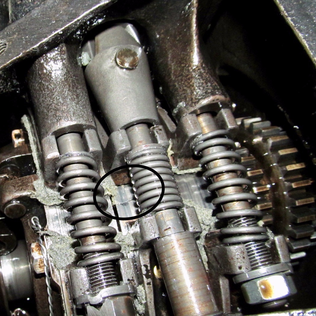

On a tour, participant was having trouble with free neutral, T was creeping ahead.
Once inspection cover was lifted could determine.
Earlier complaint was of poor low pedal, judged from worn and thin Kevlar lining, so the adj. screw was turned in a few times over a period of time to obtain good low gear..could see that.
Closer inspection shows reason for lack of free neutral, low band was drawn up very tight. And there is a crack in the drum surface.
So, drum replacement is needed.
Was the culprit of the over time tightening of the low pedal ... for thin linings ...due to existing crack in the low drum that shaved off Kevlar?
Or was the final tightening of the low pedal the cause of the cracked drum?
Have my opinion the crack was there for a while, and constant usage of that drum and adjustments just led to the final result.

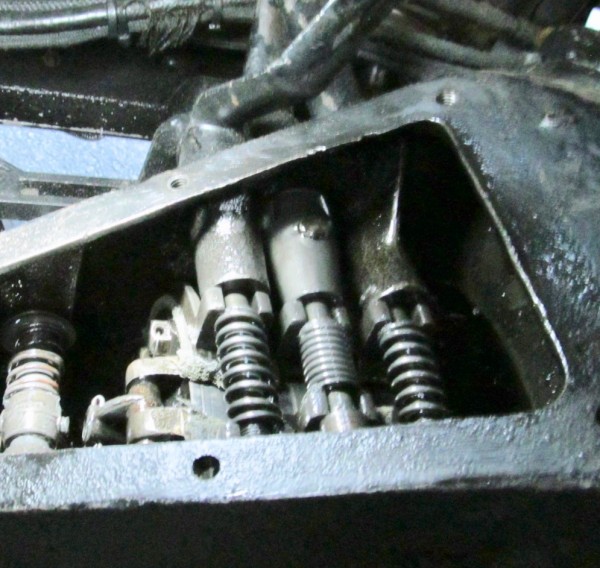

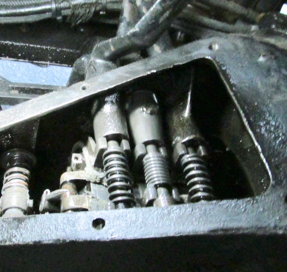

something else that shows on your photo is alternately insufficient "stick out" of band material, and far too excessive stick out, depending on which band you look at. Steve's showed excessive stick out, too.
If the band (regardless of cotton or Kevlar) is not installed properly, ie with a very tightly compacted weave, bands can act very strangely. I once got a car in that had dragging bands, yet mushy pedals. As installed in the car, I found the band material nearly met in the center and when removed, the band material stretched from rivet to rivet...there was clear air between the material and steel band. Wrongwrongwrong.
I have no idea what caused Steve's problem, but it is certain that Improper material installation and worn out hogs heads have been breaking drums since Henry's engineers designed them. Dave Huson used to say that he'd go through many many transmissions and find mostly broken low drums, and these transmissions gave their lives long before the advent of Kevlar.

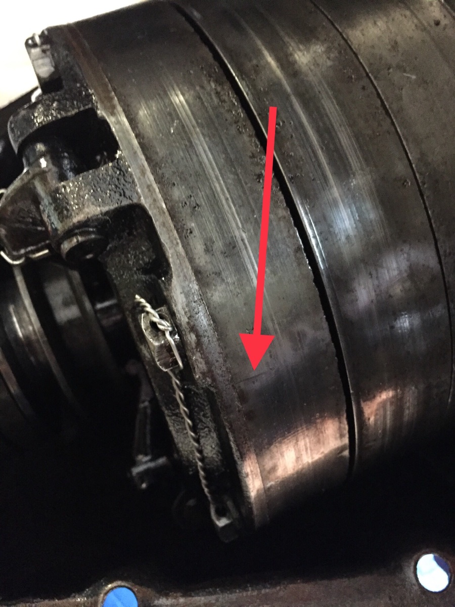

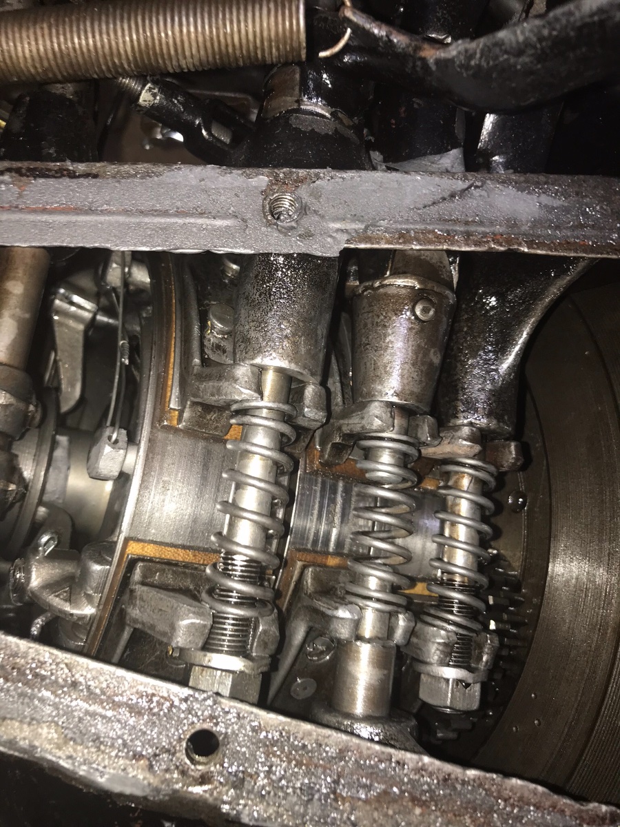

Yes. Not just cracked, exploded. While doing 40mph, so not under stress so to speak.you can see the wear line in the center of the drum, and when I got the car I wondered about that wear line.
And they were not kevlar bands. Have Kevlar now.
The pieces ended up everywhere in the motor and mostly in the bendix cover. You can’t imagine the racket when it let loose...
The first pic was taken the day I got the car and you can clearly see the wear line.

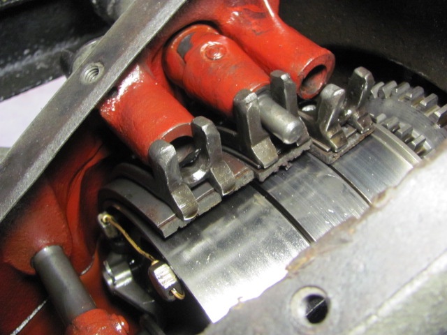

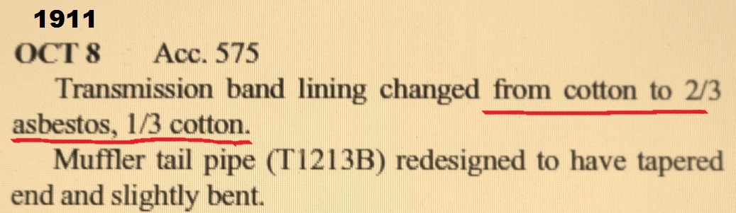

The band lining material is just one factor.
Different materials have been used. And as Scott posted, broken drums have been around long since Kevlar.
And Ford didn't use plain cotton either......the woven material for Ford linings over a long time contained a percentage of asbestos. That is a pretty rock hard fiber

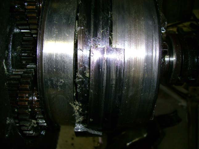

The photo shows the failure of the reverse drum I experienced over 10 years ago with Kevlar bands. I drive my T between 25 to 35 MPH and was in highway traffic when it exploded.
