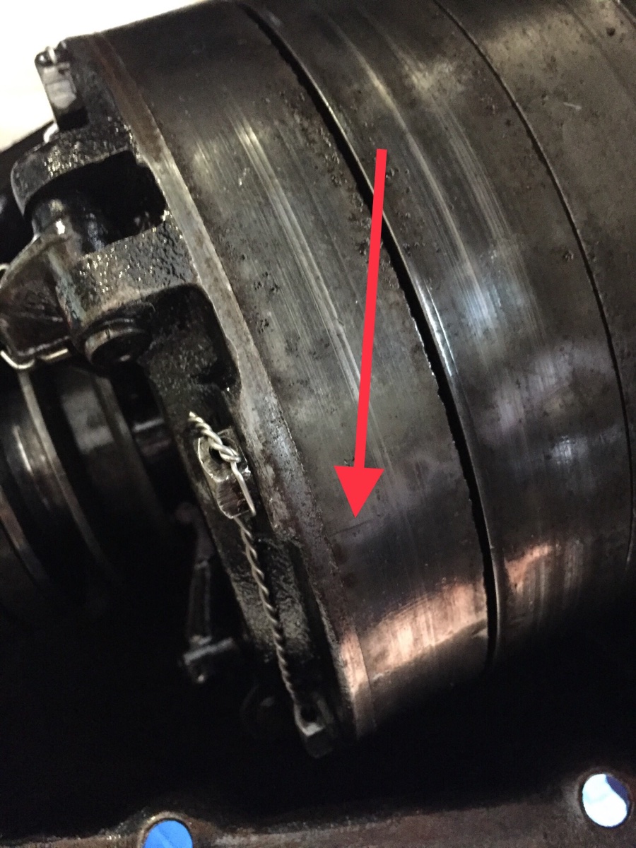

On a tour, participant was having trouble with free neutral, T was creeping ahead.
Once inspection cover was lifted could determine.
Earlier complaint was of poor low pedal, judged from worn and thin Kevlar lining, so the adj. screw was turned in a few times over a period of time to obtain good low gear..could see that.
Closer inspection shows reason for lack of free neutral, low band was drawn up very tight. And there is a crack in the drum surface.
So, drum replacement is needed.
Was the culprit of the over time tightening of the low pedal ... for thin linings ...due to existing crack in the low drum that shaved off Kevlar?
Or was the final tightening of the low pedal the cause of the cracked drum?
Have my opinion the crack was there for a while, and constant usage of that drum and adjustments just led to the final result.

something else that shows on your photo is alternately insufficient "stick out" of band material, and far too excessive stick out, depending on which band you look at. Steve's showed excessive stick out, too.
If the band (regardless of cotton or Kevlar) is not installed properly, ie with a very tightly compacted weave, bands can act very strangely. I once got a car in that had dragging bands, yet mushy pedals. As installed in the car, I found the band material nearly met in the center and when removed, the band material stretched from rivet to rivet...there was clear air between the material and steel band. Wrongwrongwrong.
I have no idea what caused Steve's problem, but it is certain that Improper material installation and worn out hogs heads have been breaking drums since Henry's engineers designed them. Dave Huson used to say that he'd go through many many transmissions and find mostly broken low drums, and these transmissions gave their lives long before the advent of Kevlar.

Yes. Not just cracked, exploded. While doing 40mph, so not under stress so to speak.you can see the wear line in the center of the drum, and when I got the car I wondered about that wear line.
And they were not kevlar bands. Have Kevlar now.
The pieces ended up everywhere in the motor and mostly in the bendix cover. You can’t imagine the racket when it let loose...
The first pic was taken the day I got the car and you can clearly see the wear line.

Wow that stuff in the Bendix cover is impressive. Mag contact, magnet keeper, and shards. They don't look like drum shards, but I have to believe you on that.

looking at the pits and rough edges on those drums, Kevlar was the least of your worries. Hopefully the Guinns have turned out to be what you'd hoped for.

Yup, that’s drum material. Anyone know what the bands are in those pics? Wood?
I’m monitoring the wear on the new trans with the Kevlar and so far I see no wear after a couple thousand miles (I drive this car every day, and hard- a mile of steep low band hill each time). I’m honestly of the opinion that the last failure was the PO’s driving style and wood? Bands...

Scott,Scott_Conger wrote: ↑Sat Jul 27, 2019 11:25 pmDan B
You are right. I knew a lot more the second time around building the transmission and found a good set of donor drums. Straightened out a lot of things including bent pedals, which was probably the leading cause in the drum breaking in the first place.
The Guinn bands definitely have a different feel to them than the Kevlar. I felt like I was learning to drive all over again. The also have not seated as quick as the Kevlar bands. I have had to adjust my brake band several times since installing them.
- Posts: 6558
Re: Have you had a drum failure ? POLL
Dan
your picture looked familiar...not sure if you had posted way back when...
experience can be a tough teacher, wouldn't you say?
I am glad things are settling in for you
