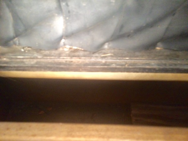

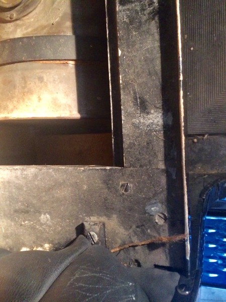

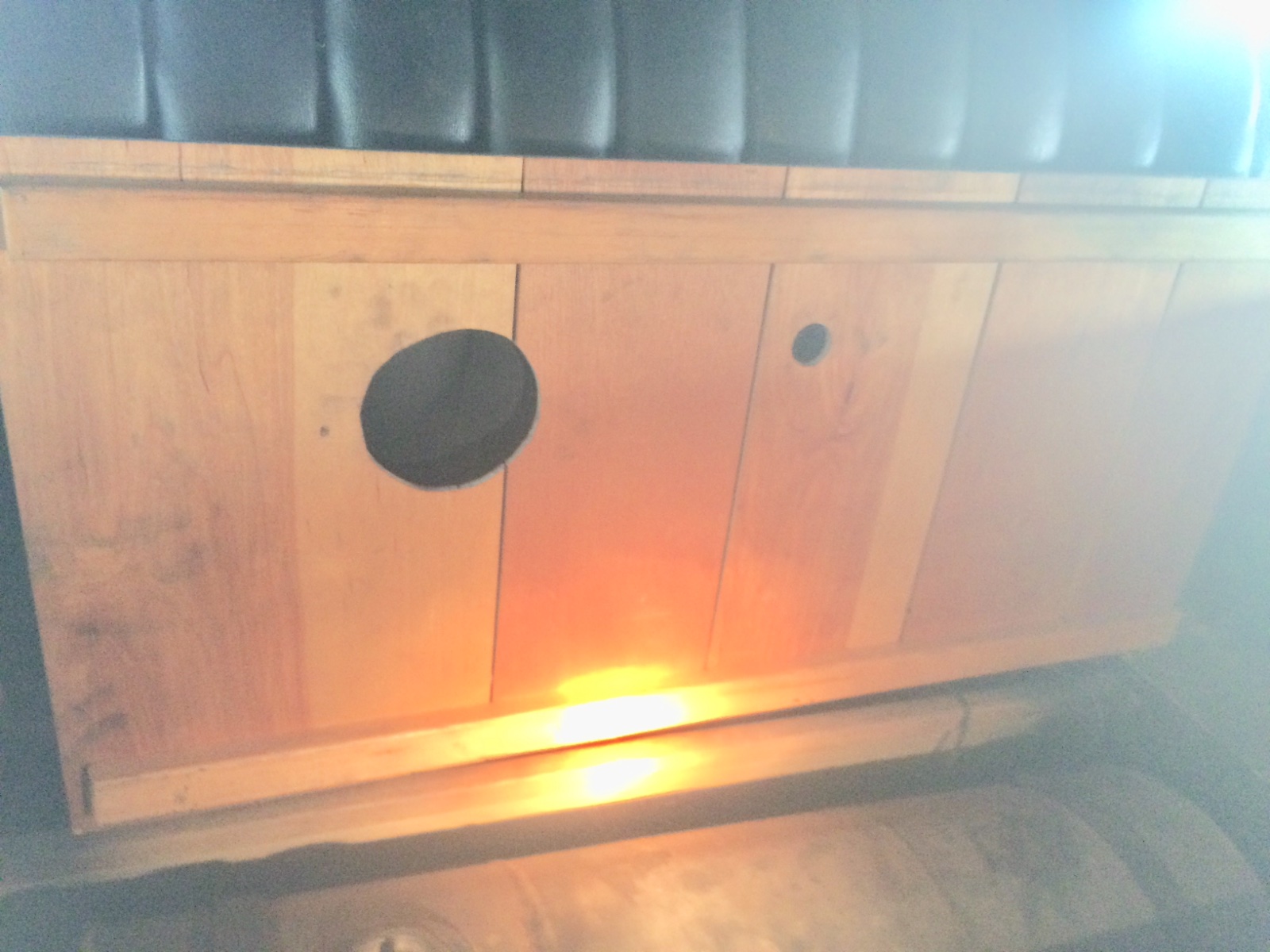

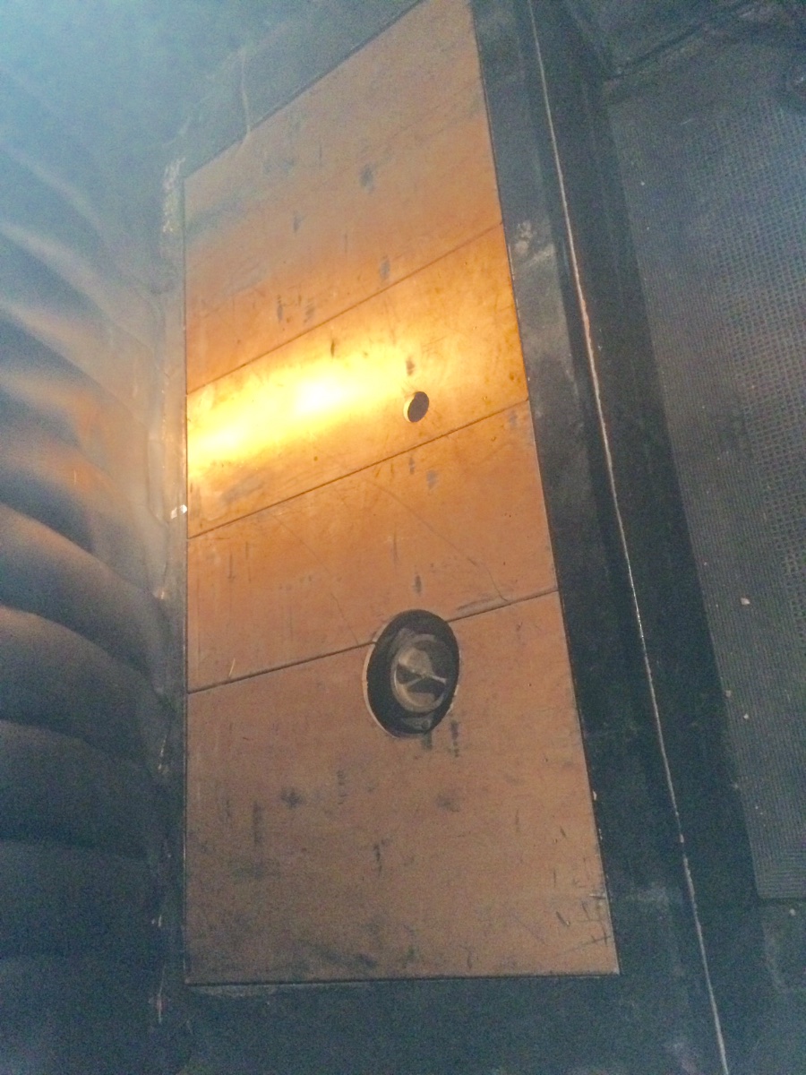

Here’s my ‘14 runabout under-the-seat wood: the ‘lid’ measures 31 1/4” X 14 5/8”. This body was reworded by Ray Wells aka The Craftsman.
Backside of gas tank ‘cavity’. Note frame ‘rabbited’
Underside of ‘lid’. Note parallel supports
Right front corner. Note bracket and front ‘rabbiting.’
Lid in place. Gas filler hole and ‘finger lift’ hole

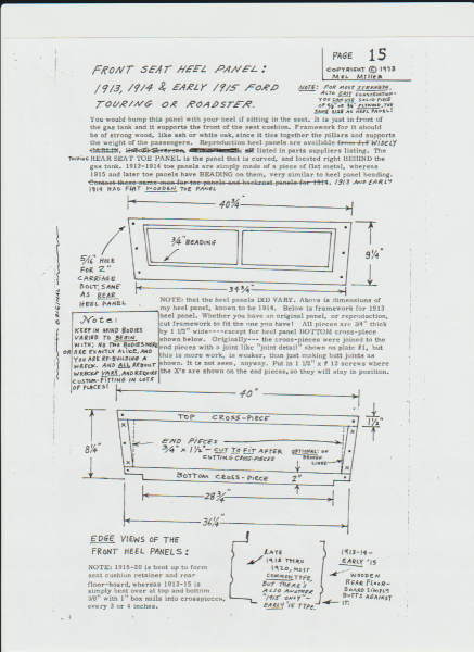

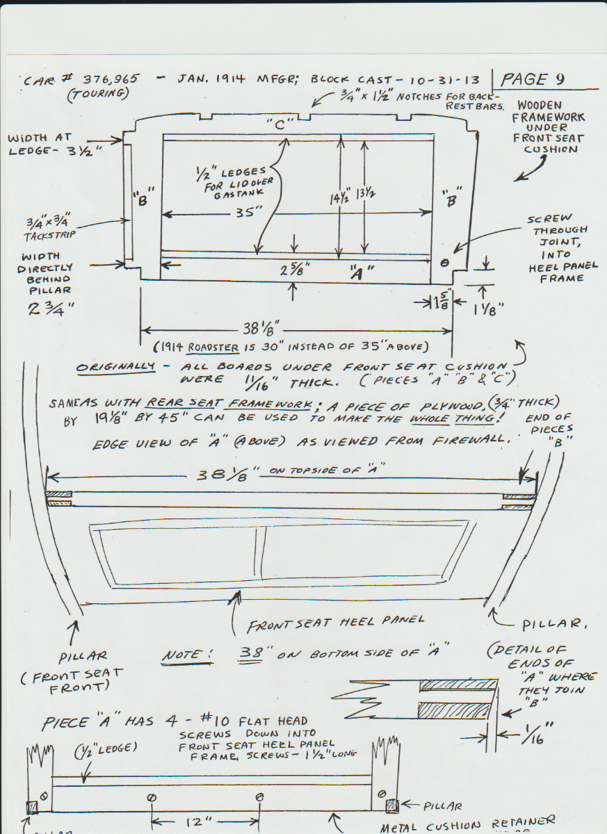

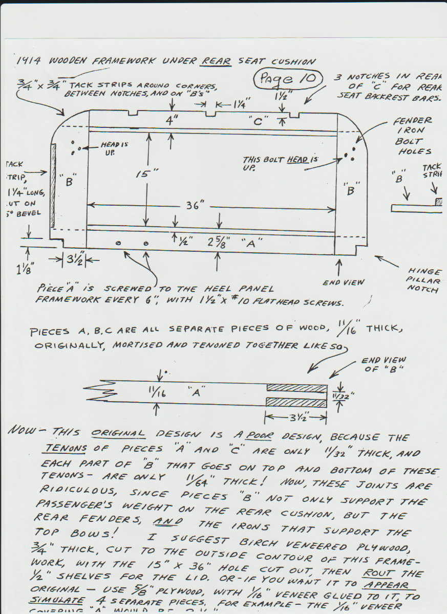

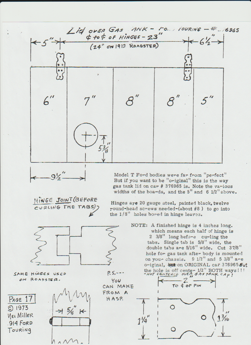

Post by Colin Mavins » Sun Sep 08, 2019 10:30 am

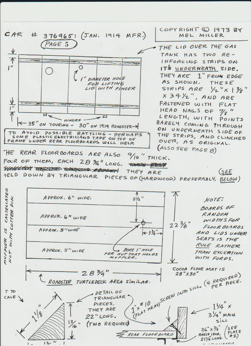

these are from the 14 touring -roadster plans Cheers Colin
