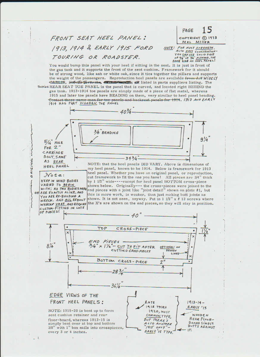

Re: Need photos of 1914 Roadster body wood
these are from the 14 touring -roadster plans Cheers Colin
Thanks Colin, Dave and Steve! This is great info!!
