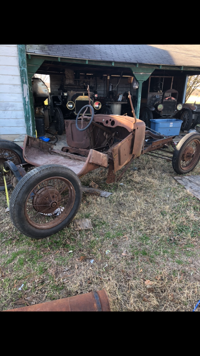

I need to do some patch work on my pickup and have body for a speedster that cracks. Does anyone use a flux core wire welder for this type of thing? Also is there any type of rod that can be used with a lower temp than acetylene?
I know gas wire feed is best but more than I want to spend at this time.

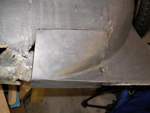

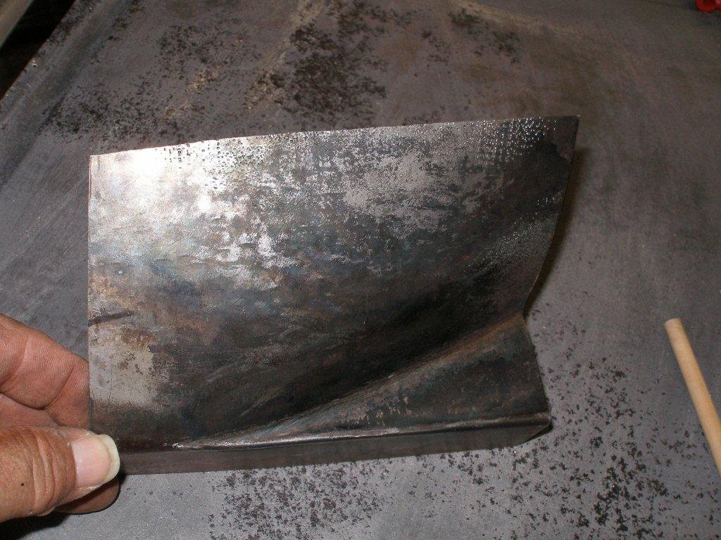

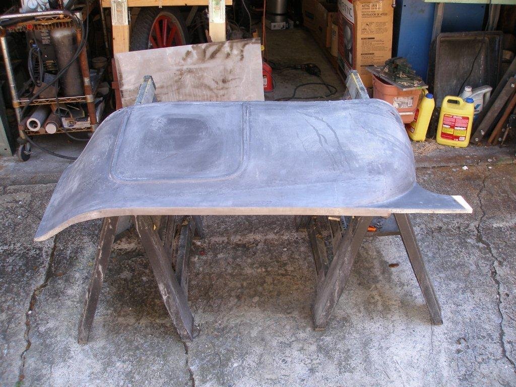

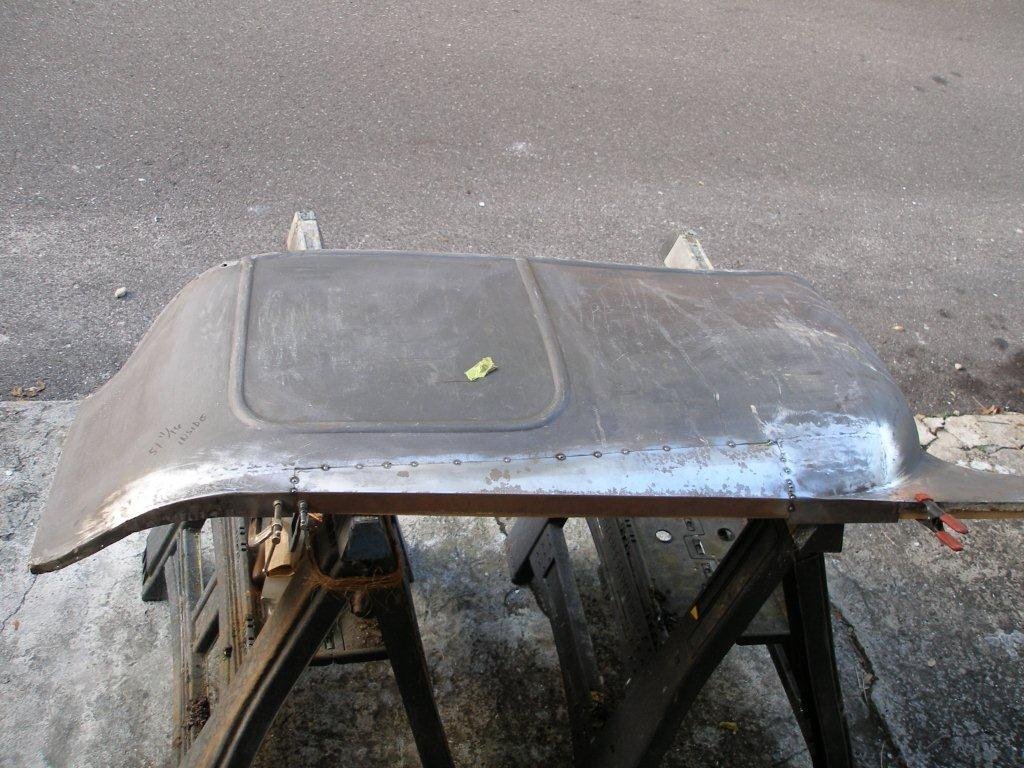

like this?:

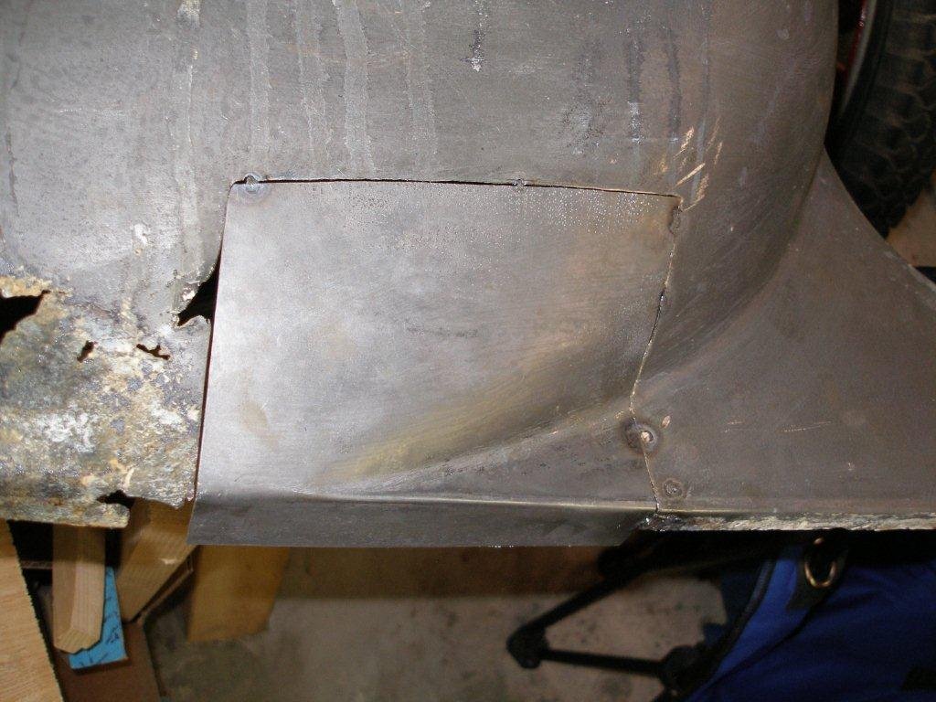

Re: Welding on a body

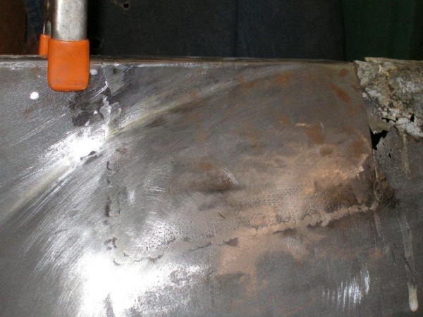

and ending something like this?

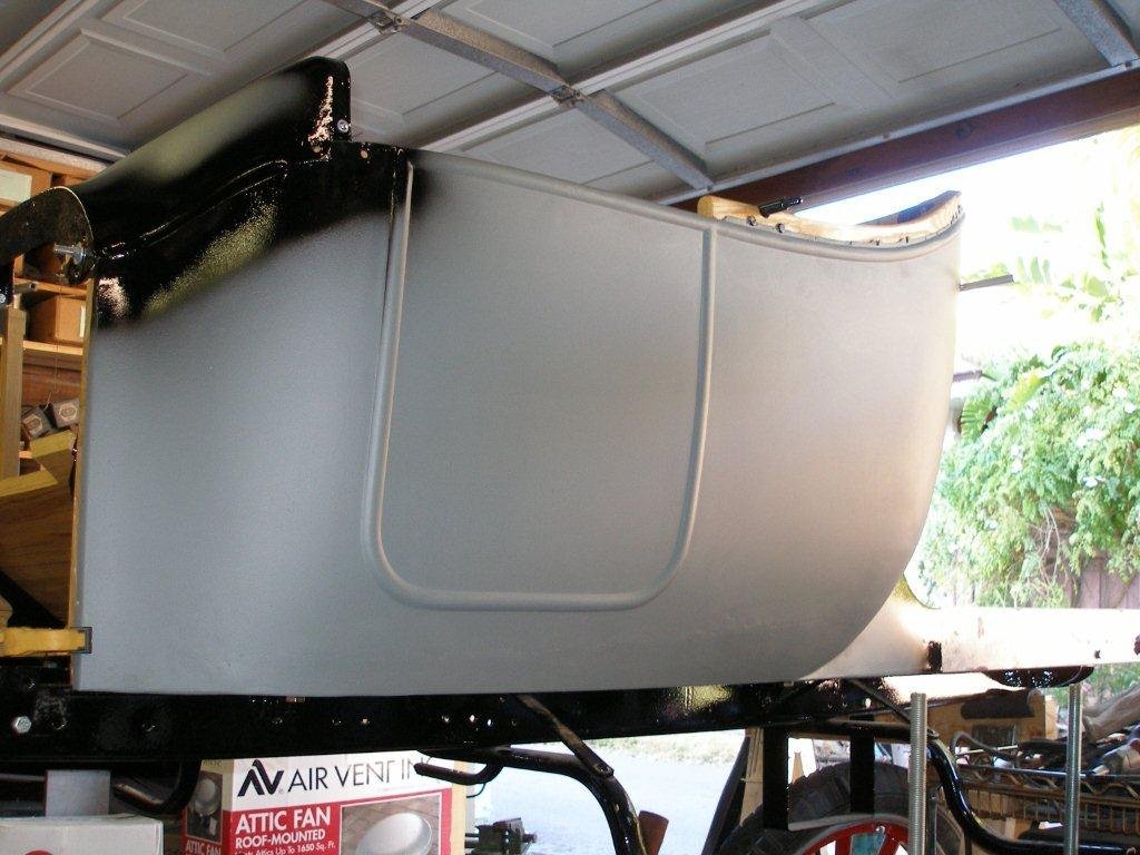

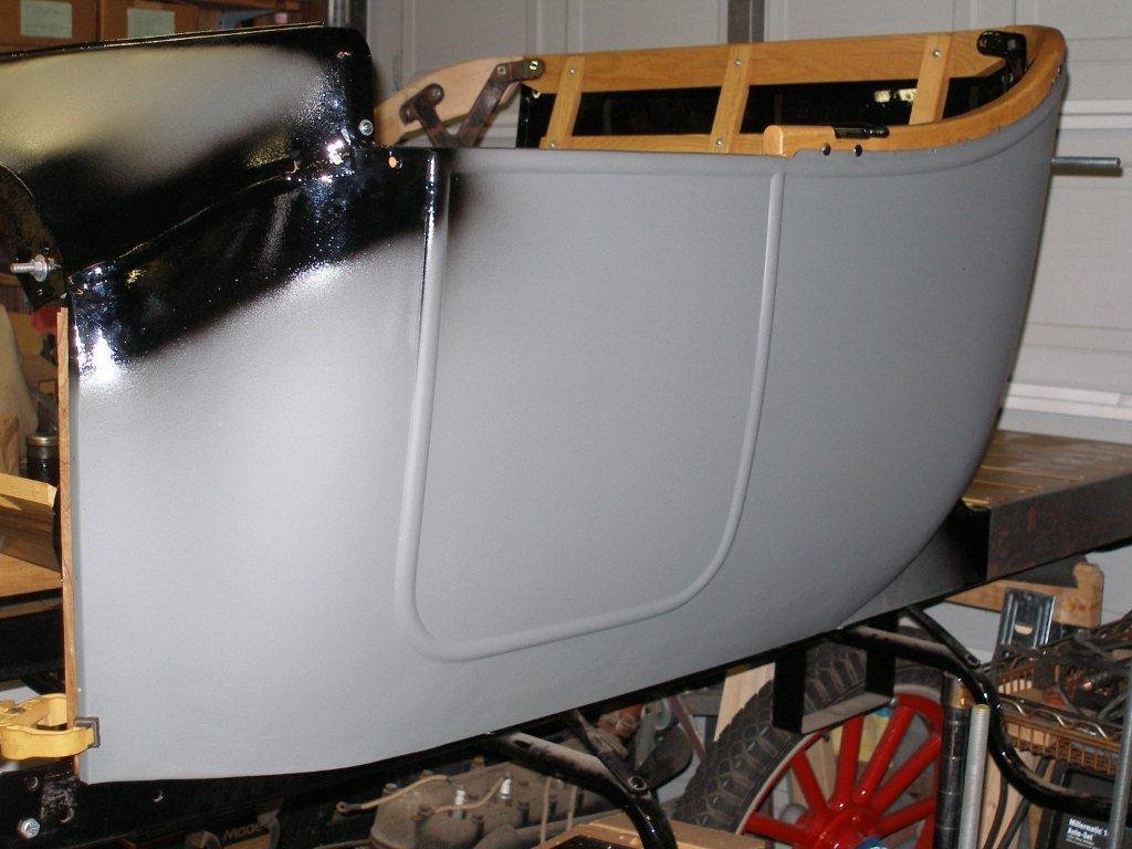

What I learned from all that is: Buy A Better Car To Start With

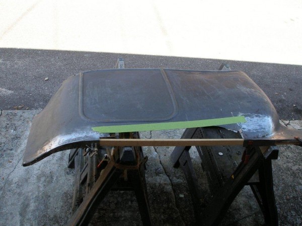

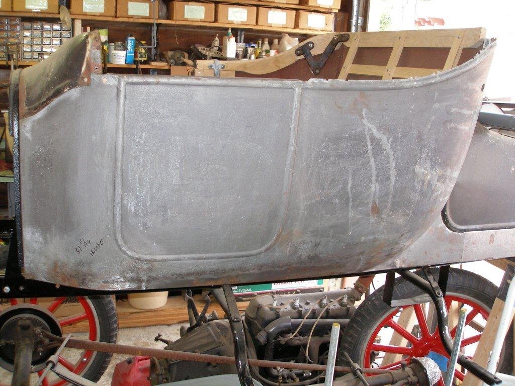

I've never experienced expansion when hammer welding, except to create it to un-do shrinkage. If it did in fact expand, there are a couple methods to shrink metal without a whole lot of trouble.
This panel had a bulge in it like someone threw a bowling ball into the trunk...bulge is gone and panel is straight with no filler:

Scott, EXACTLY like that !!
Good on ya for truly "restoring" that body.

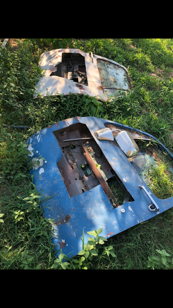

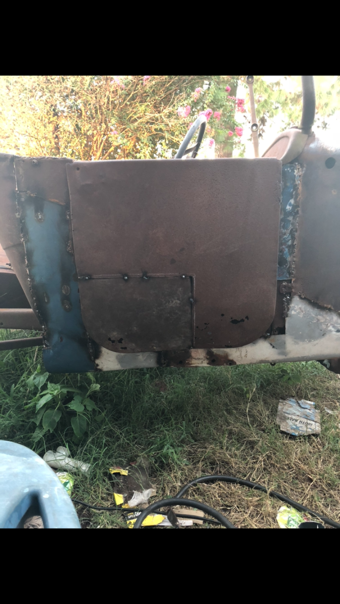

Somebody on another forum had mentioned using old Chevrolet truck doors for patch panels. They work well for the bottom of the body because they have a brake line in them already but not quite 90*, and the metal is slightly curved already. I know this isn’t a T body but it’s similar. The back doors were attached so I used those skins to make one door skin, the other side was better.
