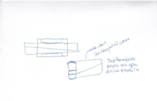

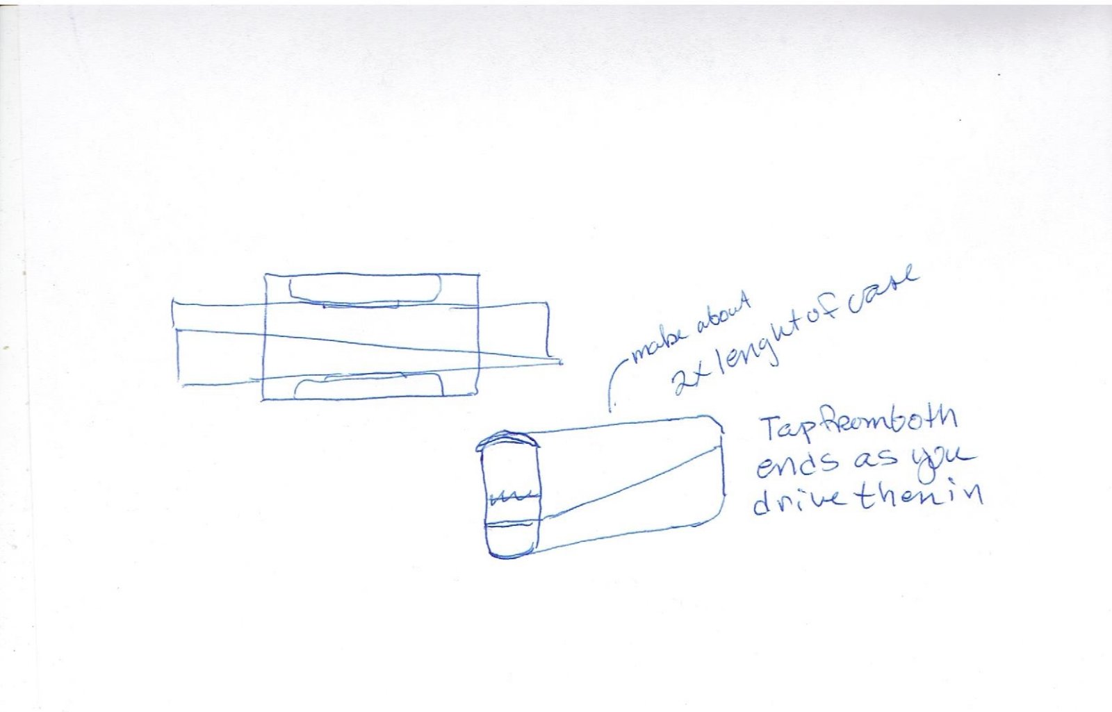

Make 2 hard wood wedges (like door stops) so they would stick out both side of the case, round over the flat side somewhat match the curve in the shoe. After you get the pole shoe screws in as tight as you can, drive them in to expand the shoes. While you can only do 2 shoes at a time, it would work. We used a setup like that for a while till we got the tool. Don't try and make the slope too steep.
