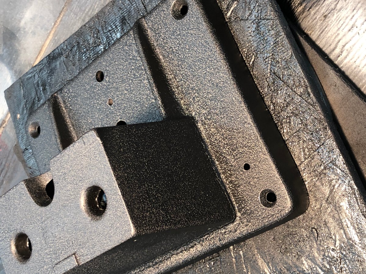

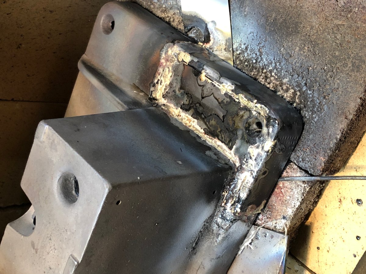

Here is the next part that needed fixing.
I had a friend machine the broken area and make apiece to fit.
It is silver soldered in place.
Here is the finished product.
The black wrinkle finish paint masks the repair.
