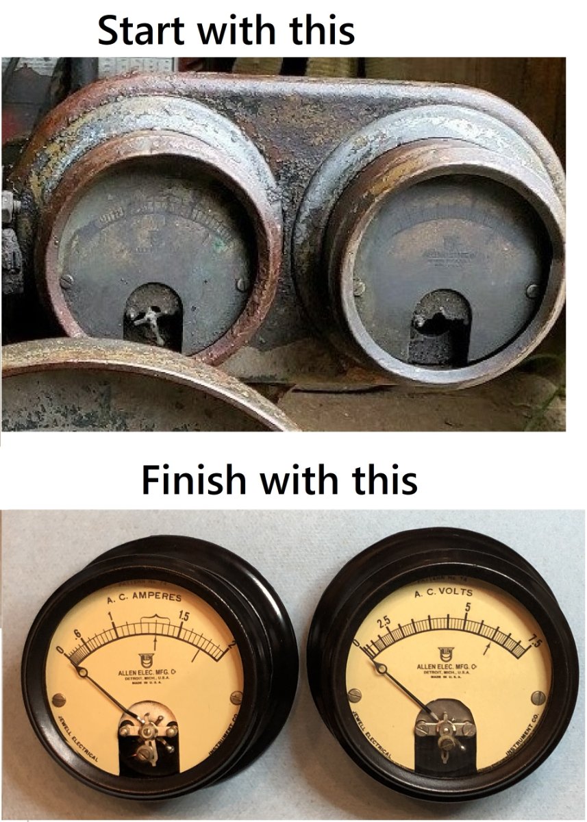

In the spirit of Before & After started by Mr. Howe ...
Here are the meters from a HCCT I picked up recently.

Wow! that's beautiful work Bob.
The many talents that fellas have on this forum is amazing. I'll bet if we all got together we could build a car!

Thanks for the ata-boys
The only parts that were salvageable from the original meters were the cases.
I replaced the movements and coils and calibrated them.
The ammeter had to be wound from scratch.
Now on to restoring the rest of the HCCT.
