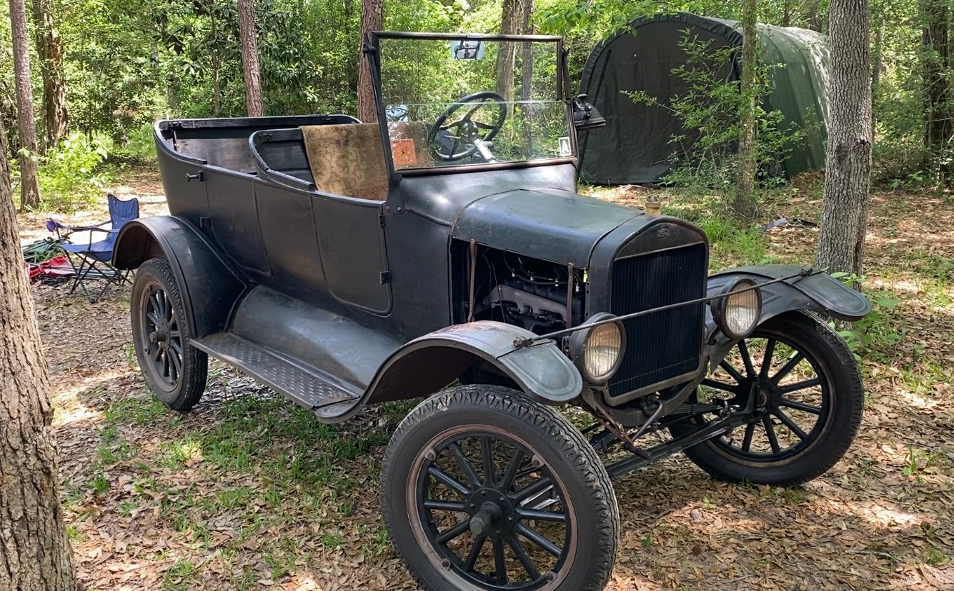

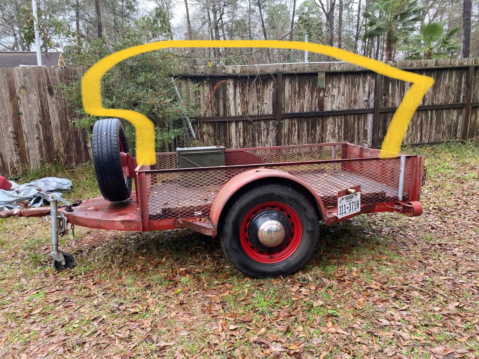

I bought John Mays' trailer about a month ago and carved out a patch of forest to build a shed for it.
It's an aluminum car-hauler with a wind-dam....perfect for a Model T. The fenders are removable, it has a winch, plus retractable d-hooks built into the floor and four really nifty heavy-duty tie down straps.
I now have everything I need to take the T on tours.

Nice rig!RustyFords wrote: ↑Sun Jan 05, 2020 6:37 pmI bought John Mays' trailer about a month ago and carved out a patch of forest to build a shed for it.

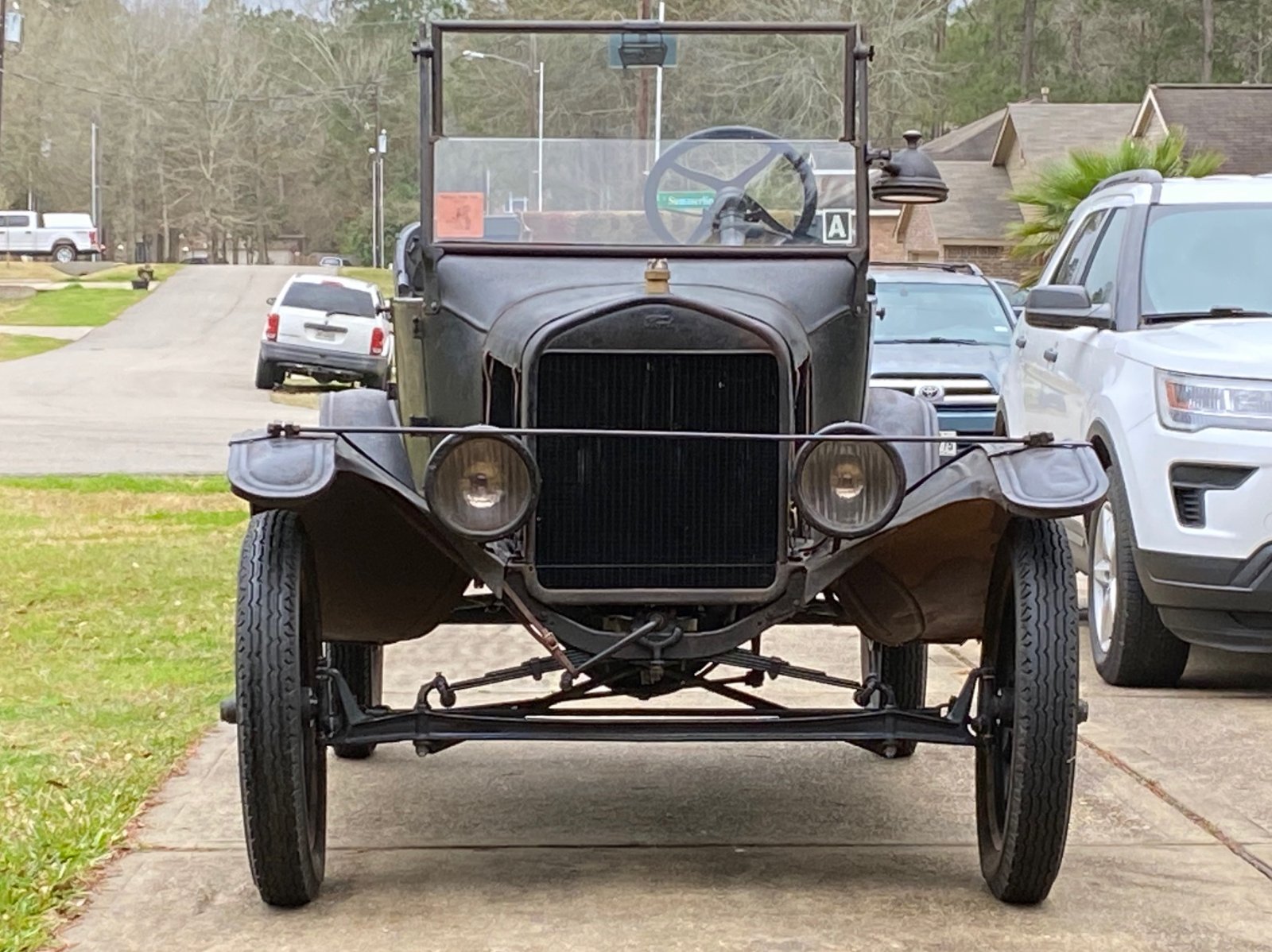

She’s looking a bit forlorn without a front suspension.
1924 Touring
- Posts: 2843
- First Name: Dallas
- Last Name: Landers
- Location: N.E. Indiana
Re: 24 Touring Barn Car Revival - Part 3
Ya, but she still has a great smile!

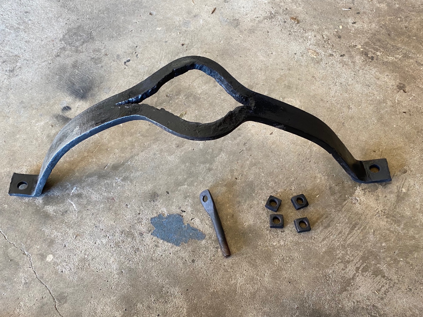

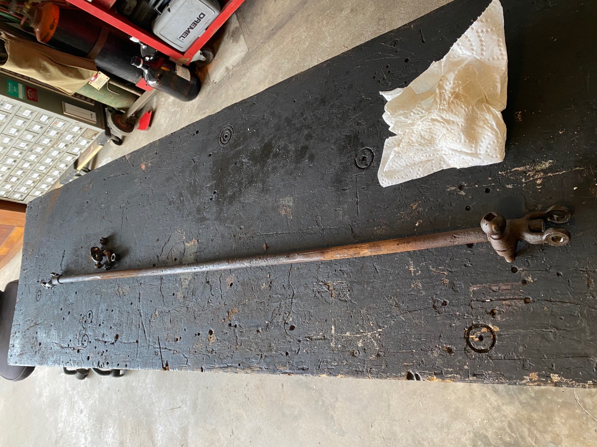

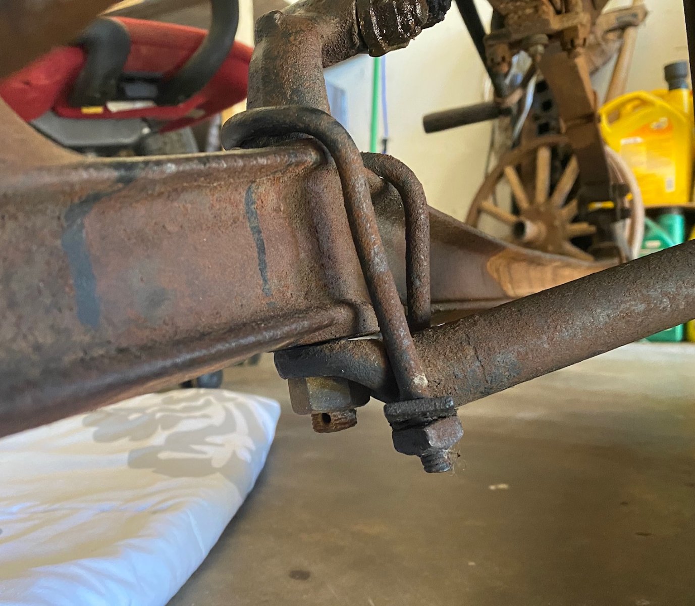

A casualty of the current spring/perch/spindle project was these thingamabobs.
I assume they were some kind of safety device to hold the radius rods in place in case they broke loose. I tried to remove them without damaging them in case someone wanted to use them, but the fasteners wouldn't budge. So...I cut them off.
I took a close look at them and came to the conclusion that they were homemade and not an aftermarket accessory. They'd obviously been on the car a very long time however and I hate to destroy anything that's survived that long, but they had to go.
It's a good thing they were there however. Check out the lack of a castle nut and cotter pin! Again...YIKES!
This project was past due.

Steve posted on" what have you done in Janurary," about the same aftermarket thingamabob.
- Posts: 2843
RustyFords
Topic author - Posts: 1559
- First Name: Don
- Last Name: Allen
- Location: Houston, TX
Neat!Dallas Landers wrote: ↑Thu Jan 09, 2020 5:46 pmSteve posted on" what have you done in Janurary," about the same aftermarket thingamabob.
Steve's looked like actual aftermarket items, whereas mine looked homemade.

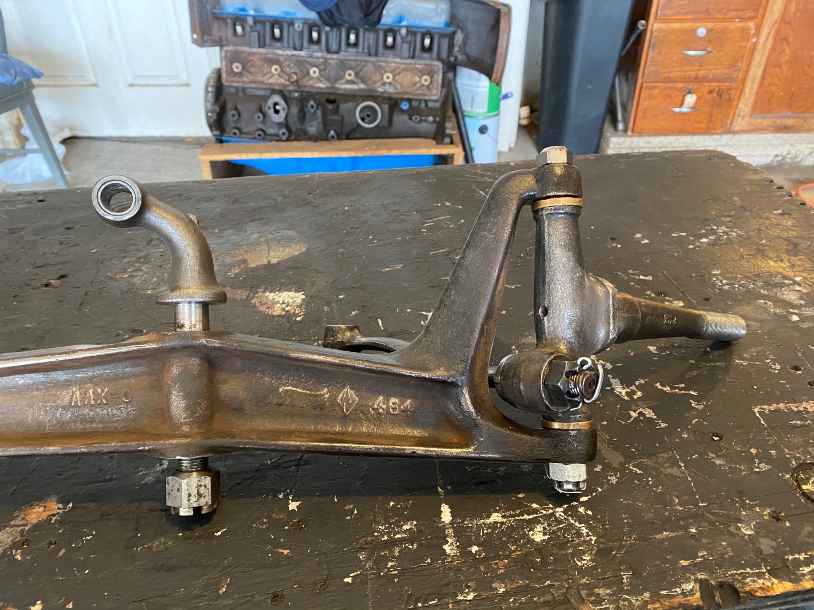

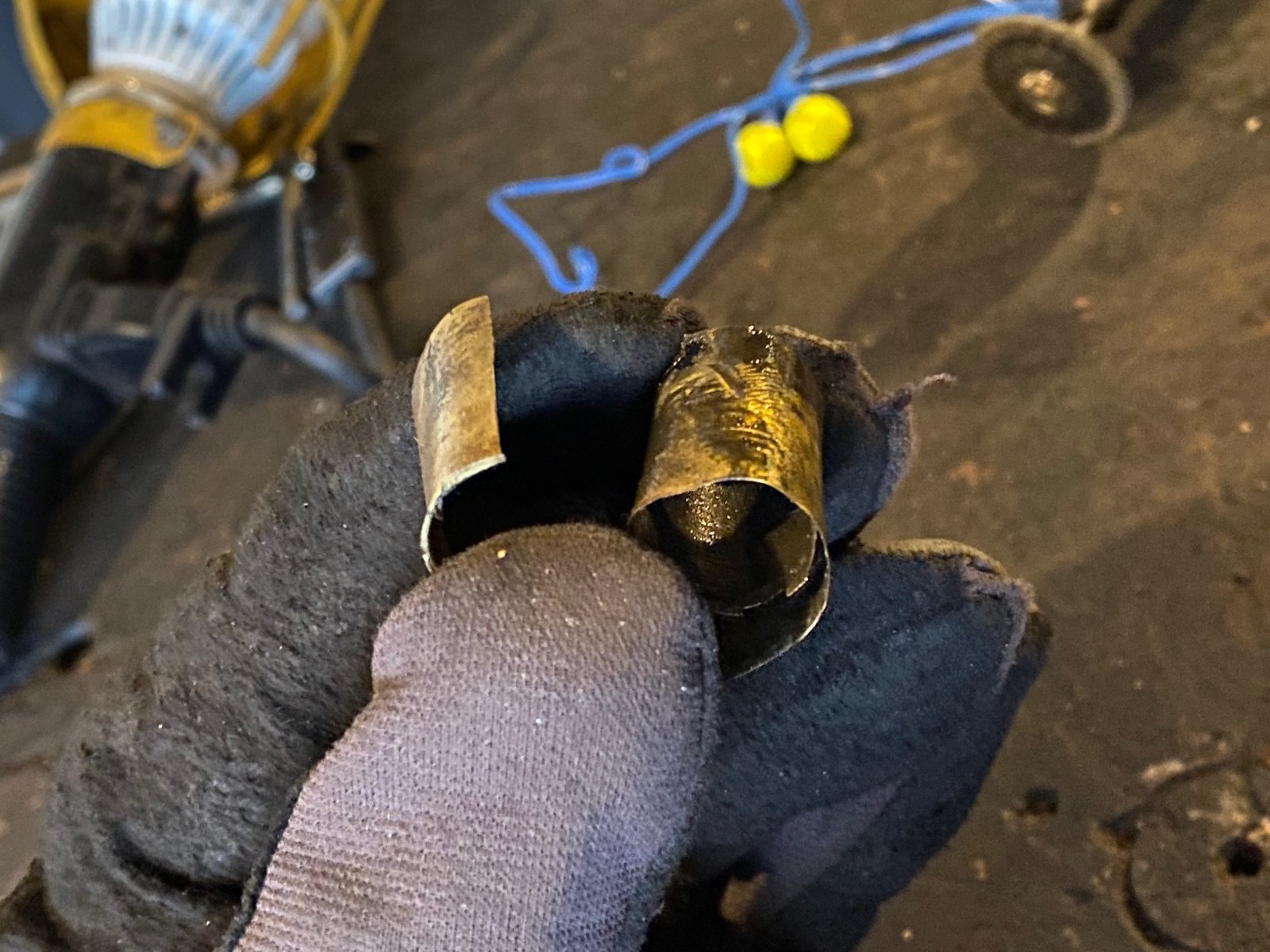

As expected, these perches are whooping my a**.
All I've managed to do is mangle the two old perches and have only budged them about 1/4 inch. So...I'm throwing in the towel and will have a pro press them out of the axle.
And I found yet another old-time farm fix. This was what they used for a bushing on one of the steering arms.

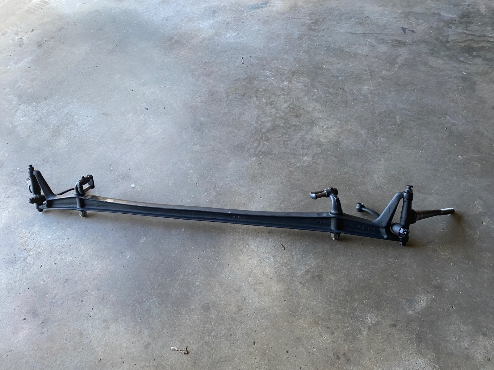

I attacked the perches again over the weekend and they laughed at every attempt to remove them.
That, combined with the fact that the axle will have to be reamed (I don't have the tool to do it) caused me to make the probably prudent decision to take the axle to Ross Lilleker to have him do the above. He's also going to check the axle for straightness and correct it if it needed.
My job keeps me hopping so this was probably for the best. Ross' work is simply second-to-none and I'll have confidence knowing that he did the work on these critical components....especially since they play such a huge roll in how the car handles and steers.
While Ross has the axle, I'll work on the other items on my list: Fuel Line, Accessory Belly Band, Motor Mount Wood Blocks, Door Wood, etc.

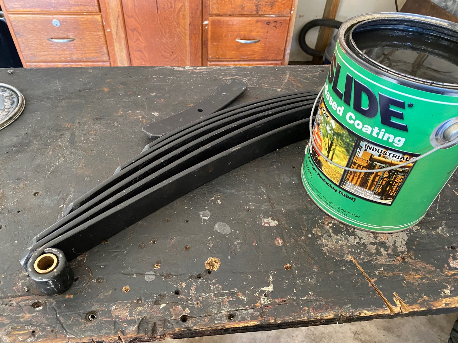

Painting my new front springs with graphite paint.

Yeah...that graphite paint has some kind of demonic alien super powered bonding agent that makes it a permanent part of your hand.Dallas Landers wrote: ↑Sun Jan 19, 2020 7:51 pmRight there with you Don! I assembled mine yesterday. I used some antisieze between each leaf. That graphite paint dries but still makes your hands slick handling the springs.
And, by the way, if anyone in the Houston area needs some graphite paint, let me know. At this rate, the gallon I have will outlast my grandchildren. Heck, if anyone going to Chickasha wants some, bring a container and I'll give you some.

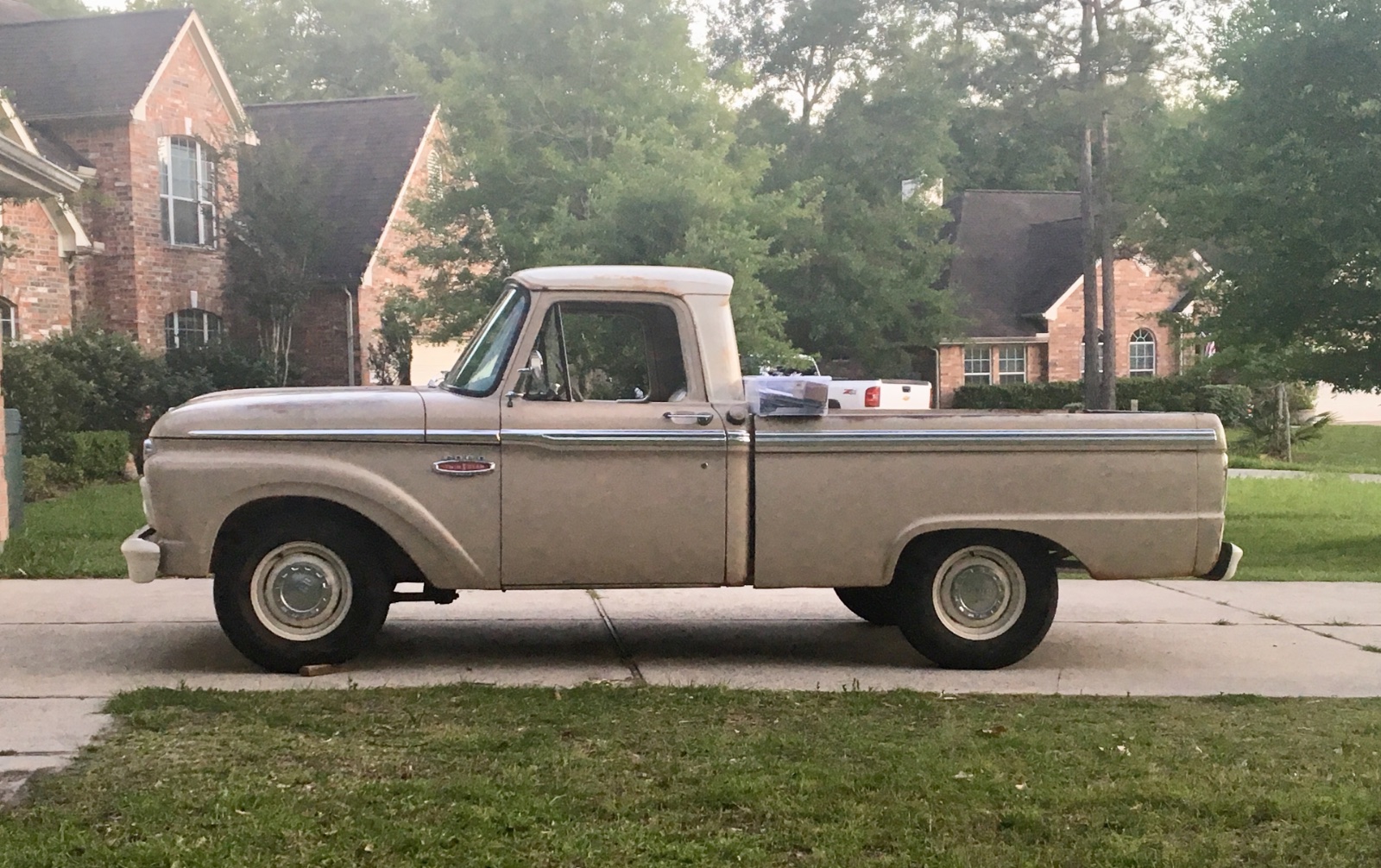

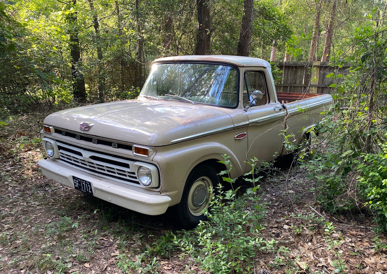

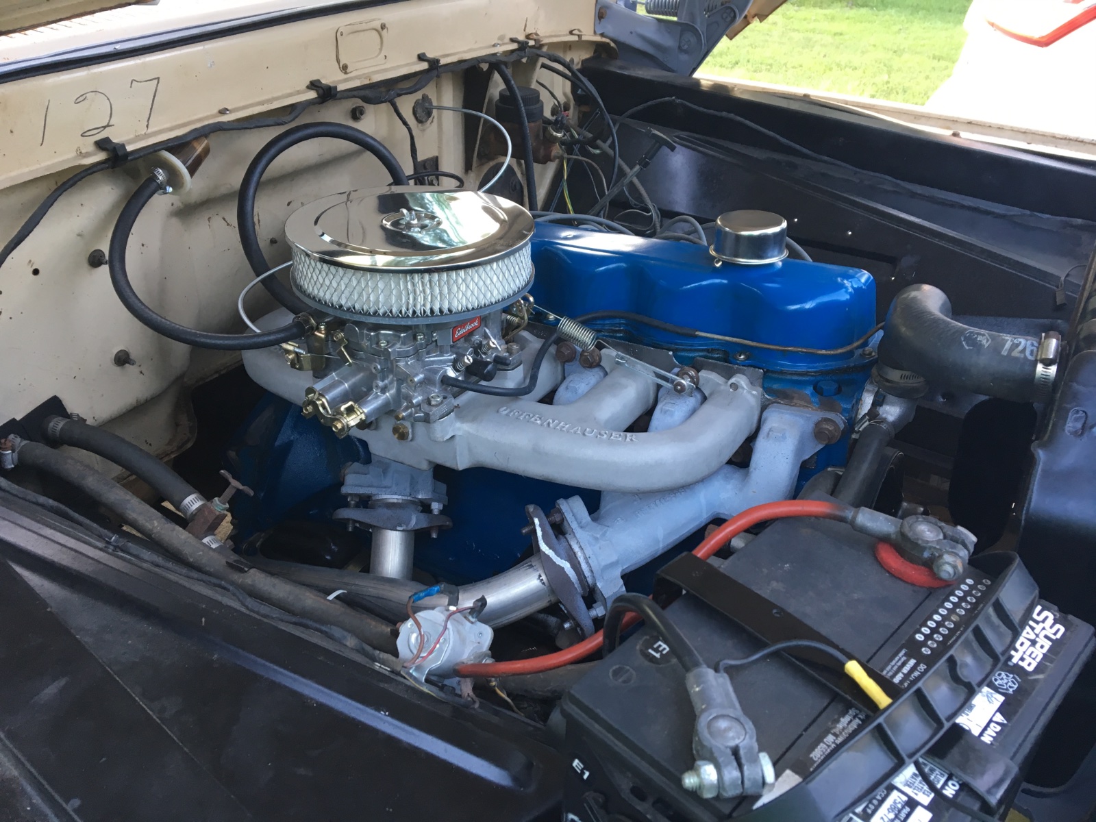

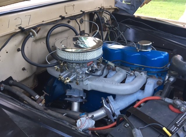

Is that yellow object in 1 of the pics a Unibody Ford pickup?
RustyFords
- First Name: Don
- Last Name: Allen
Mack...it’s a 66 F100 Styleside (shortbed). Original paint 79k miles. 300 straight six that I hopped up a little bit.

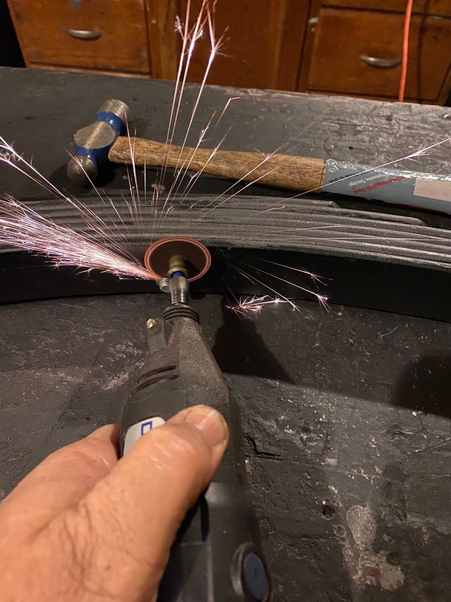

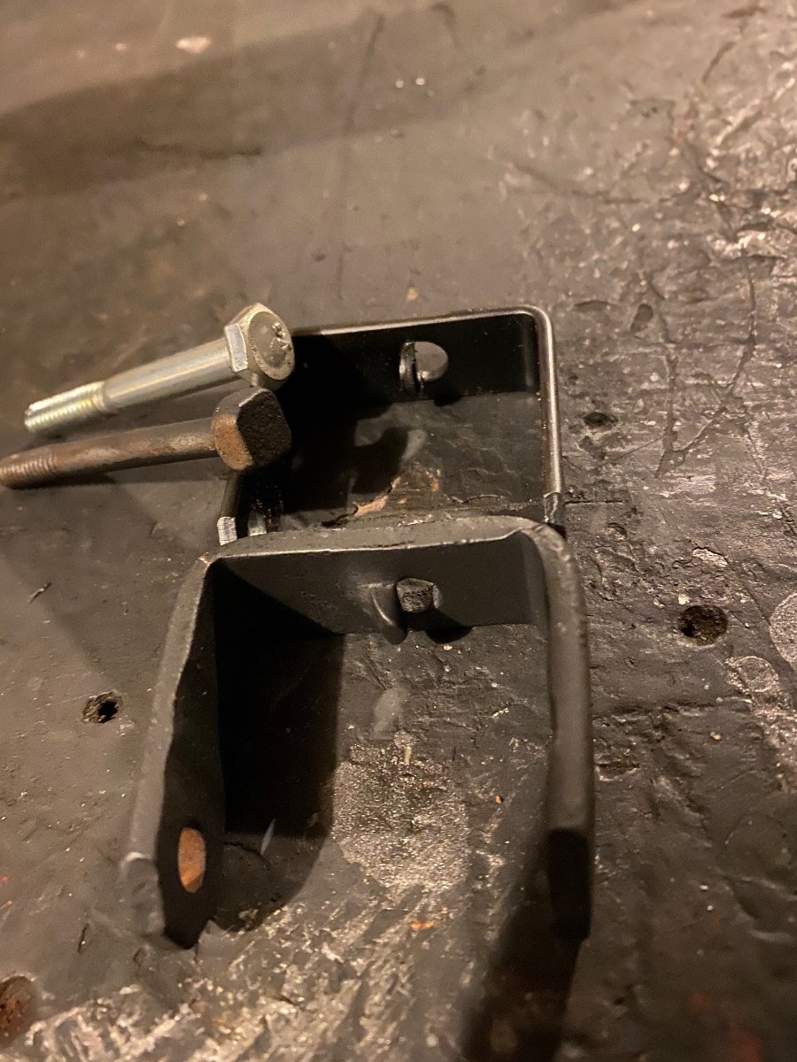

I thought the difference between the new spring clamps (that came with the new springs) and the original clamps, was noteworthy. The new ones looked to be about half the thickness of the old ones. I’ll be using the old ones.
I also chose to keep the old clamp bolts because they had square heads. Not sure if that's original or not, but I like the way they look.
Then off came a bit of the bolts and they were peened. Then the whole unit was painted flat black and left to dry.

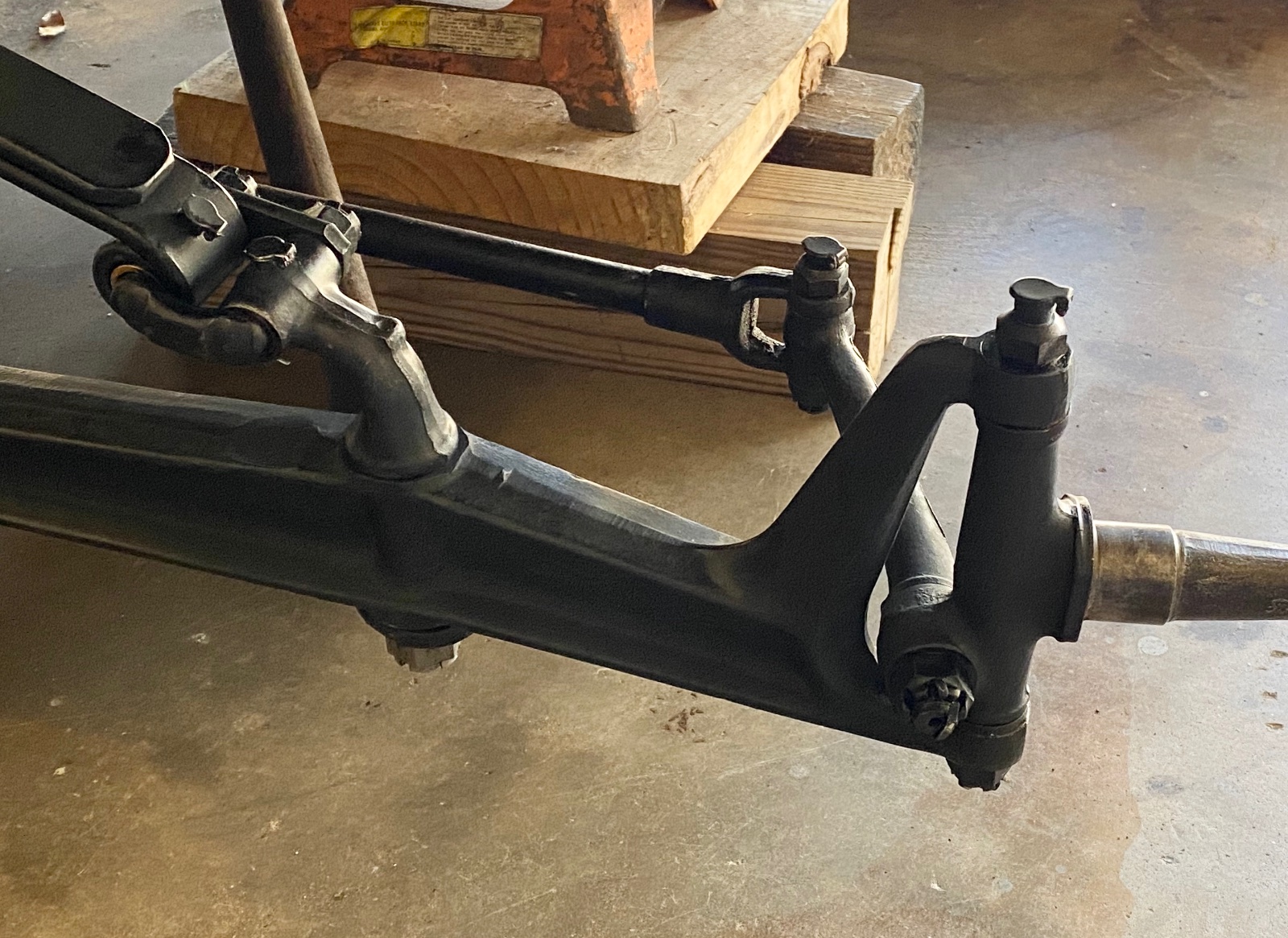

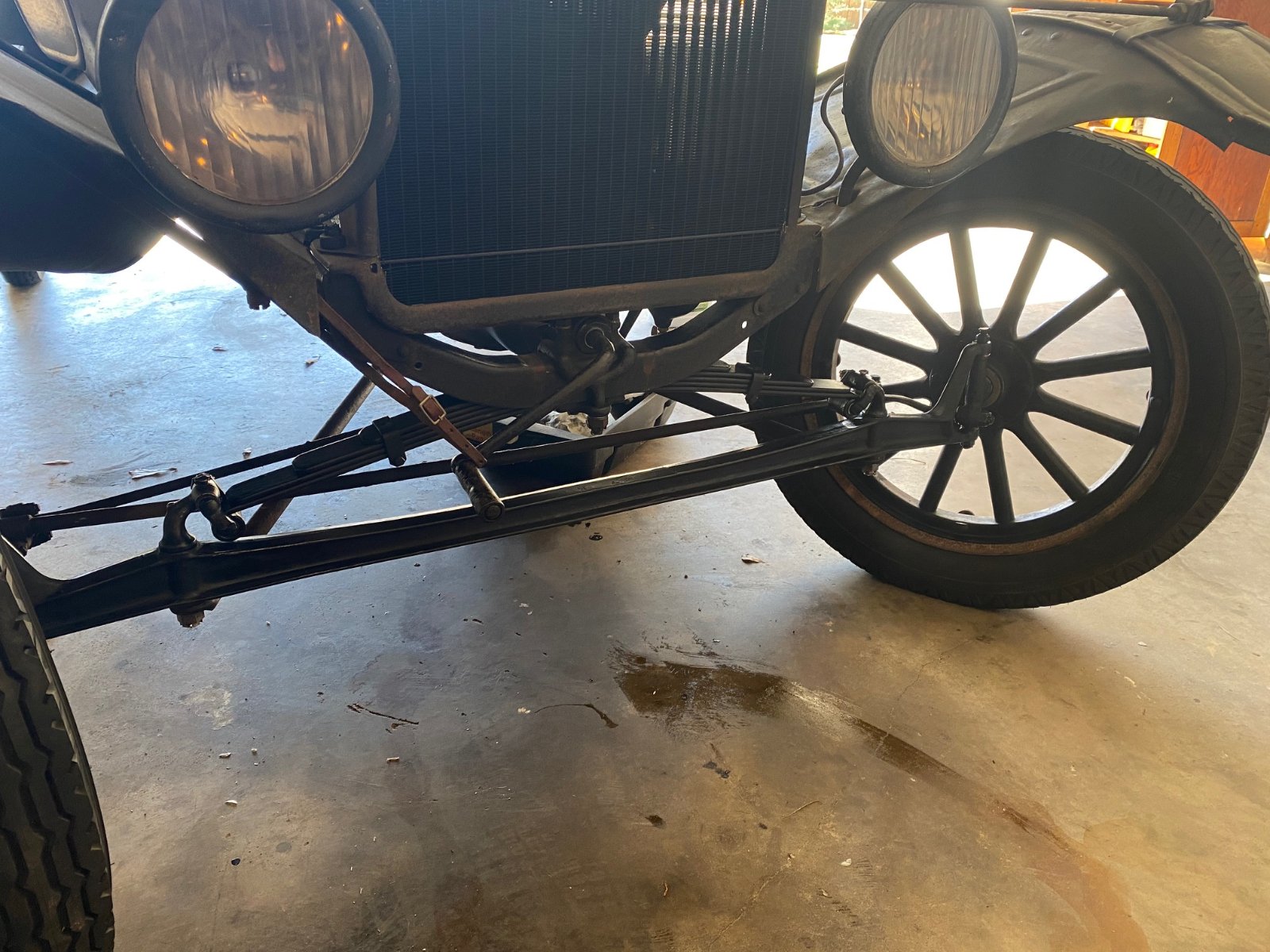

New front spring is bushed, treated with graphite, oilers installed, painted flat black and installed in the car with a new rubber pad.
Once I get the rebuilt axle back from Ross, I’ll be able to make the car mobile again.
I’m very interested to experience the difference in the car...going from a thoroughly abused, worn out and borderline dangerous front end to a fresh tight version.
If you have a sharp eye, you’ll notice that one of the radius rod ends is pretty worn. My parts chassis has a much better set that I’ll be swapping in.

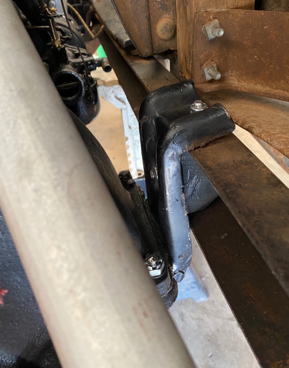

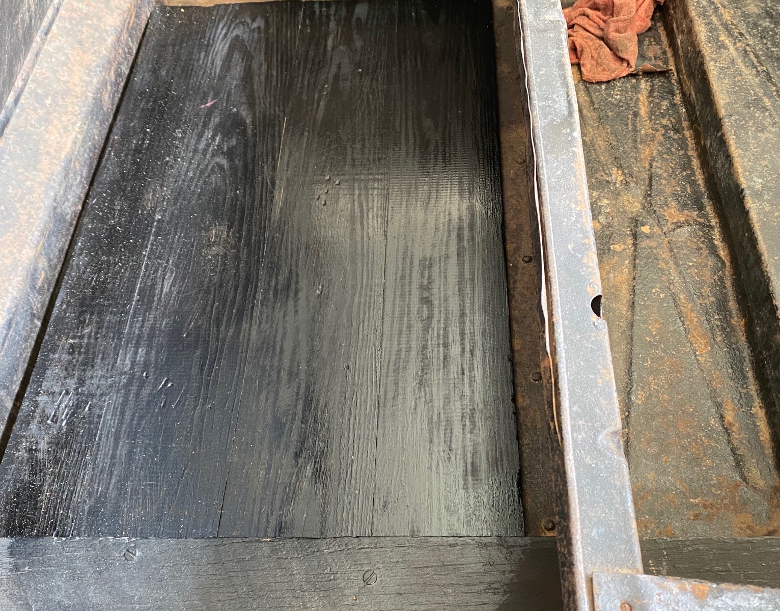

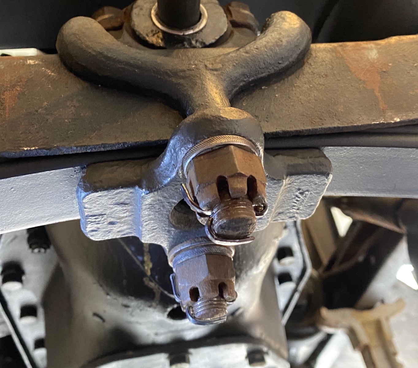

More little incremental progress while I wait for my axle to come back from Ross’s shop.
I finished the installation of the front spring. The original clamp cleaned up nicely. I like it when the Ford script shows on century old parts.

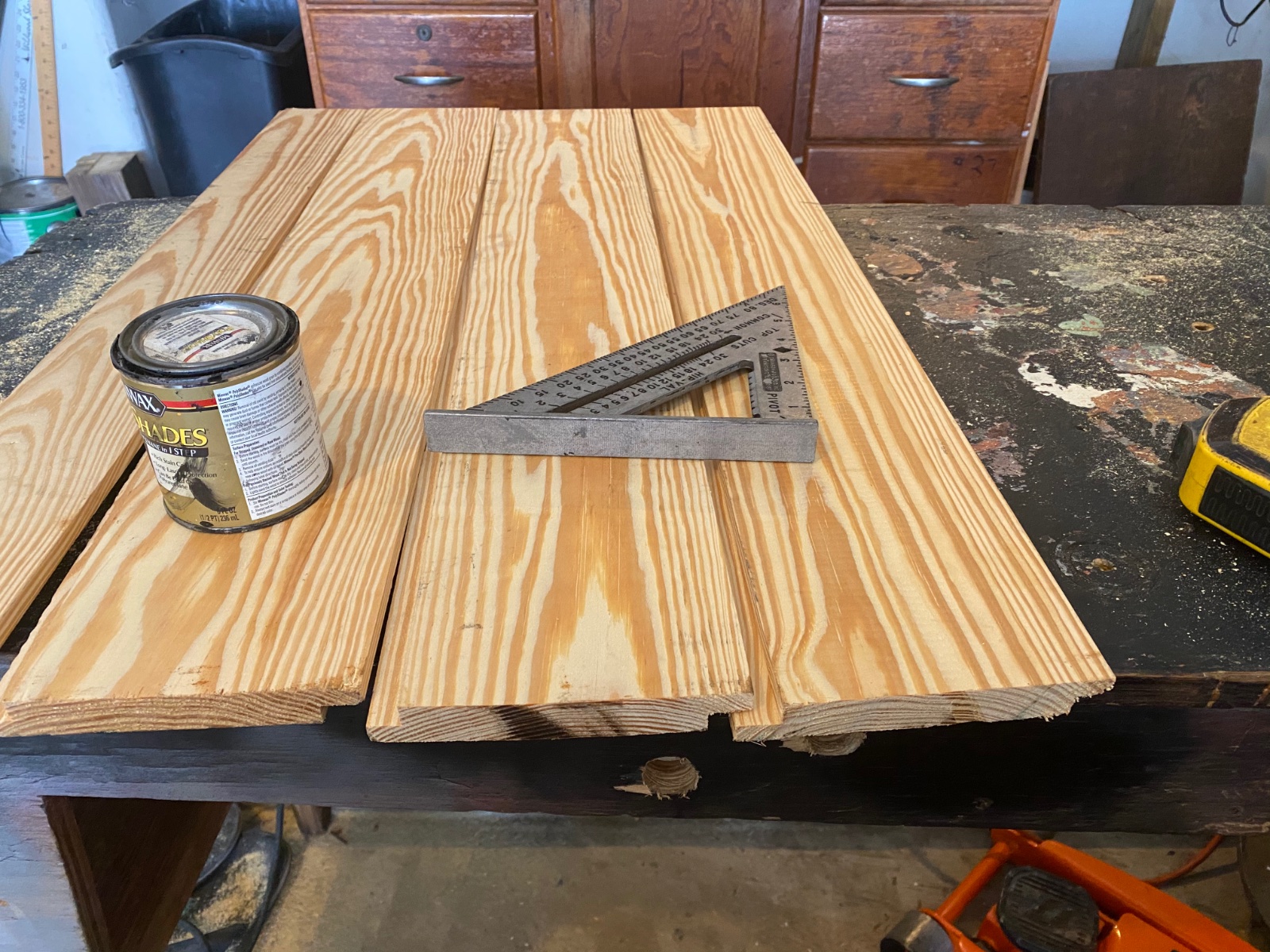

Then I tackled something on which I was procrastinating...the engine mount wood blocks. I was sure they were going to be a hassle. They weren’t. It was an easy job...although I did cheat a bit by using nylock nuts instead of cotter pins. The bolts are snugged, not tight...and the nylocks make that a much easier proposition. I’m obsessive about using period correct fasteners where they’ll easily show, but I’m making exceptions on things like this.

Then I cleaned up this accessory “belly band” engine support that came with my parts chassis. I’ve seen very nice versions but this one looks homemade. It looks like they took a piece of flat bar, bent it to the correct shape, then split it open in the middle. This piece would’ve had to have been made red hot then bent around a jig of some sort. I don’t see how one could’ve done so while under a car. Maybe they had another Model T pan to work with.
At first glance, it appears crude. But the more you look at it, the more you appreciate it.
On a high point restoration, this wouldn’t work. On this car, I think it fits right in.
It’s a testament to the fabricator’s skills that it fits so perfectly and installs so easily.

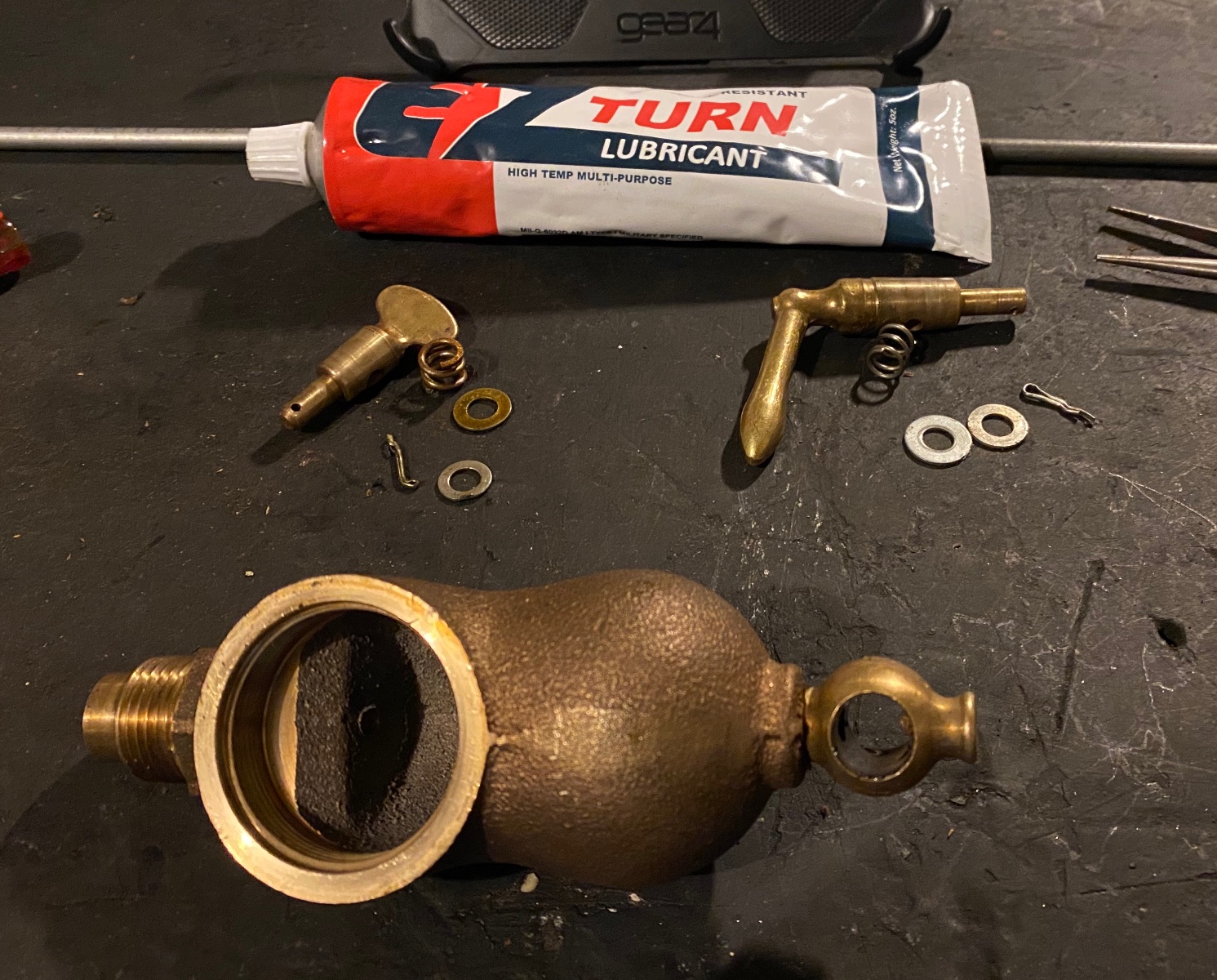

I finished off the day by disassembling the fuel bulb, cleaning it and reassembling with some EZ Turn Lubricant. This stuff is brilliant. The petcock was very stiff. Now it turns smoothly.

On a side note...
This will be my next project once the T is mostly finished.
I’ve had this nifty little trailer for a while. It was built in 1950 using parts from a ‘37 Ford. I rescued it from a building that was collapsing on my dad’s property.
The plan is to build an aluminum camper insert for it...something Art Deco inspired that’s streamlined. Just a one-man thing for swap meets.
I plan on fabricating aluminum ribs and riveting aluminum sheets to it...like an airplane.

I picked up the rebuilt front axle from Lilleker’s today.
New perches, bushings, steering arms, rebuilt spindles, helicoiled, reamed and straightened. It’s a thing of beauty.
Ross is a gift from God to the Model T hobby.
I asked him not to paint it, so that I can do that myself in flat black. I’ll do that tonight.

NEW PAINT????? Don I cant believe it!
RustyFords
- First Name: Don
- Last Name: Allen
- Posts: 2843
Thats a good looking axle! Just bustin your chops Don. I bit the bullet to.
RustyFords
- First Name: Don
- Last Name: Allen
Dallas Landers wrote: ↑Fri Jan 31, 2020 6:05 pmThats a good looking axle! Just bustin your chops Don. I bit the bullet to.
Thanks Dallas. I knew you were just messing with me....the same way I ribbed you for your fancy sandblasted and painted frame.

Most of the components that are rebuilt on this car are painted flat black.
At shows, I’m often asked what has been rebuilt and I answer with , “if it’s painted flat black, it’s been gone through or rebuilt”.
The flat black blends nicely with the old weathered paint but the fact that I can use it as an identifier at gatherings has turned out to be a nice added benefit.
Now it’s all of the suspension, axles and drivetrain.
With everything so worn out and loose, the front axle, spring and steering cane apart really easy. Now that everything is new and tight, it’s putting up a fight.
I’m getting all the connections started first, then everything will get tightened and cotter pins installed.
1924 Touring
- Posts: 6798
Don
I see your spindle arm already (still) cotter pinned. Mistake. If you remove the tie rod from first one spindle arm or the other you will invariably find the arm is twisted and the radius rod will not swing over the opposite arm freely. This is overlooked in the vast majority of rebuilds, causes tight steering and rapid wear of tie rod pins and bushings. It is a rare spindle where I do not have to loosen and rotate slightly to get things to line up and swing freely.
RustyFords
- First Name: Don
- Last Name: Allen
Thanks Scott. That’s the way it came when I picked it up at Lilleker’s. Your logic is sound though. I’ll take them loose so that they can find their natural positions, then finish connecting, tightening and cotter pinning.Scott_Conger wrote: ↑Sat Feb 01, 2020 2:25 pmDon
Knowledge and advice like this is one of the reasons I love this forum.
I always wondered if the spindle arms were somehow "indexed" to the spindles, now I know they aren't and have to be allowed to find their correct twist before tightening and cotter pinning the nuts. Thanks!
- Posts: 6798
Don
don't loosen until proven to be twisted. Ross may have a jig or has already done this for you. Trying to loosen some of these can take you to your own special hell, so if there's a chance Ross did this, find out first. I somehow thought you had done the work and just wanted to save your new bushings from possible early wear.
RustyFords
- First Name: Don
- Last Name: Allen
I loosened the driver’s side arm and it immediately rotated a little bit and corrected itself. The passenger side didn’t do much at all. I then turned the steering lock to lock several times and then retightened the arms.Scott_Conger wrote: ↑Sat Feb 01, 2020 6:35 pmDon
I’m not sure if Ross meant for me to adjust them or not.
1924 Touring
- Posts: 6798
Well, in any event, you just did. You're good to go.

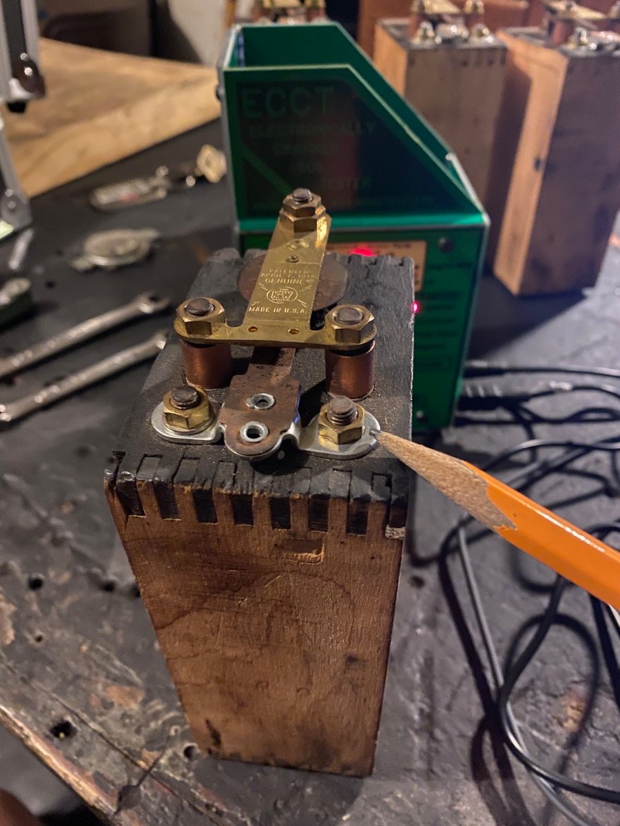

Spent the weekend completing several small tasks on the T as I get it put back together and ready for a year of action. I tightened up and rechecked all the connections on the front axle/steering installation then cotter pinned it all and packed the wheel bearings and installed the front wheels.
I changed the oil and coolant and while the coolant was drained, I removed the top radiator hose and reinstalled it after smearing some RTV on the inside of the hose and water necks. There was a small, persistent leak coming out of that hose that I couldn't stop no matter how tight I adjusted the clamps.
I also finished installing an OEM style fuel line with original fittings and new rubber gaskets. There was a small persistent fuel leak coming out of the connections at both the carburetor and and fuel bulb. The fuel line that came with the car was a modern style flared line and it wasn't sealing properly.
I know that Model T's leak a little bit, but where possible, I'll chase down leaks and stop them.
Last but not least, I tracked down the issue with one of my coils. The nuts holding the lower points had come loose, causing the lower point contact to move over enough to prevent proper contact. It was a quick fix.

Today’s project was setting the toe-in or “gather” as Ford called it, With all new components on the front axle, the toe-in was way off. Adjusting it only involves taking the drag link and one spindle arm loose and turning the tie-rod yoke in or out.
But, the yoke wasn’t budging, so out came the tie-rod. It was good n’ stuck so I heated it with a torch then dunked it in a 50/50 mixture of ATF and acetone and left it submerged for an hour. That did the trick.
It then got wire wheeled, painted flat black and reinstalled.
Old Henry makes me grin with his obsessive stamping of his name on everything on these cars...even the dang tie-rod!
I noticed my parts chassis has one of these little Apco gizmos on the drag link connection. I may clean it up and use it.

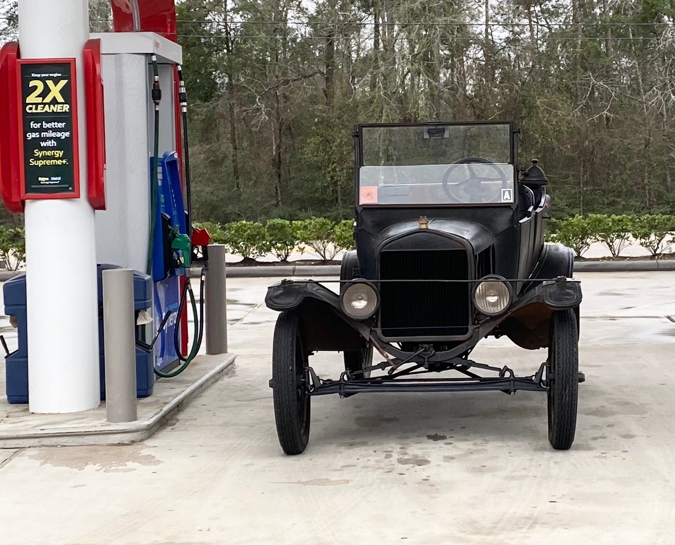

Got the T back on the road today. All the work on the front axle was well worth it. The suspension feels great and the steering is tight. Here’s a link to a short video of the first drive today.

Been enjoying the heck out of this wonderful little Flivver since the rebuilt front axle was installed and haven't really done much to it since then.
But I'm about to jump back in and tackle some more wood work in the doors and work on getting an interior put in it.
I keep going back and forth in my mind about correcting the "cock-eyed" look it has due to the driver's side headlight stalk being bent. Actually the whole front fender on that side, fender brace, etc is bent as well. All due to hard use on the farm. I'm leaning (pun intended) towards leaving it as is. It's part of the car's story and charm.
Another random note: I was shocked at how much camber it has now that the axle and spindles are rebuilt. It looks like too much compared to a modern car, but according to the manual it is correct.
My goodness I love this car.

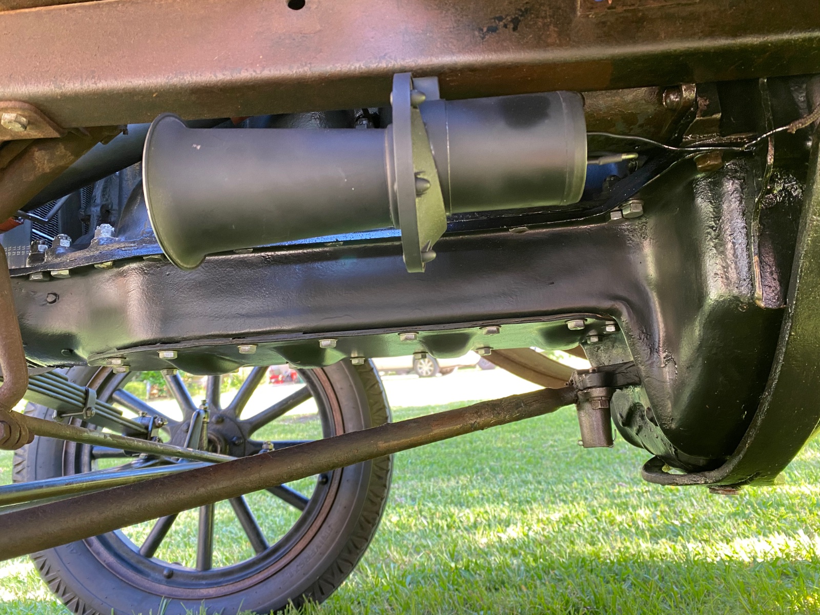

My T came with a hole in the dashboard to the left of the steering column. I found an antique horn button on eBay that was exactly the same size as the hole.
I also wanted a Model A style ahooga horn for this car so I figured the hole and button would be for the ahooga horn.
The Summit Racing website had a cheap one that was 12V but I guessed that it would run just fine on 6V...just slower. I painted it flat black and installed it today and am pleased with it.
Here are some photos and a video of it.
https://youtu.be/nDUNoyazgMQ

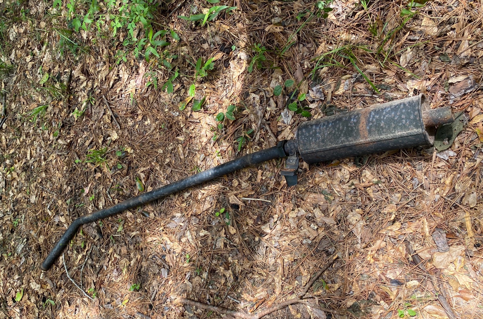

I harvested the solid old exhaust pipe and muffler from my parts chassis. This chassis used to be a '25 coupe that was last driven in the early 60's...so the exhaust is at least that old.
It's in decent shape and seems to be better quality than the new reproduction stuff currently on my car. The muffler is noticeably different...much heavier metal.
So...I'll be swapping them out in the near future.

New rear floorboard in place. I’m happy with it.
Now I need to haul some kids around to scuff it up and it'll look more at home.

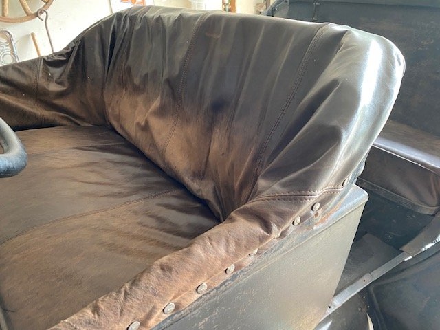

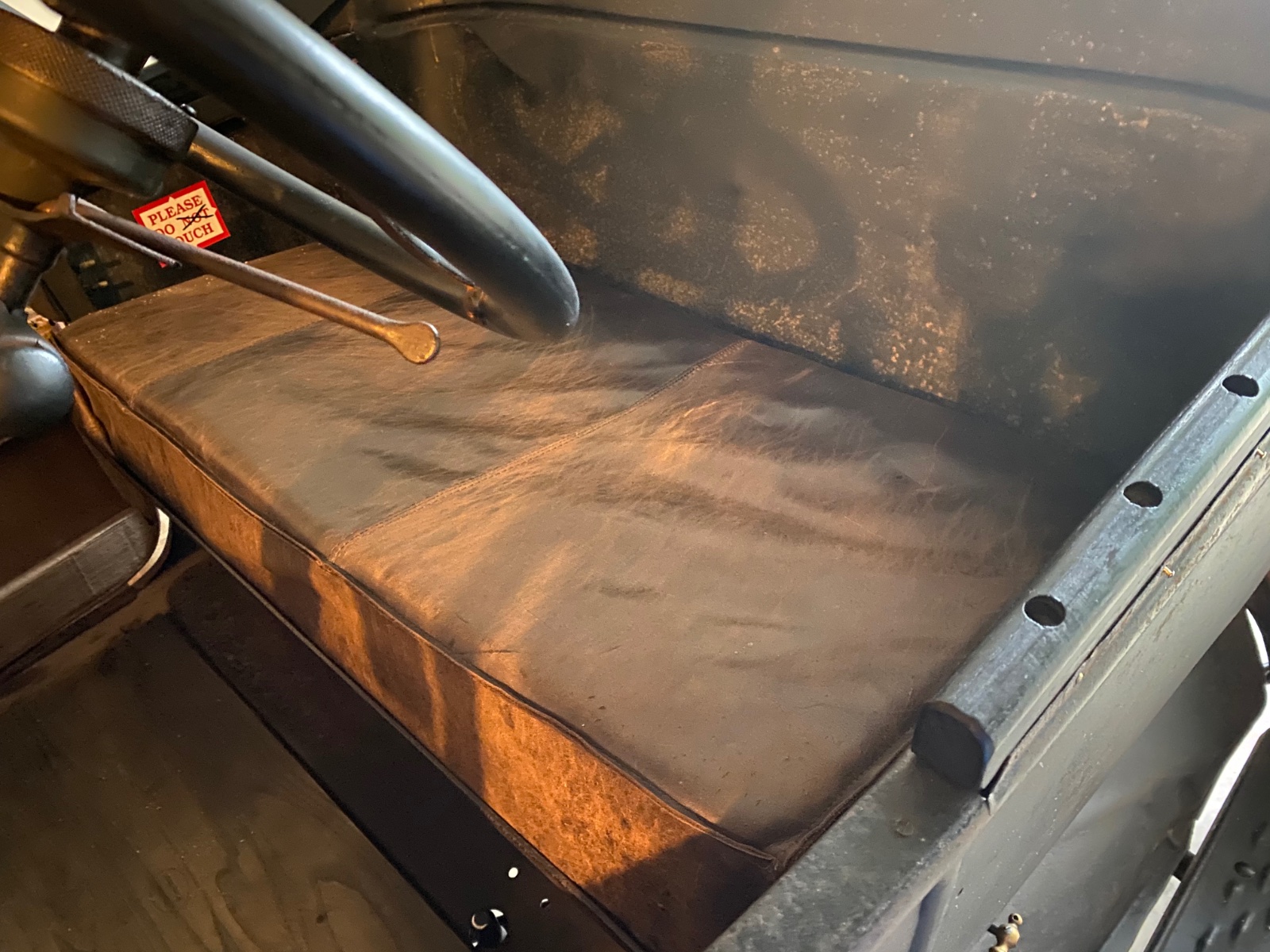

Another big step forward today. I started in on the interior.
I recently found these free leather couches online and cut away the first section for the front, bottom seat covering. I made a perimeter out of 1/4 inch plywood and wired it to the spring. Then I attached the leather to the wood with a staple gun.

Don, I cant help but think about the leather on the couch. Oh no butcherd again!
Looks good and I bet its soft to. Has a nice worn look to it.

Thanks Dallas. It is a nice, thick soft leather.Dallas Landers wrote: ↑Sun May 24, 2020 6:20 pmDon, I cant help but think about the leather on the couch. Oh no butcherd again!

Latest photo of the 24.
The plan for the weekend is to make more progress with the upholstery.

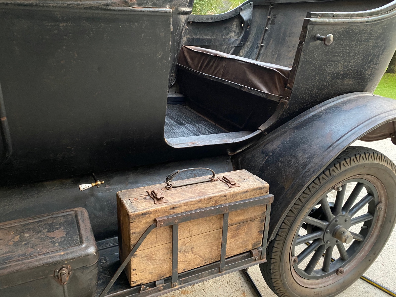

The box currently only has oil in it. But I’m looking for an appropriate container for gas that’ll fit in the box. John Mays gave it to me and I love the look of it.
And thanks! I’m having so much fun with this car. I was at a gas station last week and I counted an even dozen people standing around the car as I answered questions about it...all smiling and having a great time.

Several of you who've followed this thread have commented on this 66 F100 shortbox that's been in the background in several photos.
This rust-free, original paint, Texas truck is for sale. $17,500. It's truly exceptional. I'm not sure you could find another one like this without a lot of effort. These mid-60's shortboxes are redhot right now.
Mildly hopped up (four barrel carb and split exhaust manifolds and a mild cam).

This week’s main focus will be woodwork. The budget won’t allow me to order wood kits for the two doors that need it so I’ll have to make it myself.
Woodworking is not my strong suit, a fact made worse by my lack of a table saw. The door wood has some interesting curves that having me scratching my head...kind of like the big tack strips did.

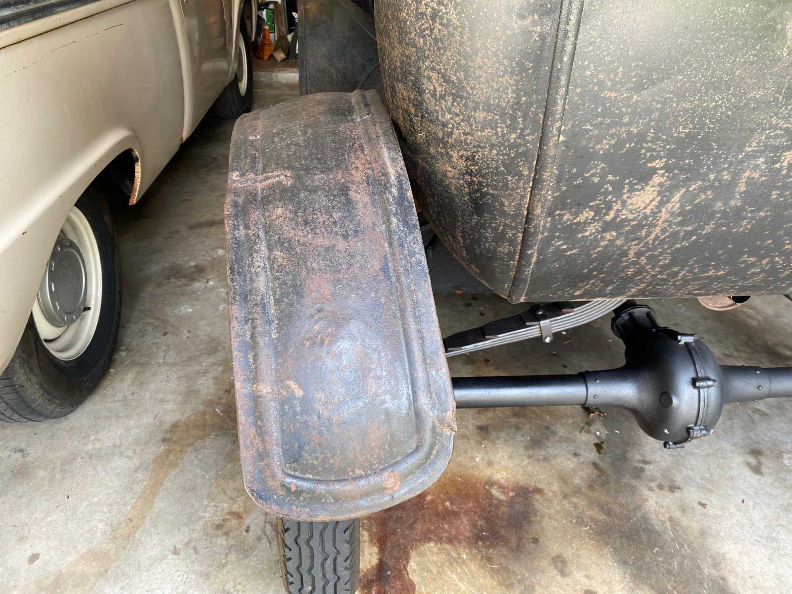

The driver's side rear fender on the 24 was sitting at a skewed angle...almost certainly a consequence of multiple things and people using it as a shelf or step back in the day.
You can see the degree to which it was out of whack by how the fender mounting rod was sitting in the hole in the rear tub.
I removed the fender then took a long pipe I use as a leverage/cheater bar, slipped it over the fender mounting rod and bent it back to a more reasonable approximation of where it should be.
The end result wasn't perfect, but it is a lot better than these "before" photos show. It was too dark for "after" photos.
I'm working on getting everthing done in the rear tub that will be covered by upholstery so I can install the rest of my weathered old-couch leather. You can see some of the leather on the bottom seat cushion in the photo below. I'm pretty happy with how it's turning out and have had some nice compliments on it lately.
A random person at the local convenience store asked if the leather was original to the car. I told her no, of course. But the fact that she asked is an indication that I might be over the target with the way it looks. The mottled browns of the leather are playing nicely off of the similar colors in the paint.

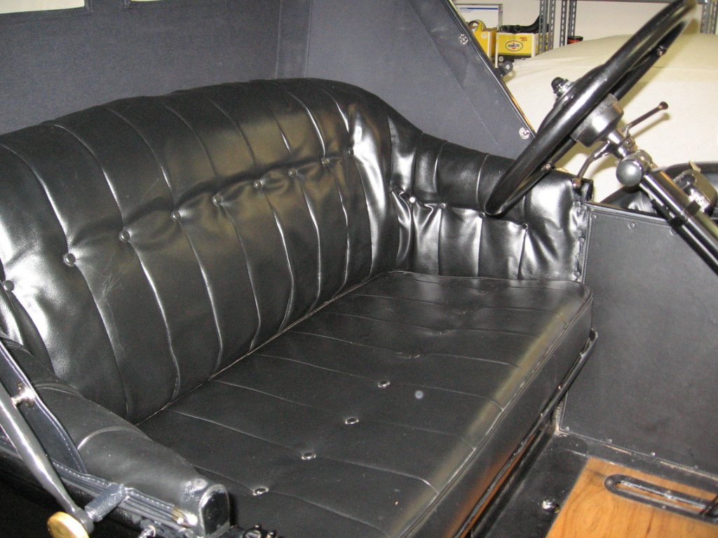

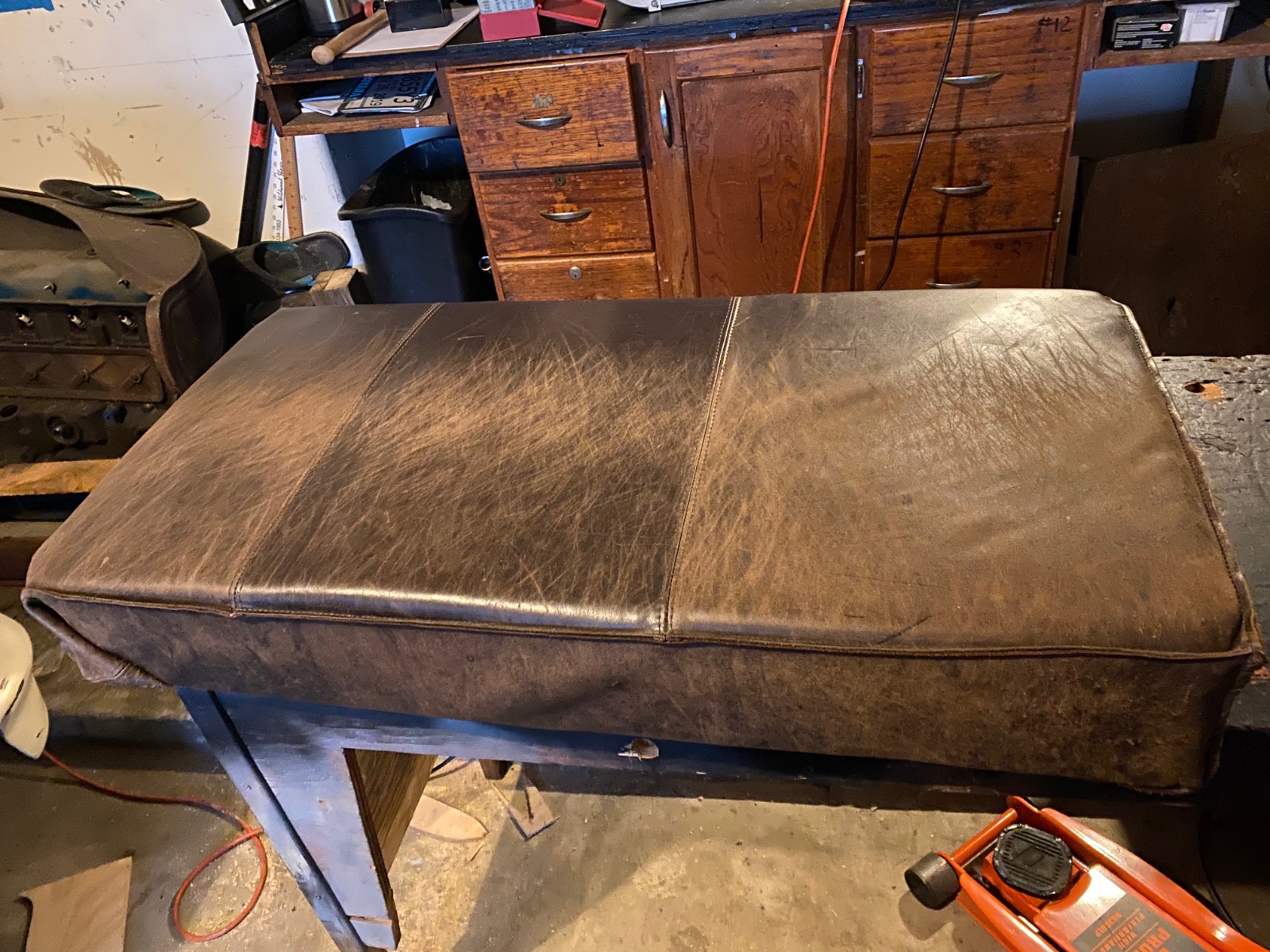

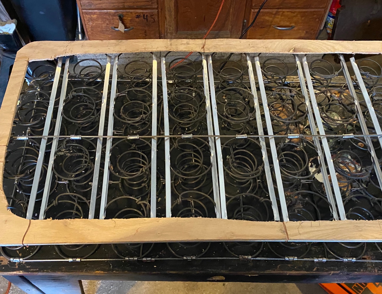

More upholstery work on the T....using the old leather couch that I scrounged, for the material.
I ripped the factory couch seams in a place that I thought would sort of match the contours of the front seat bucket and then draped it over the area. It's just loosely laying there and there's a lot of adjustment to be made but I'm pleased with how this first attempt at making it fit looks.
The springs/stuffing have yet to be installed. I may have to untack it partially to get that done, but that should be easy to do.
1924 Touring
- Posts: 2549
- Last Name: Strange
- Location: Hillsboro, MO
- Board Member Since: 2013
Neat idea using old couch upholstery! Are you going to install any buttons?
If you have enough material on the sides, you can put in some pleats to more closely match the factory look. The attached picture is my first attempt using a Cartouche kit that came with my 1924 cut-off touring when I bought it. If I had it to do over again, I would add more padding, the kit didn't come with enough to fully fill out the pleats. I rearranged what I had the best I could, but it still came out a little "thin in the skin".
RustyFords
- First Name: Don
- Last Name: Allen
Thanks MarkCudaMan wrote: ↑Mon Jul 27, 2020 2:52 pmNeat idea using old couch upholstery! Are you going to install any buttons?
If you have enough material on the sides, you can put in some pleats to more closely match the factory look. The attached picture is my first attempt using a Cartouche kit that came with my 1924 cut-off touring when I bought it. If I had it to do over again, I would add more padding, the kit didn't come with enough to fully fill out the pleats. I rearranged what I had the best I could, but it still came out a little "thin in the skin".![]()
I think some buttons would be a great idea. And I like your thoughts about the sides. There is plenty of baggy material.
The constant challenge that I face with this “Great Depression Tribute” car is the urge to overdo things. The question I ask myself a lot is, “how would my grandparents have repaired this car back in 1935-45 with very limited funds to keep it going while keeping it safe and comfortable?’
1924 Touring

I shouldn't as it's late but holy crap! I bet it's very comfortable already!
Thanks to people like you and other good-scroungers (one of our Mark's!), I look for leather couches around here...
I'll get you my pretty! Eh hem, leather.
