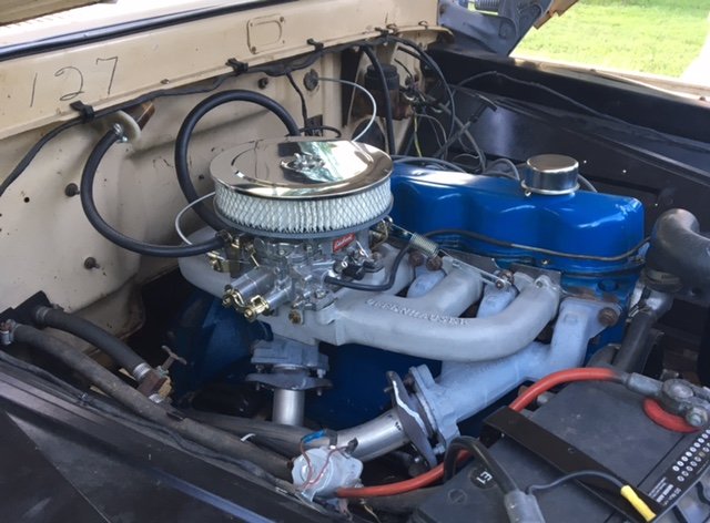

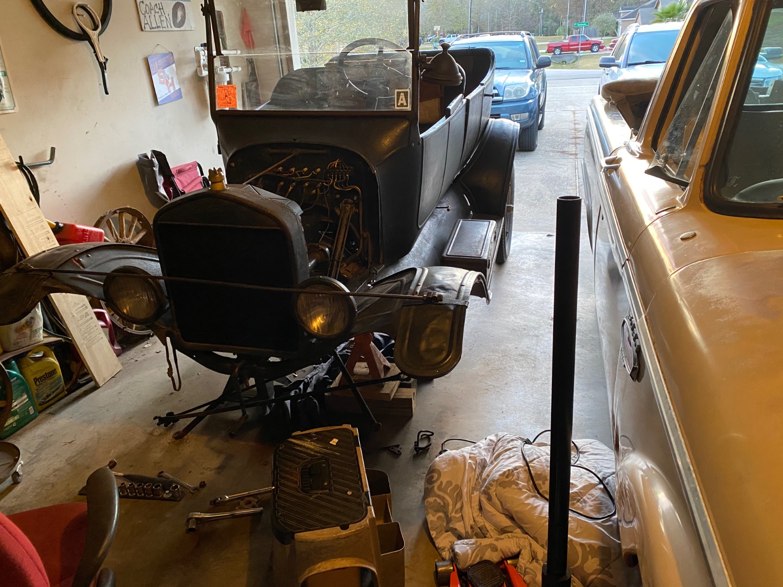

Is that yellow object in 1 of the pics a Unibody Ford pickup?
Topic author - Posts: 1559
- First Name: Don
- Last Name: Allen
- Location: Houston, TX
Re: 24 Touring Barn Car Revival - Part 3
Mack...it’s a 66 F100 Styleside (shortbed). Original paint 79k miles. 300 straight six that I hopped up a little bit.

New front spring is bushed, treated with graphite, oilers installed, painted flat black and installed in the car with a new rubber pad.
Once I get the rebuilt axle back from Ross, I’ll be able to make the car mobile again.
I’m very interested to experience the difference in the car...going from a thoroughly abused, worn out and borderline dangerous front end to a fresh tight version.
If you have a sharp eye, you’ll notice that one of the radius rod ends is pretty worn. My parts chassis has a much better set that I’ll be swapping in.

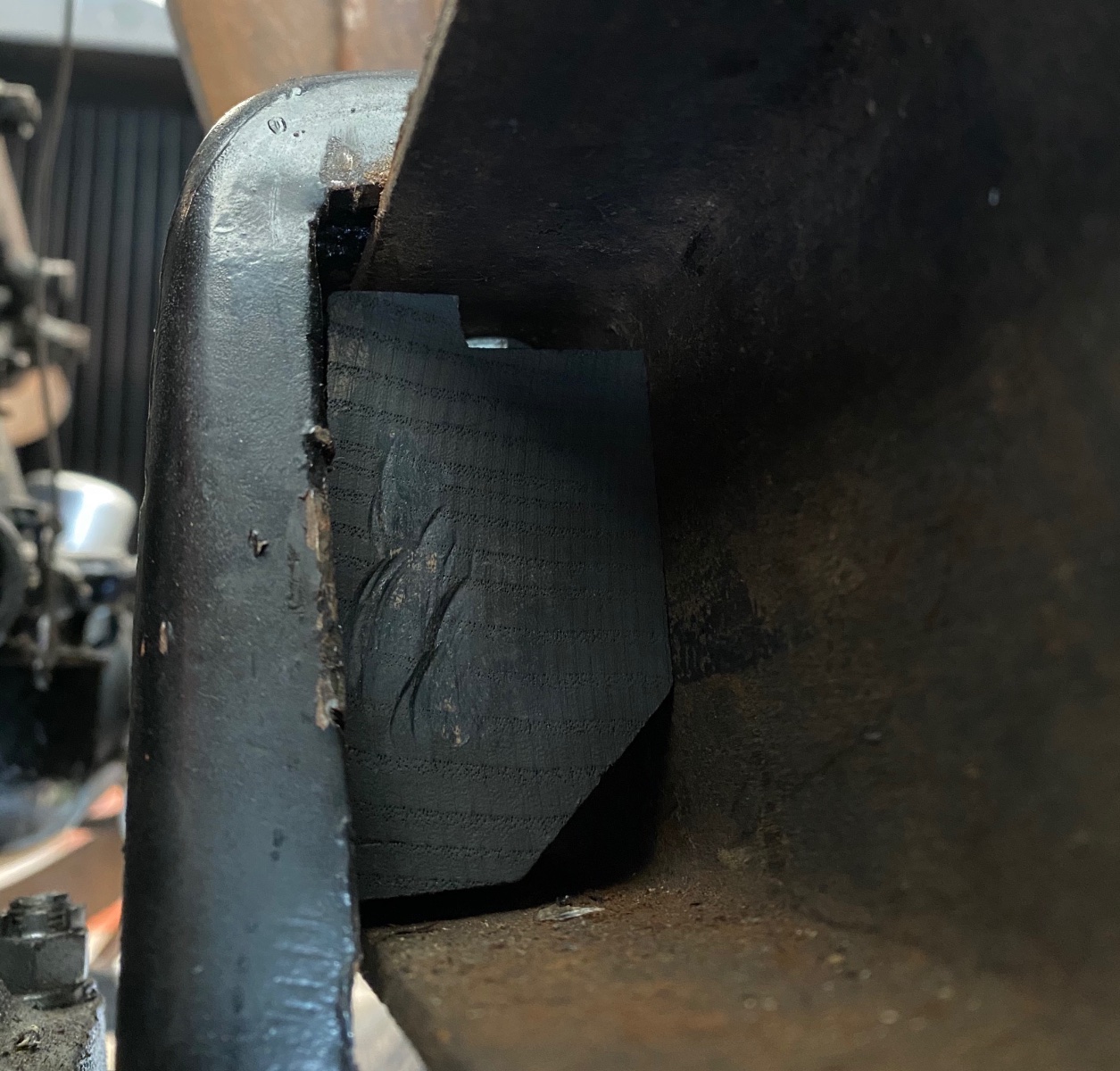

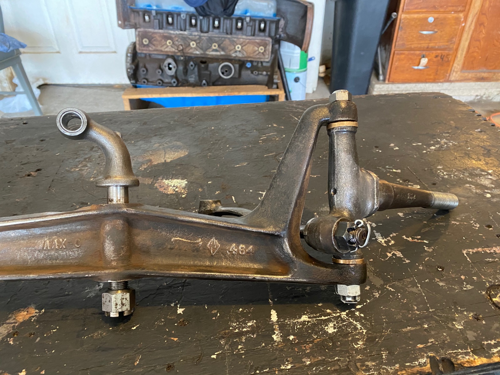

More little incremental progress while I wait for my axle to come back from Ross’s shop.
I finished the installation of the front spring. The original clamp cleaned up nicely. I like it when the Ford script shows on century old parts.
Then I tackled something on which I was procrastinating...the engine mount wood blocks. I was sure they were going to be a hassle. They weren’t. It was an easy job...although I did cheat a bit by using nylock nuts instead of cotter pins. The bolts are snugged, not tight...and the nylocks make that a much easier proposition. I’m obsessive about using period correct fasteners where they’ll easily show, but I’m making exceptions on things like this.

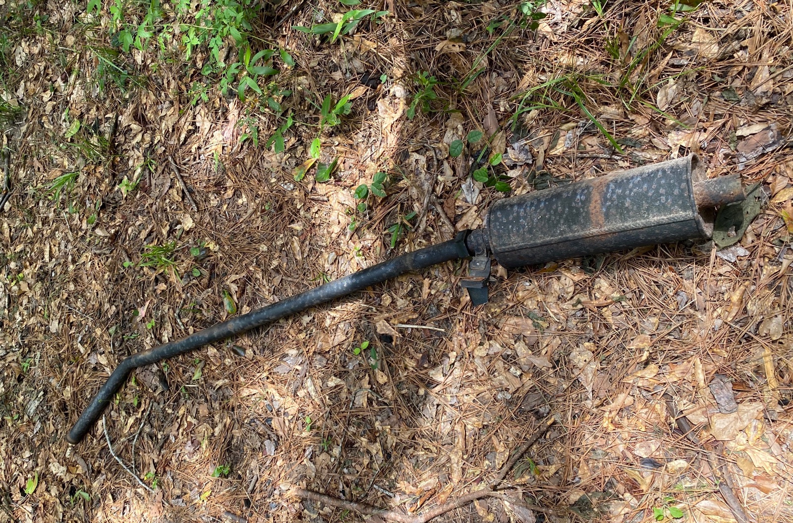

It’s a testament to the fabricator’s skills that it fits so perfectly and installs so easily.
At first glance, it appears crude. But the more you look at it, the more you appreciate it.
On a high point restoration, this wouldn’t work. On this car, I think it fits right in.

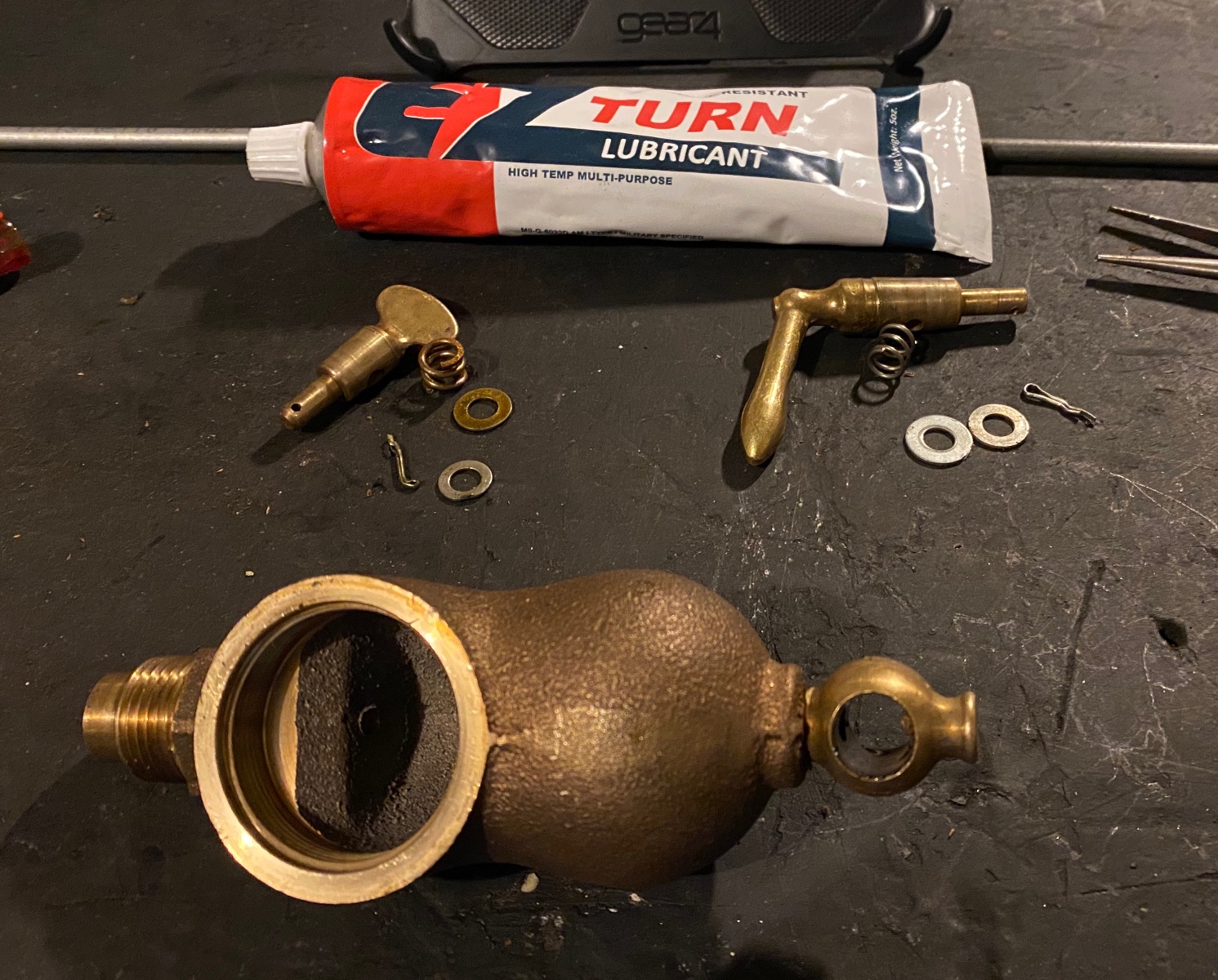

I finished off the day by disassembling the fuel bulb, cleaning it and reassembling with some EZ Turn Lubricant. This stuff is brilliant. The petcock was very stiff. Now it turns smoothly.

I picked up the rebuilt front axle from Lilleker’s today.
New perches, bushings, steering arms, rebuilt spindles, helicoiled, reamed and straightened. It’s a thing of beauty.
Ross is a gift from God to the Model T hobby.
I asked him not to paint it, so that I can do that myself in flat black. I’ll do that tonight.

With everything so worn out and loose, the front axle, spring and steering cane apart really easy. Now that everything is new and tight, it’s putting up a fight.
I’m getting all the connections started first, then everything will get tightened and cotter pins installed.
1924 Touring
- Posts: 6600
Don
I see your spindle arm already (still) cotter pinned. Mistake. If you remove the tie rod from first one spindle arm or the other you will invariably find the arm is twisted and the radius rod will not swing over the opposite arm freely. This is overlooked in the vast majority of rebuilds, causes tight steering and rapid wear of tie rod pins and bushings. It is a rare spindle where I do not have to loosen and rotate slightly to get things to line up and swing freely.
- First Name: Don
- Last Name: Allen
Thanks Scott. That’s the way it came when I picked it up at Lilleker’s. Your logic is sound though. I’ll take them loose so that they can find their natural positions, then finish connecting, tightening and cotter pinning.Scott_Conger wrote: ↑Sat Feb 01, 2020 2:25 pmDon
Knowledge and advice like this is one of the reasons I love this forum.

I always wondered if the spindle arms were somehow "indexed" to the spindles, now I know they aren't and have to be allowed to find their correct twist before tightening and cotter pinning the nuts. Thanks!
- Posts: 6600
Don
don't loosen until proven to be twisted. Ross may have a jig or has already done this for you. Trying to loosen some of these can take you to your own special hell, so if there's a chance Ross did this, find out first. I somehow thought you had done the work and just wanted to save your new bushings from possible early wear.
- First Name: Don
- Last Name: Allen
I loosened the driver’s side arm and it immediately rotated a little bit and corrected itself. The passenger side didn’t do much at all. I then turned the steering lock to lock several times and then retightened the arms.Scott_Conger wrote: ↑Sat Feb 01, 2020 6:35 pmDon
I’m not sure if Ross meant for me to adjust them or not.
1924 Touring
- Posts: 6600
Well, in any event, you just did. You're good to go.

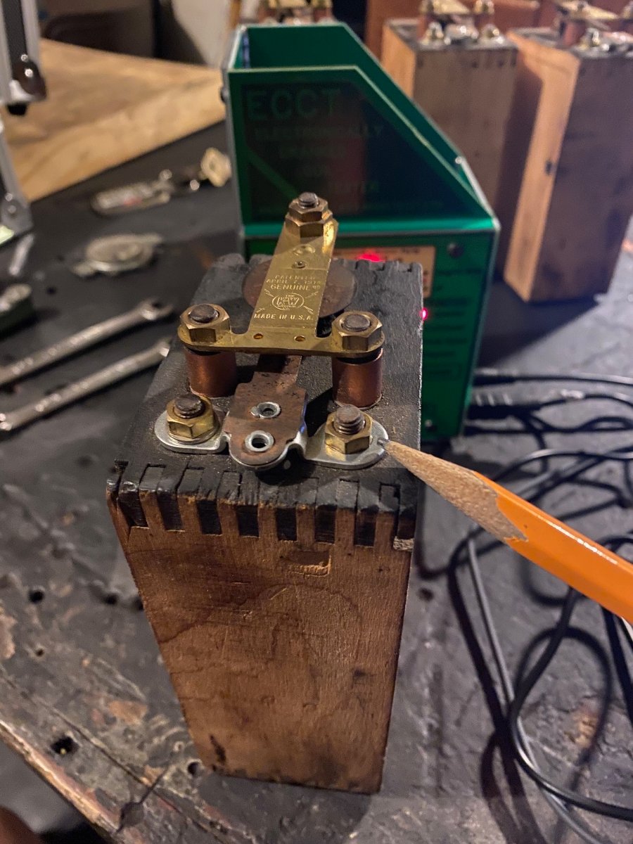

Last but not least, I tracked down the issue with one of my coils. The nuts holding the lower points had come loose, causing the lower point contact to move over enough to prevent proper contact. It was a quick fix.
I changed the oil and coolant and while the coolant was drained, I removed the top radiator hose and reinstalled it after smearing some RTV on the inside of the hose and water necks. There was a small, persistent leak coming out of that hose that I couldn't stop no matter how tight I adjusted the clamps.
I also finished installing an OEM style fuel line with original fittings and new rubber gaskets. There was a small persistent fuel leak coming out of the connections at both the carburetor and and fuel bulb. The fuel line that came with the car was a modern style flared line and it wasn't sealing properly.
I know that Model T's leak a little bit, but where possible, I'll chase down leaks and stop them.

I harvested the solid old exhaust pipe and muffler from my parts chassis. This chassis used to be a '25 coupe that was last driven in the early 60's...so the exhaust is at least that old.
It's in decent shape and seems to be better quality than the new reproduction stuff currently on my car. The muffler is noticeably different...much heavier metal.
So...I'll be swapping them out in the near future.

Several of you who've followed this thread have commented on this 66 F100 shortbox that's been in the background in several photos.
This rust-free, original paint, Texas truck is for sale. $17,500. It's truly exceptional. I'm not sure you could find another one like this without a lot of effort. These mid-60's shortboxes are redhot right now.
Mildly hopped up (four barrel carb and split exhaust manifolds and a mild cam).
