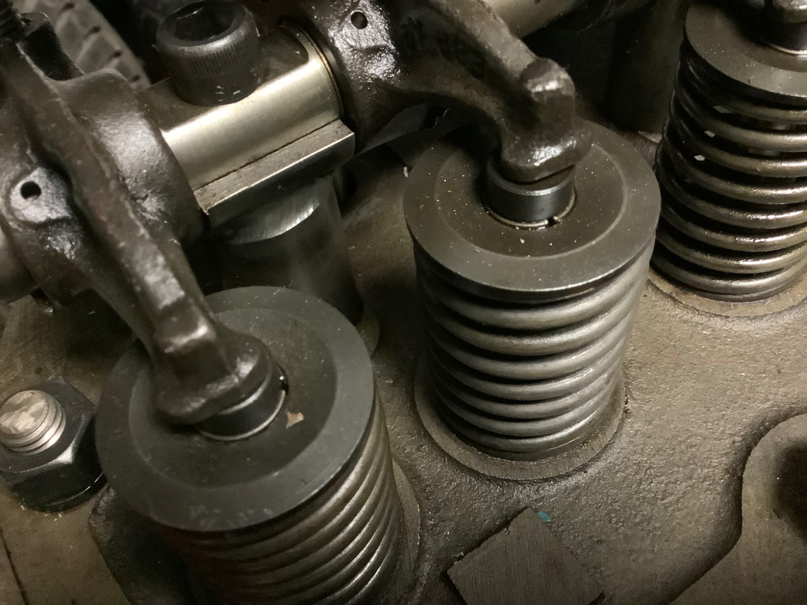

Well, I went an did it. I found a reasonably priced Frontenac head. It's a single port "T" model. Appears to be in fine shape. Used to belong to Tom Moore from Mass. The only thing is, It does not have any rocker arms.
Now I'm a pretty resourceful kinda of guy. And being versed in V-8 performance engines, thus, the wheel are turning in my head of a solution or two. But there must be something out there besides the uber hard to find originals that can be used. I'd like to stick with a 1.5 ratio, but more importantly for me, I just need the right spacing between the pushrod end and the valve tip end...which happens to be about 2-3/4". The '28 Chevy rockers are too long. A big block chevy is a a smidge to short. It was suggest MGB rockers would fit, they are way to short.
So is anyone into other engines that have rocker arms they can measure for me? Or has anyone bought a head and found some rockers that can work or be made to work? I'd prefer a shaft mount, but I can easily make a stud mount (like a typical small block chevy)
Thank You
Thank You

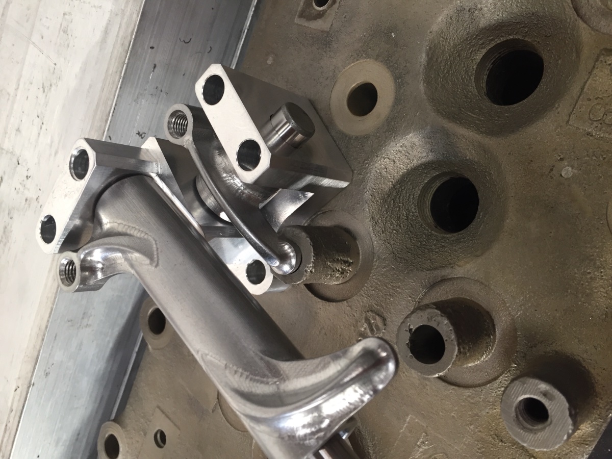

Y block rockers are simply one suggestion. You don’t have to go the easy route... Could always make what you need from scratch

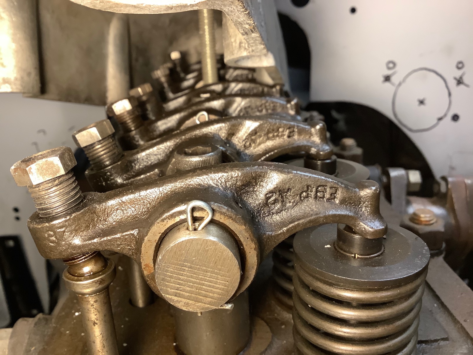

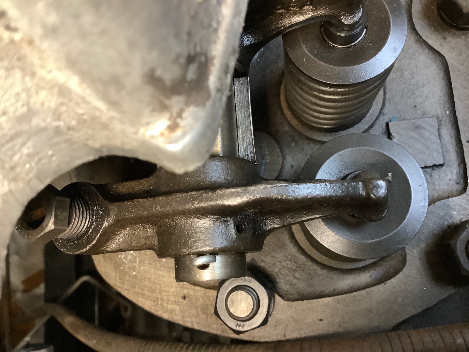

Chad I’ll post some pics tomorrow. I used a set that Jack Daron made up before he passed. He used to sell a lot of them. I’m not sure they are what Hank mentioned , but possibly so. Going from memory, we needed to use a small cap between the rocker arm and lifter that are made to revolve, used when things don’t exactly line up. T

Beautiful Work as always Kevin!

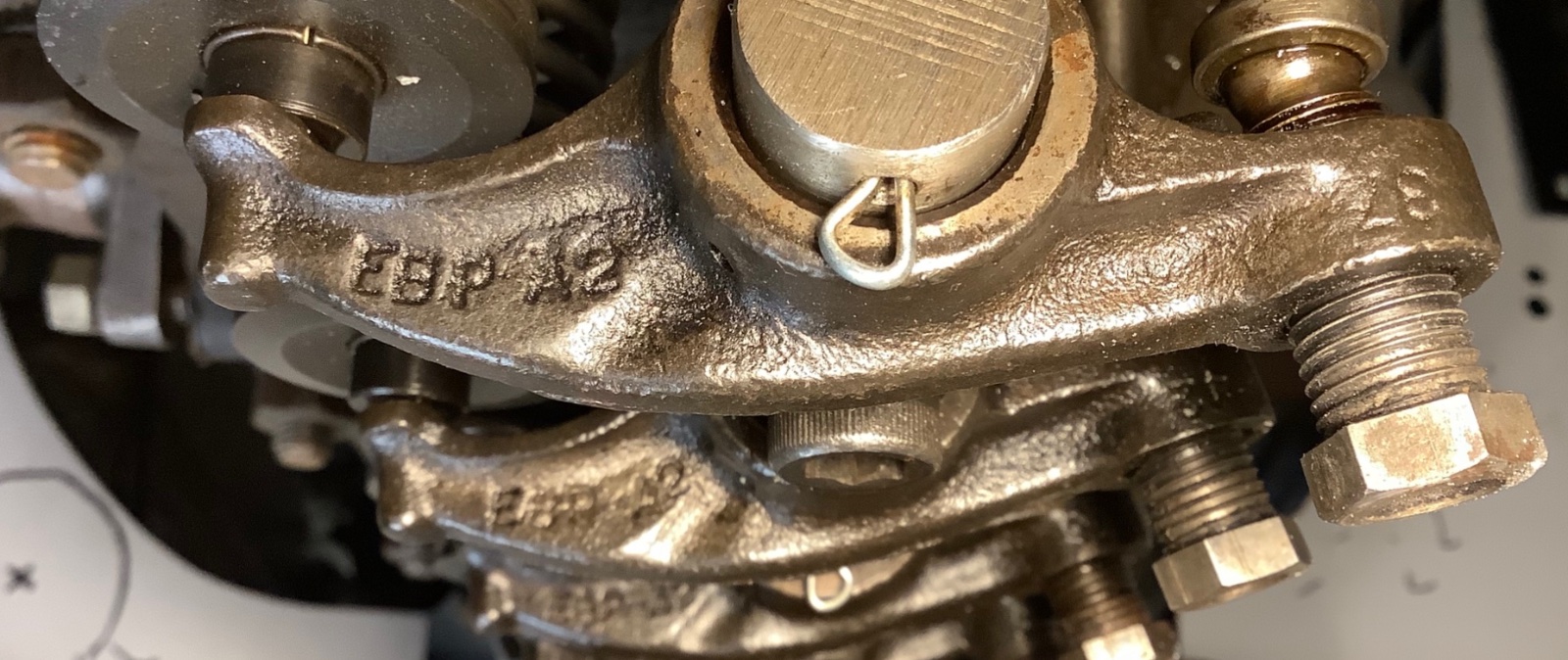

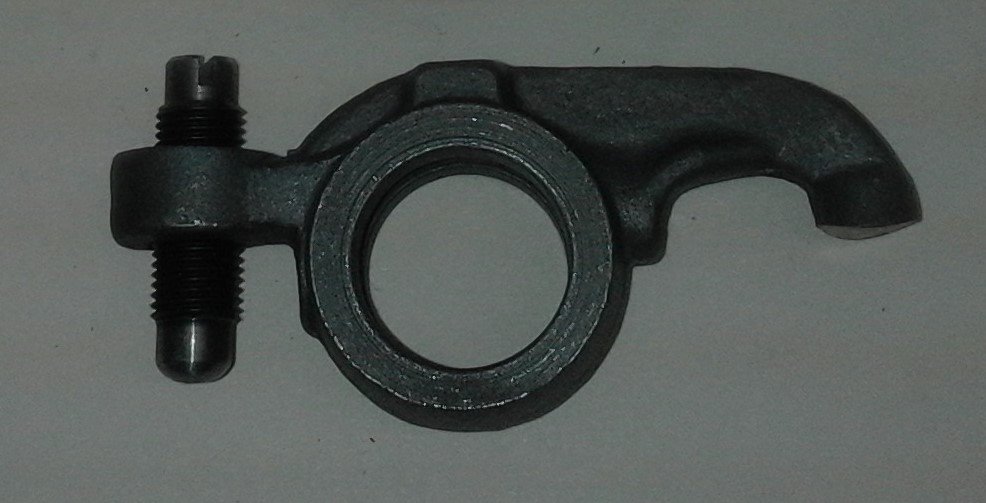

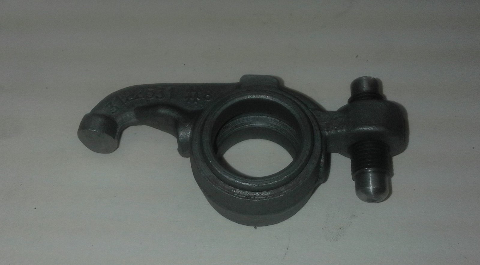

What is the number cast into the side of those rockers?

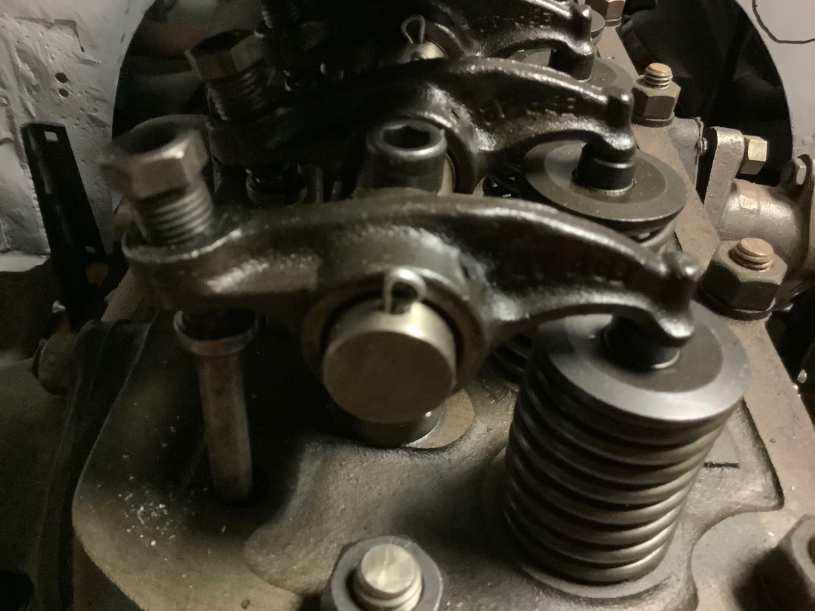

Would it be possible to get a few more shots of that setup--including one directly above a pair of rockers?
Thank You for the time in doing this.

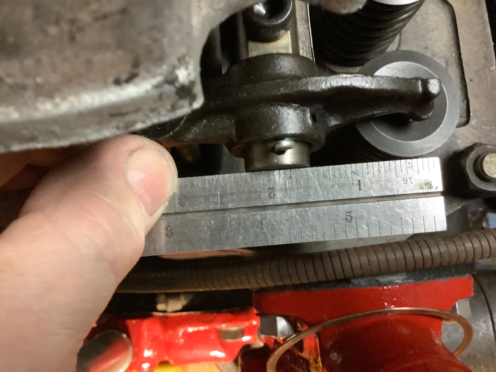

Chad, I have to tweak my firewall a bit to get the valve cover off easily. I’ll get to it soon, and can take better pics then. T
Dropacent
- Posts: 3384
- Last Name: Morsher
- Location: Norwalk Ohio
Re: Frontenac Rocker Arms

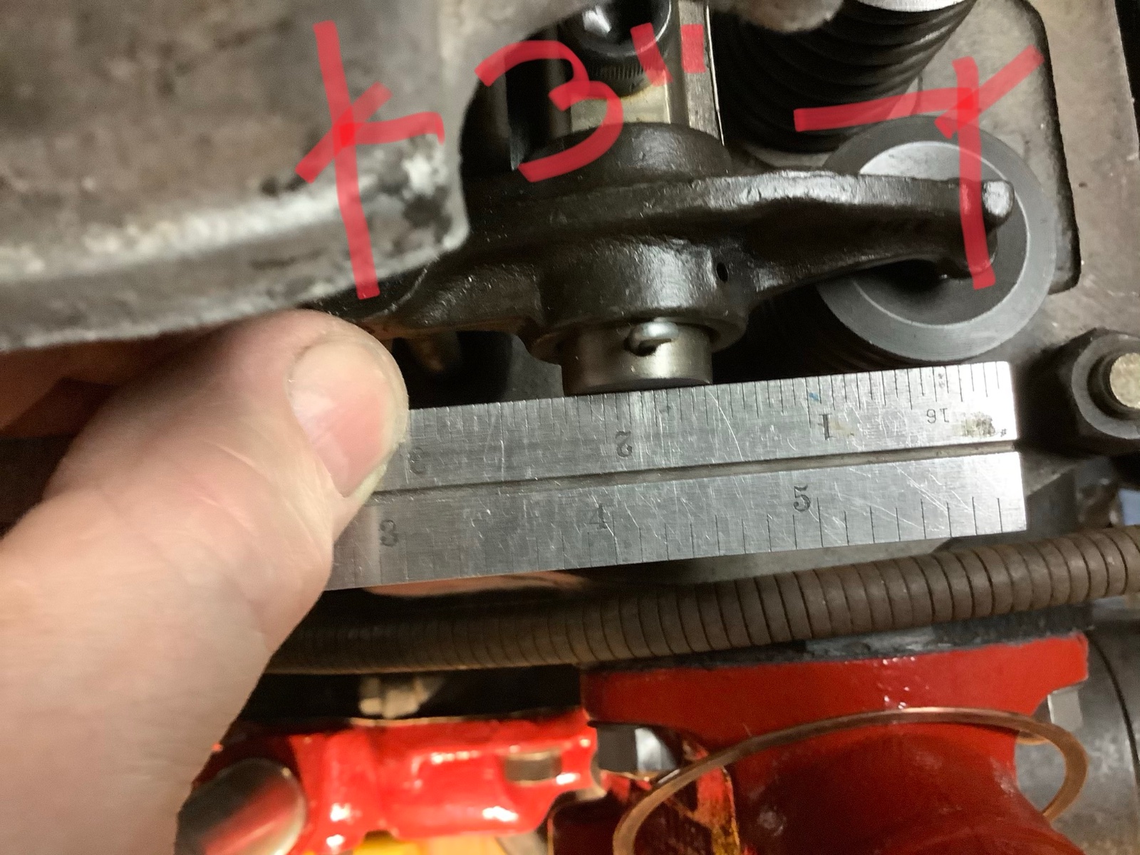

Looks like 3” between push rod center and valve stem center

A little searching on the web shows the EBP rockers coming from a 223 cube Ford 6.

Tim, THANK YOU!
What baffles me is why a straight rocker arm isn't landing on the valve tip. The pushrod to valve stem tip should be a straight shot.
But this is getting somewhere now. The geometry isn't that great with those 223 rockers, but it looks usable. I am being a little to picky I guess, I tend to get a little anal building engines.
Edit: I just picked up a used set of the 223 rockers to give it a shot. I'll still be looking though for other options.

You are correct, the Ford 6 rockers leave a lot to be desired geometry wise. You can make them work, but . . . . .
The Nash are the best off-the shelf solution. Problem is there are none on the shelf any more!

Nash Rocker
