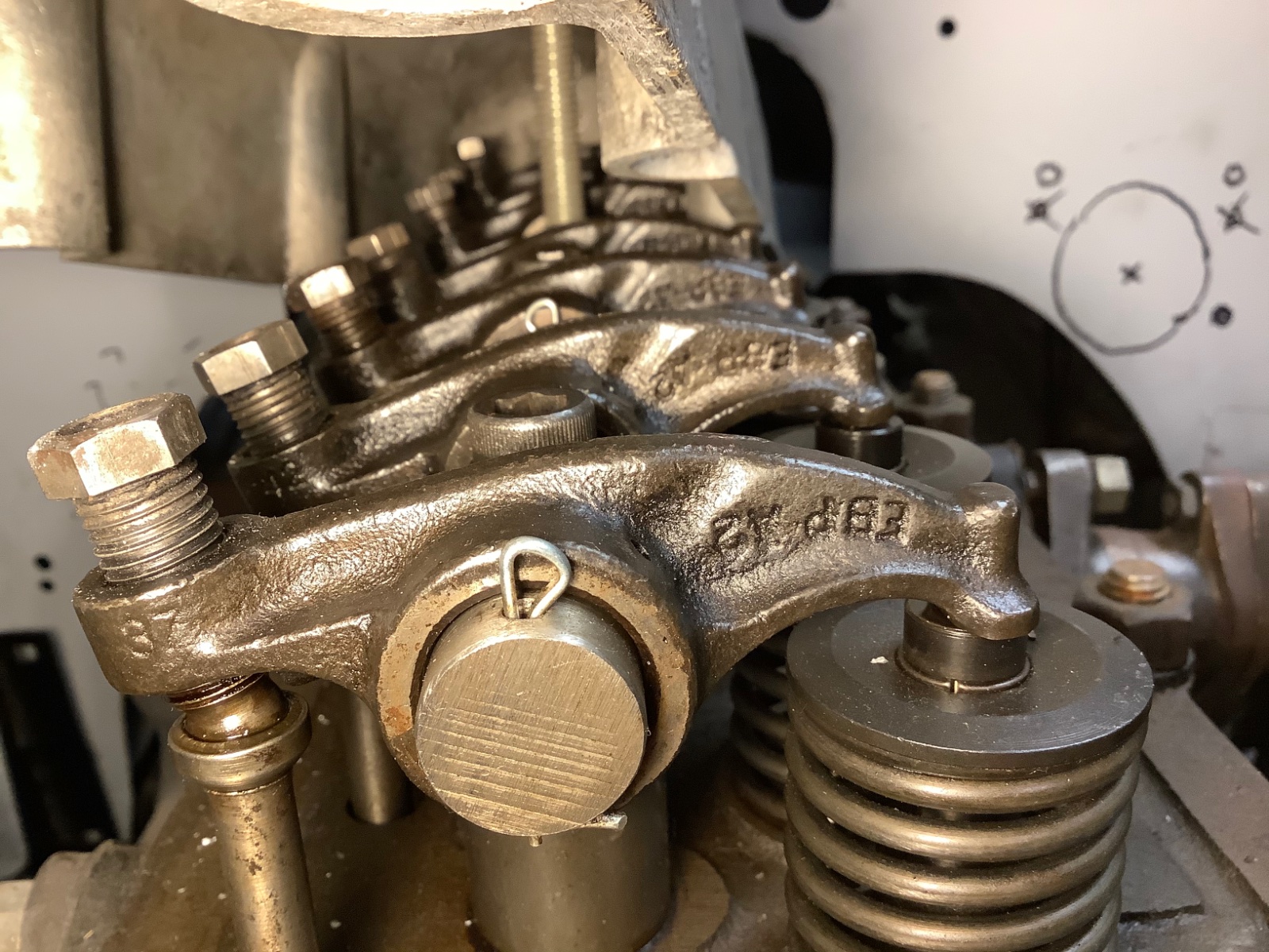

Jack Darons Frontenac Rocker Arms
Post by Dropacent » Wed Jan 08, 2020 2:33 pm
Chad_Marcheese
Posts: 257
Joined: Tue Jan 15, 2019 6:06 am
First Name: Chad
Last Name: Marcheese
* REQUIRED* Type and Year of Model Ts owned: 1925 Cut Off Touring / Pickup, 1923 Speedster Gow Job
Location: Upstate, NY
Re: Frontenac Rocker Arms
Post by Chad_Marcheese » Wed Jan 08, 2020 5:11 pm
Tim,
What is the number cast into the side of those rockers?
Would it be possible to get a few more shots of that setup--including one directly above a pair of rockers?
Thank You for the time in doing this.

Chad, I have to tweak my firewall a bit to get the valve cover off easily. I’ll get to it soon, and can take better pics then. T
Dropacent
Posts: 3384
Last Name: Morsher
Location: Norwalk Ohio
Post by Dropacent » Wed Jan 08, 2020 5:21 pm
Looks like 3” between push rod center and valve stem center

Post by Chad_Marcheese » Wed Jan 08, 2020 8:56 pm
Tim, THANK YOU!
What baffles me is why a straight rocker arm isn't landing on the valve tip. The pushrod to valve stem tip should be a straight shot.
But this is getting somewhere now. The geometry isn't that great with those 223 rockers, but it looks usable. I am being a little to picky I guess, I tend to get a little anal building engines.

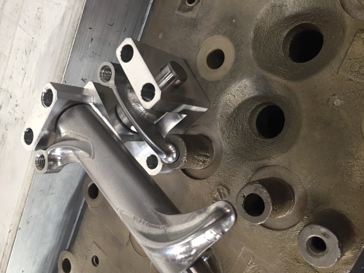

Kevin Pharis
Posts: 1649
First Name: Kevin
Last Name: Pharis
Location: Sacramento CA
Post by Kevin Pharis » Wed Jan 08, 2020 9:56 pm
I know that Rocker Arm Unlimited (formerly Rocker Arm Specialty) makes billet rockers to fit the A overheads... and know they have done T’s too. Might be worth the call...?
