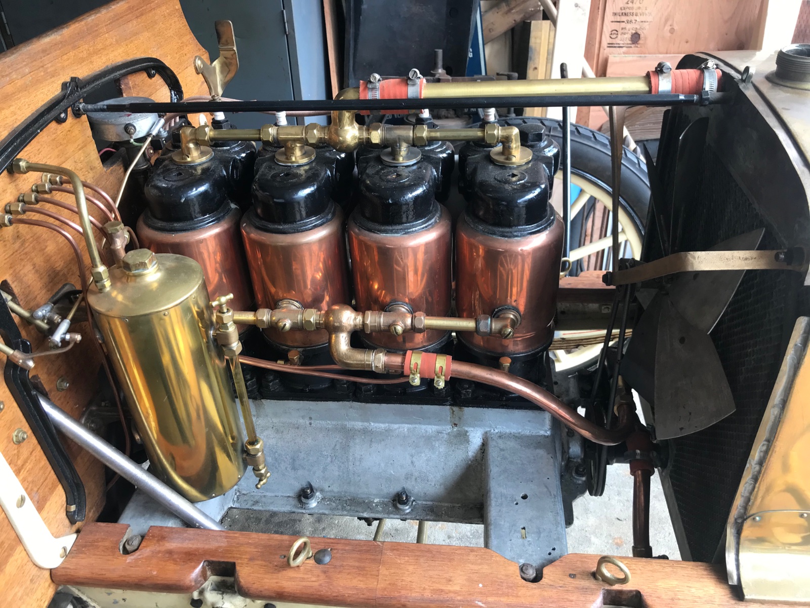

Post by KimDobbins » Thu Jan 16, 2020 2:48 pm

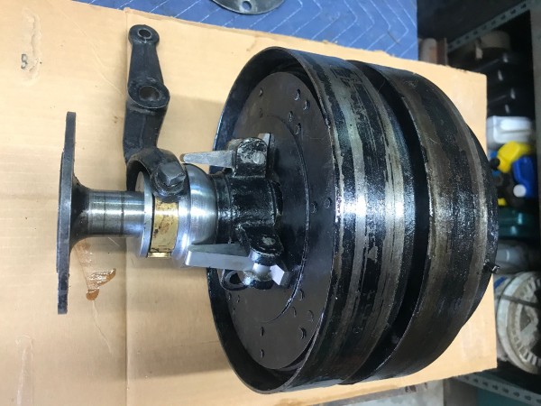

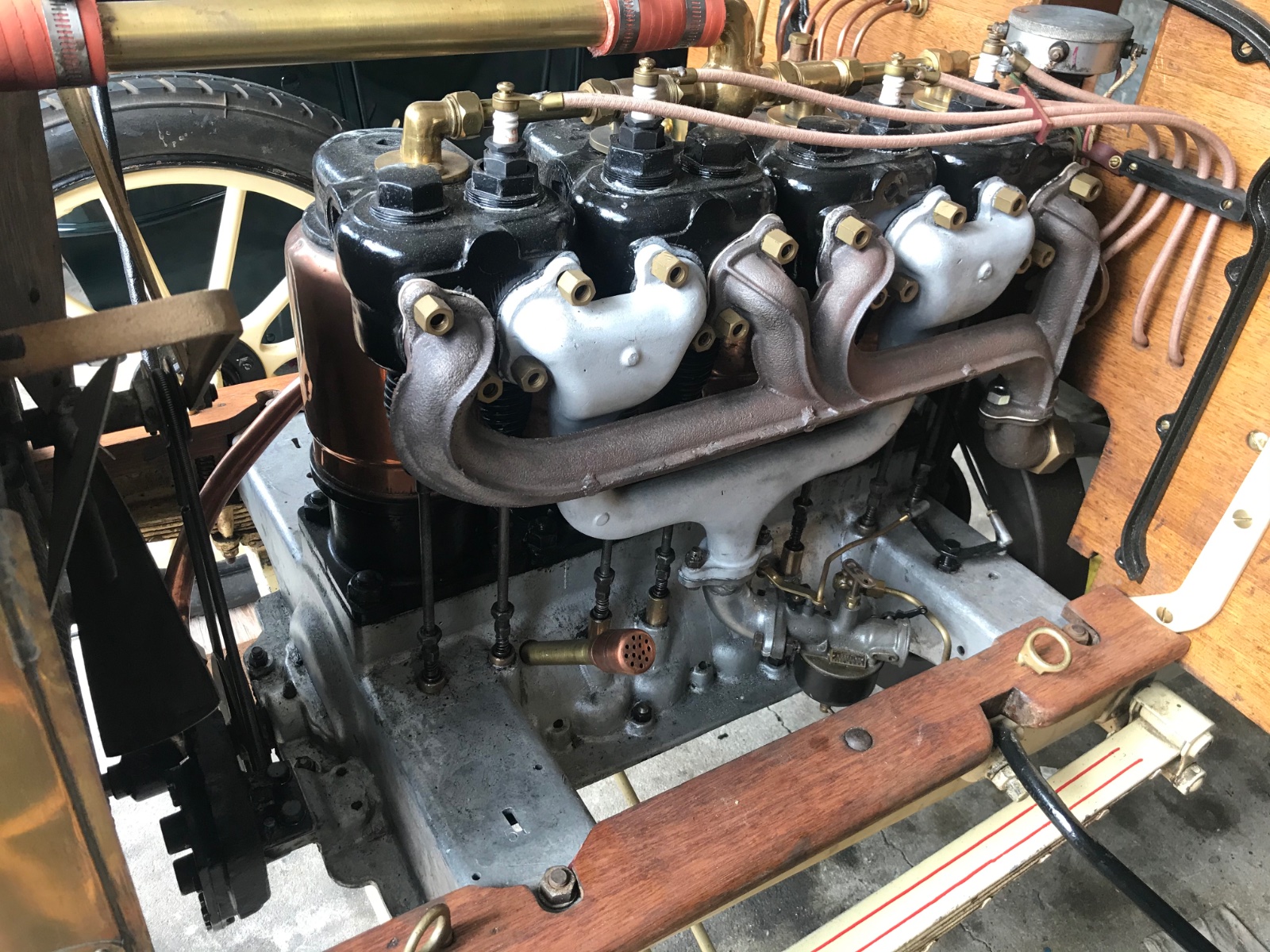

Pictures of the engine and some of the new transmission parts.

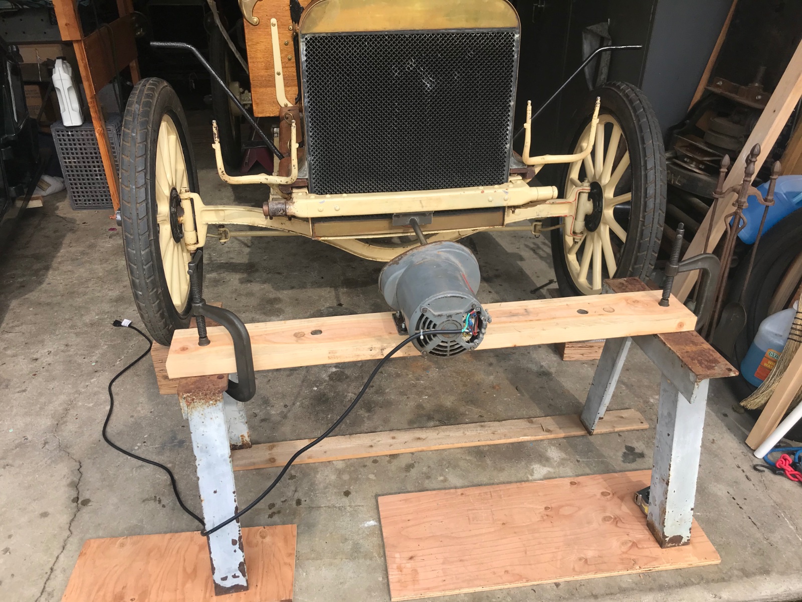

The gear reduction motor works great to turn the fairly tight motor over at 32 RPM.

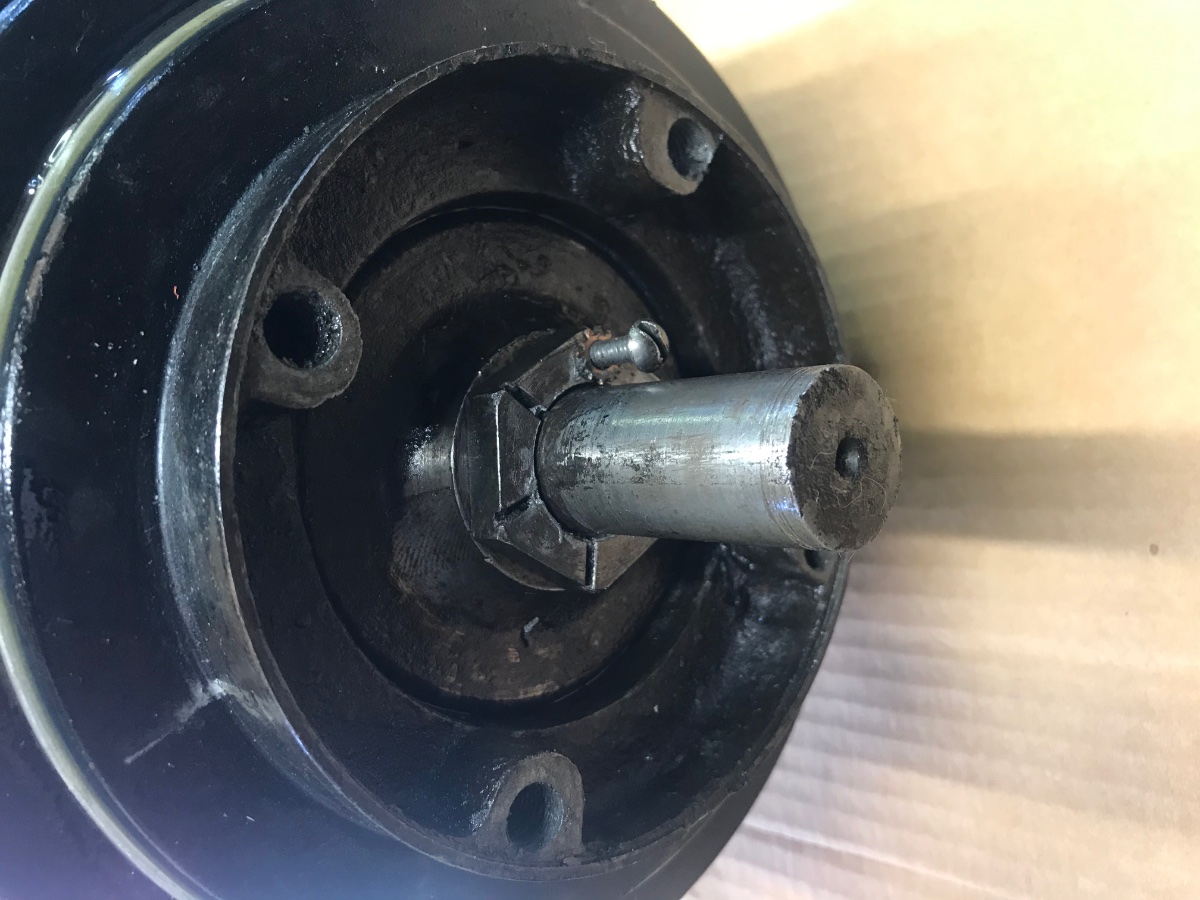

Post by KimDobbins » Thu Jan 16, 2020 3:05 pm

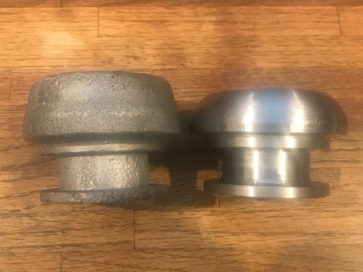

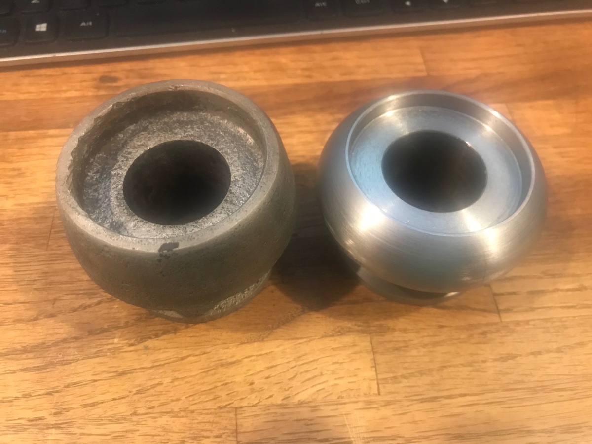

This is the high speed cone that the clutch fingers ride on. I don’t know where the old one came from. But as you can see, it’s different from the new correct one.

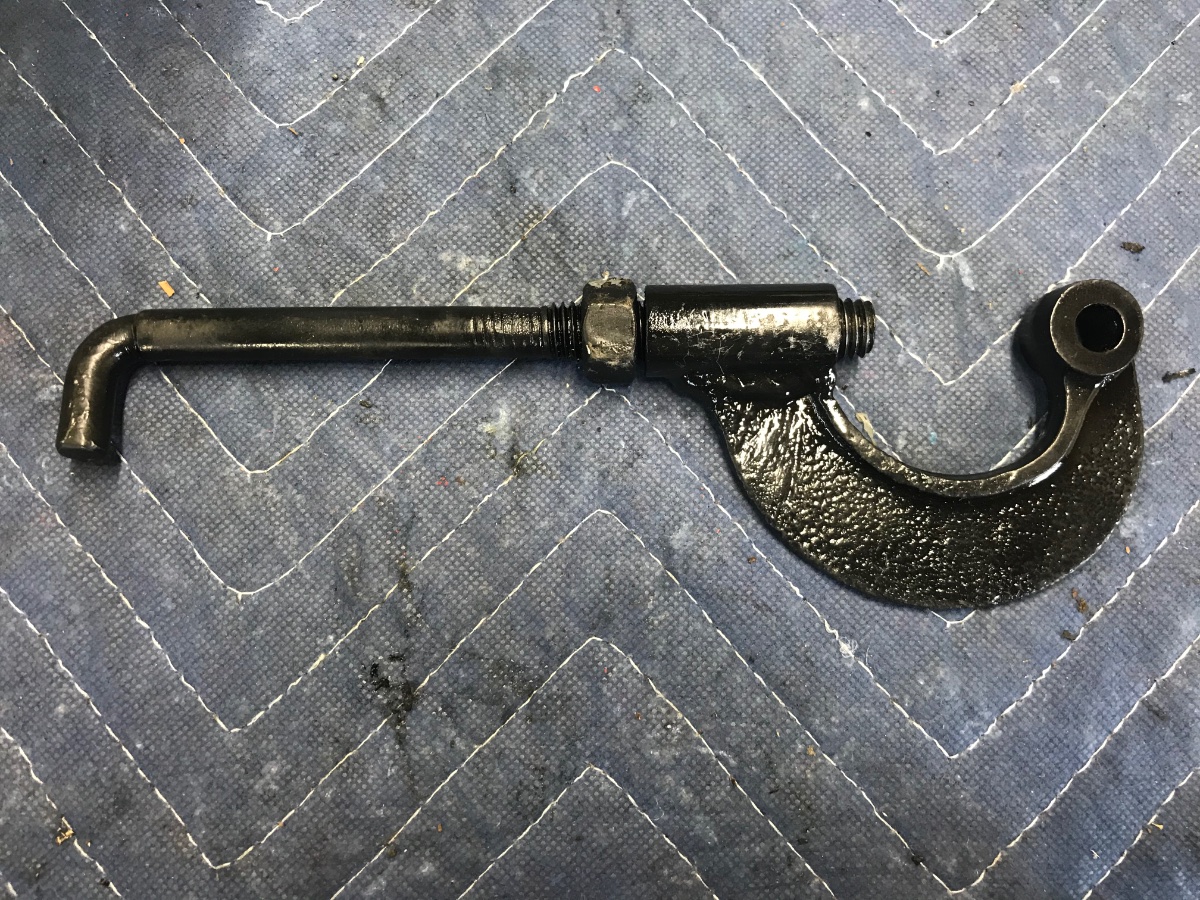

Post by KimDobbins » Sat Jan 18, 2020 2:04 pm

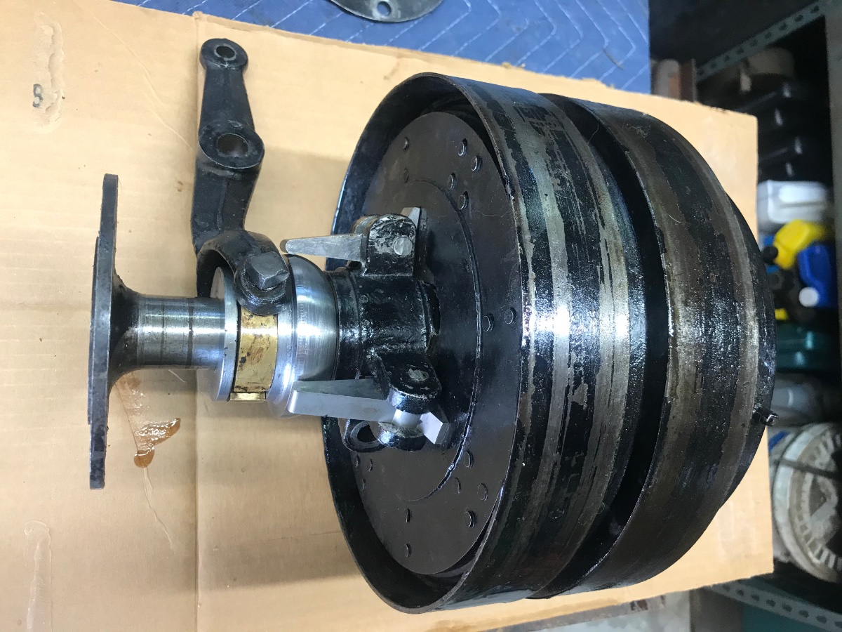

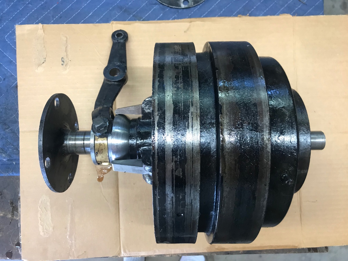

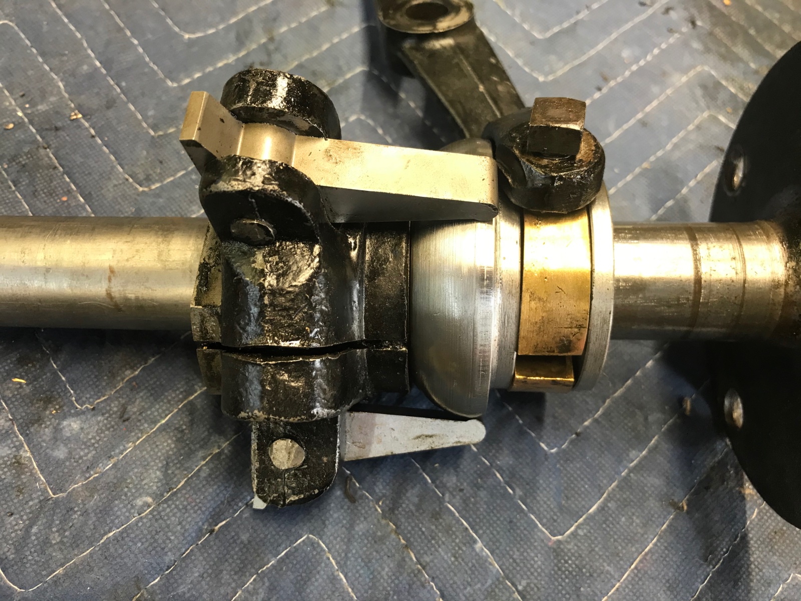

The transmission is now back together. There has to be a certain amount of clearance in the transmission so it rotates freely. The clearance is set by the nut on the end with the set screw. Any ideas on what this clearance should be? In thinking .025-.030?

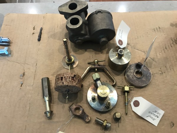

Are you familiar with Wayland Henry in Oregon. He reproduced at least one and probably more B engines. Keith from Gresham knows him well.
Kim, what would the B have had for an original carburetor??

Post by Steve Jelf » Sat Jan 18, 2020 3:19 pm

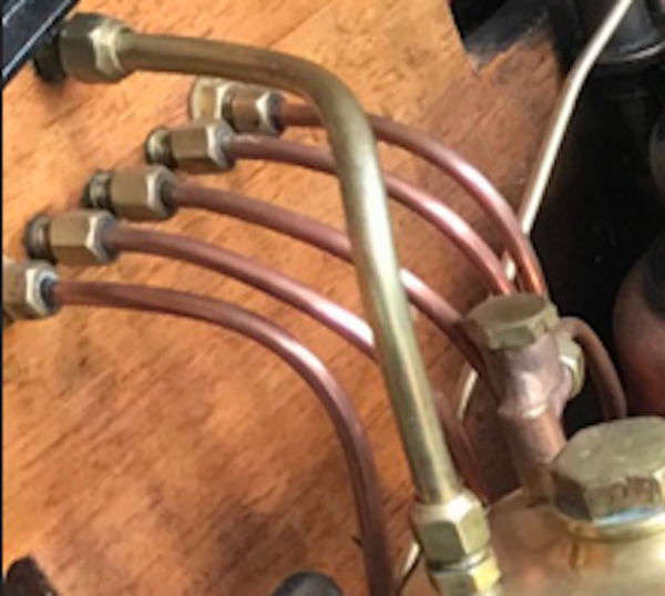

I think I understand most of what I see there, but what's the story on the copper tubes coming out of the firewall?

Stan, Wayland owns this car. He hasn't done much transmission work so he doesn't know the answer to the clearance issue. The B used 3 different carbs. Schebler, Holley and Kingston. I found a letter in the archives dated 1904 stating that all 3 carbs had been tested. The Holley was the best performer. The 1904 Holley is similar to the one used on the A and AC cars. the 1904 is a bit larger and has a few different internal parts. I have one but it still requires alot of fixing. I set up the NH to get the car started and and other running issues sorted out before i put the 1904 Holley on.
Steve, the brass tank is an oil reservoir pressurized by exhaust gas. Oil is fed up to a valve block where drip rates are set. one for each cylinder and one for the transmission ball cap.

I have some early holleys that are different than what I've seen..if you can send me a photo or drawing I may have one.

Stan, here is a picture of the carb and it’s current condition.

Wish I had a couple of those but they are different than what I have.
Depending on the actual design, needle and seat is a pretty small problem.
