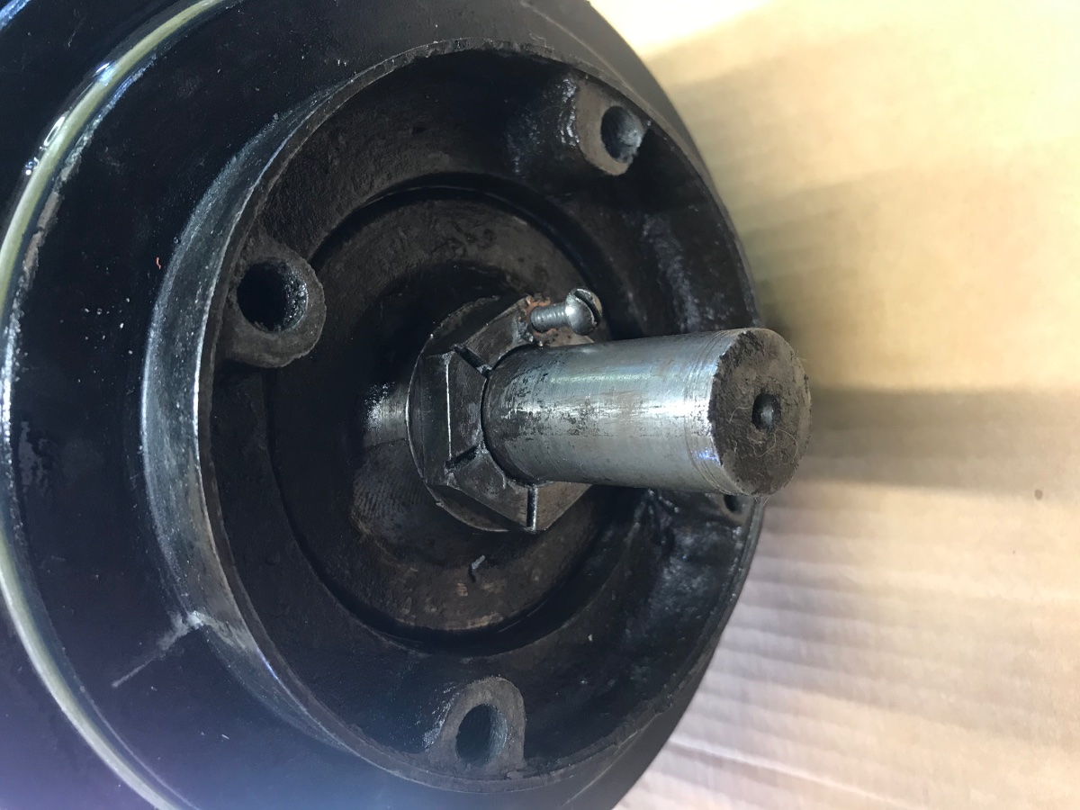

This is the high speed cone that the clutch fingers ride on. I don’t know where the old one came from. But as you can see, it’s different from the new correct one.
