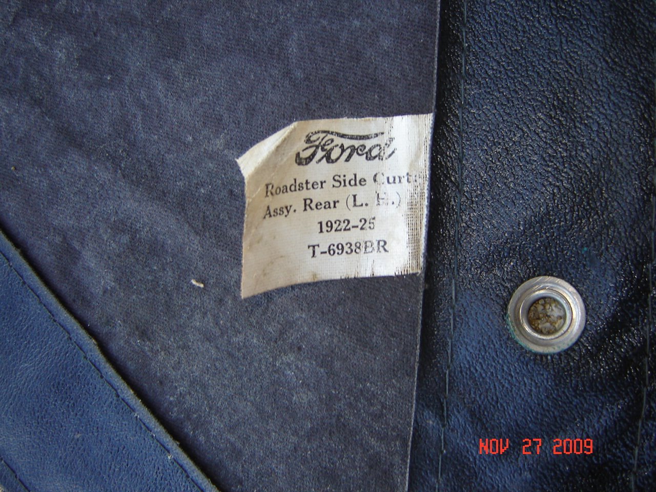

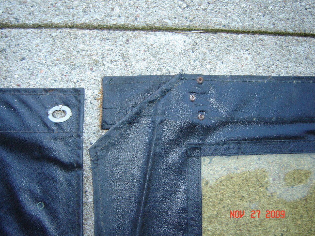

In the meantime, here are some pictures of NOS 1925 roadster side curtains that were posted elsewhere on the forum a while back. There is a limit of 5 pics per post, so I may have to spread the pics over multiple posts. :)

Thank you for the pictures. Looks like they used very little snaps. I didn’t have a way to contact Larry and any pictures I seen online were of no help
