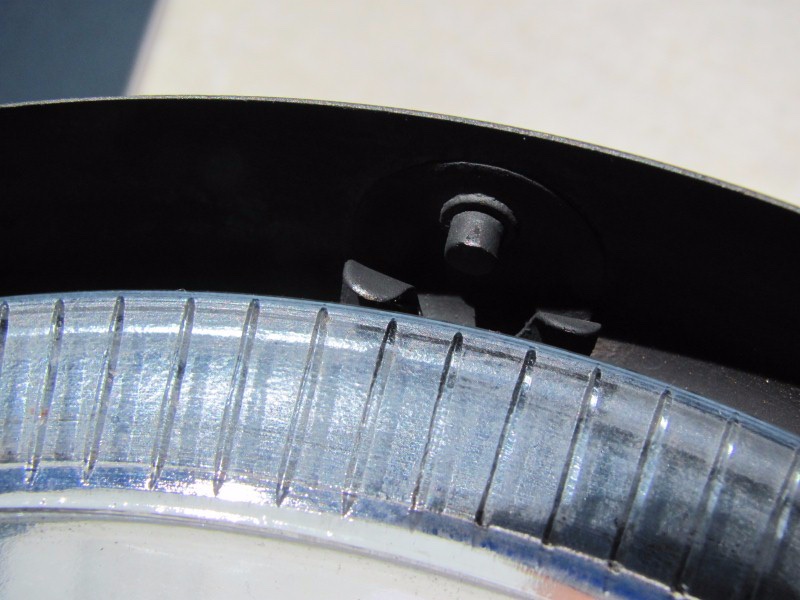

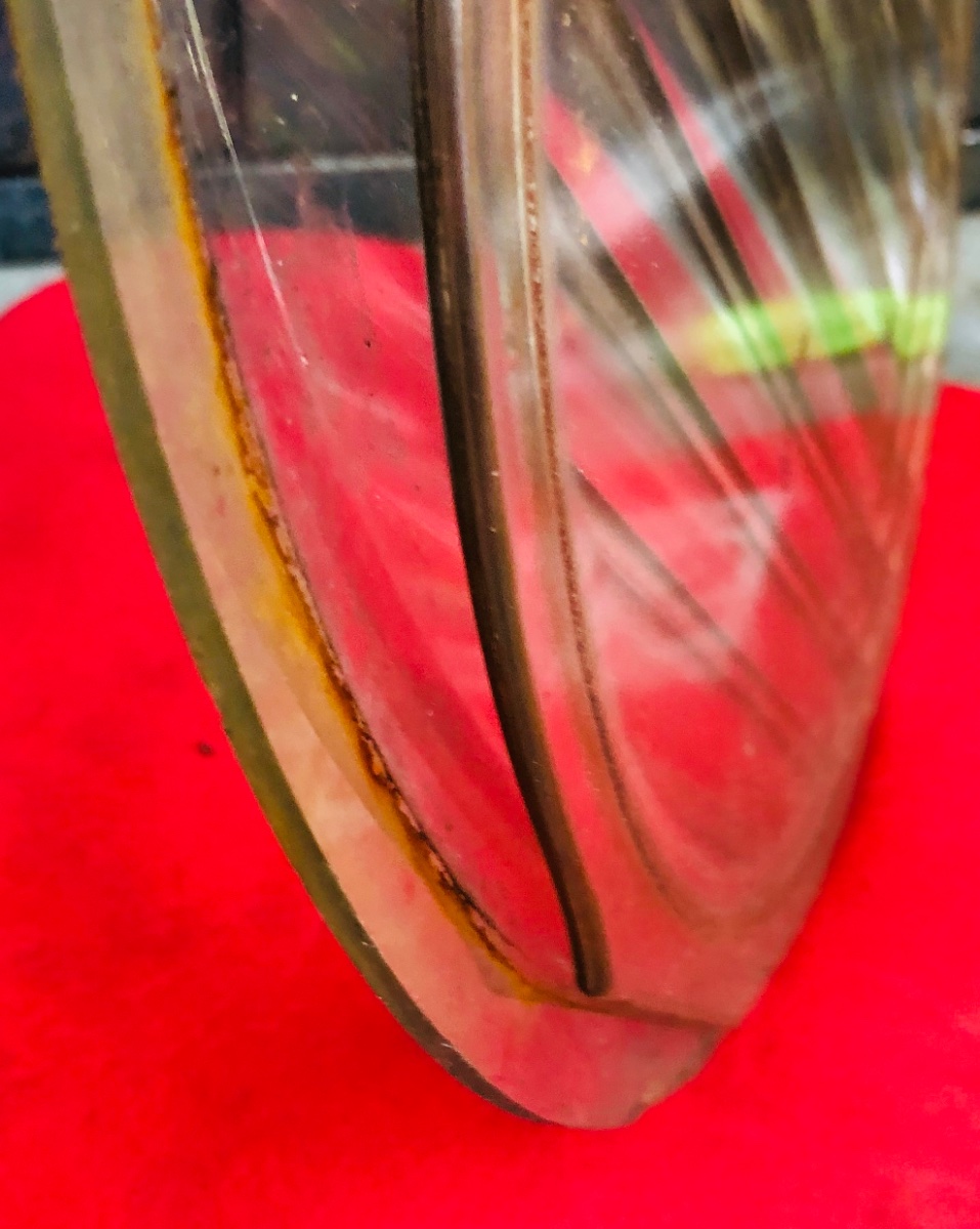

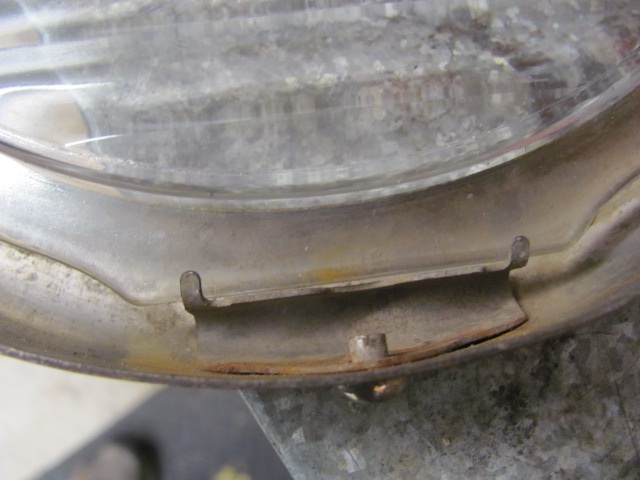

- Posts: 4060
Re: Headlight plain glass lens thickness?
Those clear lens are 'round' and are about 1/8" thick. The round fit best with the 'clip' style retainers in the headlamp rim. Those are early style steel rims.
If using the H lens style rims, those are made with little tabs that rest against a squared off edge on the glass. That is a feature of the fluted Ford H lens. So your clear lens needs to be shaped with 4 flat areas to fit into those style rims.
Clip style rim for round lens
H Lens rim
H Lens rim
