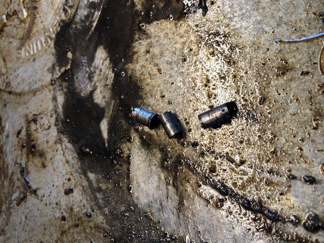

When I pulled the U-Joint from the axle, the pin came out in three pieces.
Did I do something wrong with the pining of the end?
Here is the pic of the pieces.

Just assuming the u-joint was original and was in original drive shaft. The rivet pin could have been fractured over time if it wobbled in a worn drive shaft hole. Assume you checked the i.d. of the drive shaft hole for roundness and fit of a new rivet pin. They have to fit snug on insertion, then rivet over the ends to retain that pin.

With the new drive shaft. The u-joint and the pin was really snug.
