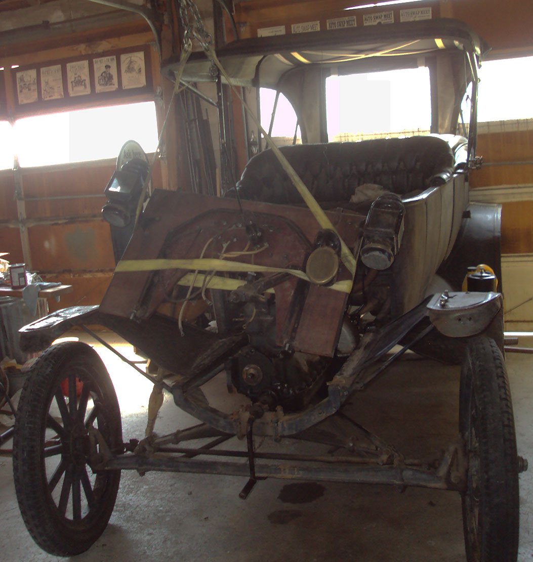

It’s disappointing and hard to admit when things don’t work out as you hoped. I spent much of four years putting a 1914 Touring car together out of parts I had collected over 30 years. Since the body panels were far from making perfect I opted to assemble a car that looked like a barn find. It was great fun and most of it was reported on the forum from 2014 to 2018. My attempt to resurrect an old engine didn’t work out as well as previous saves so I ended up sending it to the professionals.
Long story short, I got it running and it ran well. It was not running well on magneto. Somewhere my calculations and various assemblies and disassembly’s to get all the right magnet to coil gaps right had failed me. Having other cars to drive I left it alone for another day. The day came this spring. Reluctantly I undid all the nice assembly work and pulled the engine out. I will say this is much easier in a ’14 or earlier as the dash comes out and gives easier access. Removing the crankcase I began checking the gaps between magnet clamps and field coils. This resulted in gaps between .021 and .057. I realize that there is some sag in the flywheel and gaps at the top with be greater than gaps at the bottom. Logging numbers at 16 locations and then rotating the flywheel 1/16 turn and re-measuring didn’t yield anything logical. I rotated the engine and took more measurements which led to more confusion.

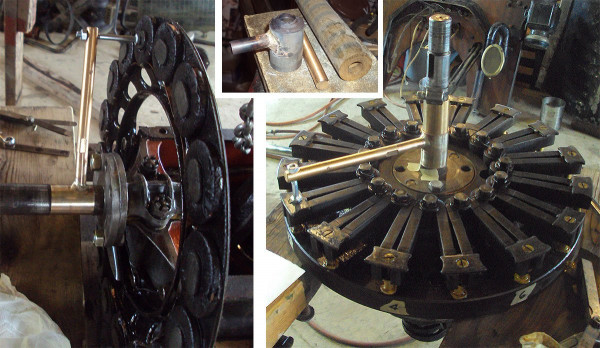

Although I had gotten by without for years I made a gap gauge. Taking the field coils off I checked each coil and each magnet. All this with the feeler gauges sticking to the magnets and distorting the reading.
With .007 difference at the magnets and .011 at the coils the right thing to do would have been to get a rewound field coil and remove the magnets. Recharge them and install them all at the same height. Sadly, that delay might exhaust my enthusiasm. With .025 to .040 desired gap I decided to shim the best I could and call it good. It took twice to get the majority of the gaps within the range but it final got real close. The Field coil plate may be bent and maybe the flywheel too.

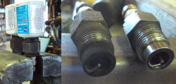

The spark plugs surprised me. I had run less than a tank of gas through the engine since rebuild but they were covered with carbon. 1 and 4 had a pretty thick build up. I suppose this was before the rings seated. One of my favorite plug cleaners is a pill bottle cut to fit the pipe thread and kerosene. 10 or 20 minutes really loosens the carbon. Not much leaks out.

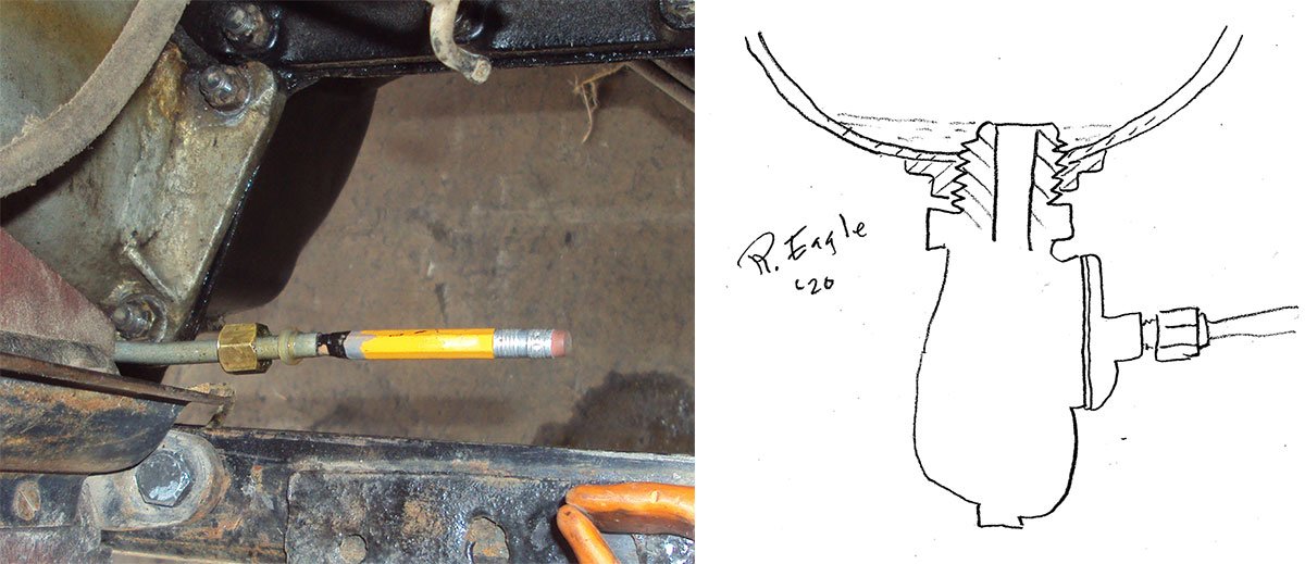

So while I'm at it "Where does the gas come from? The car has developed leaks at the sediment bowl and the carburetor while sitting. I drain the gas tank at the sediment bowl. Each time I step on the running board a 3 second dribble comes out. After a couple dozen times it seems dry. I open the carburetor drain and gas comes out the sediment bowl. It's from the gas line. It can work both ways. Now I can unscrew the sediment bowl. Nope, gas still comes running down my arm. Remember that the sediment bowl can stick up above the level in the gas tank and leave some gas trapped there. Shown in the photo is my gas stop pencil to keep the leaky valve from letting gas through. Sadly the wooden pencil is really made of plastic which melts.

The short pencils are normally used to plug the overflow tube when adding coolant to the radiator. I recall an eccentric gentleman who used a cellular radiator for a pen and pencil rack. There were dozens sticking out of it. Maybe that's where I got it.
