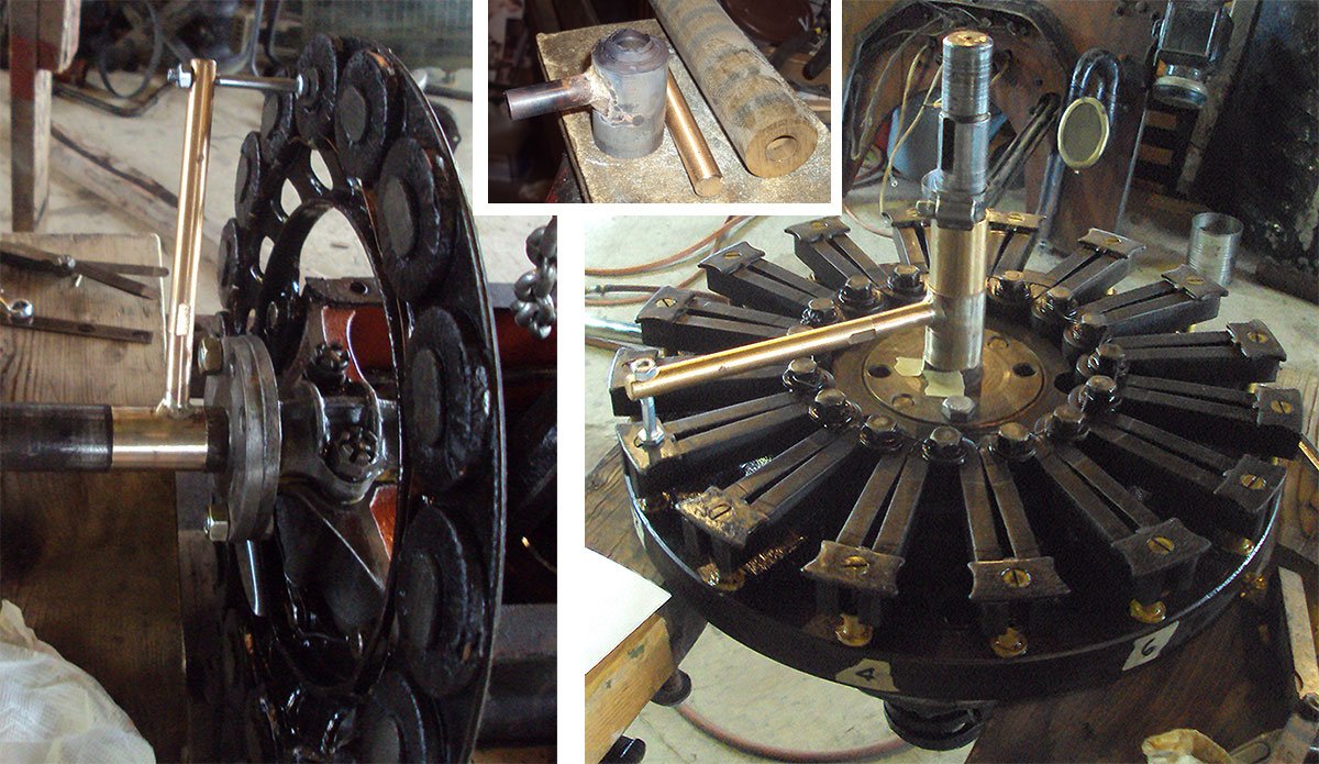

It’s disappointing and hard to admit when things don’t work out as you hoped. I spent much of four years putting a 1914 Touring car together out of parts I had collected over 30 years. Since the body panels were far from making perfect I opted to assemble a car that looked like a barn find. It was great fun and most of it was reported on the forum from 2014 to 2018. My attempt to resurrect an old engine didn’t work out as well as previous saves so I ended up sending it to the professionals.
Long story short, I got it running and it ran well. It was not running well on magneto. Somewhere my calculations and various assemblies and disassembly’s to get all the right magnet to coil gaps right had failed me. Having other cars to drive I left it alone for another day. The day came this spring. Reluctantly I undid all the nice assembly work and pulled the engine out. I will say this is much easier in a ’14 or earlier as the dash comes out and gives easier access. Removing the crankcase I began checking the gaps between magnet clamps and field coils. This resulted in gaps between .021 and .057. I realize that there is some sag in the flywheel and gaps at the top with be greater than gaps at the bottom. Logging numbers at 16 locations and then rotating the flywheel 1/16 turn and re-measuring didn’t yield anything logical. I rotated the engine and took more measurements which led to more confusion.
Topic author - Posts: 6895
Re: Going Backward – Mag Gap Readjust
Although I had gotten by without for years I made a gap gauge. Taking the field coils off I checked each coil and each magnet. All this with the feeler gauges sticking to the magnets and distorting the reading.
How did I get by all these years with the other car magnetos working? My hats off to the perfectionists. Reassembly and installation went with the usual problems. Some went well and some were a pain. Lining up the u-joint was a snap this time. Resting the driveshaft housing on the cross shaft and teetering the engine to the right height let me position the square end with a wire and pry the pan arm back. Presto.
The usual holes never seem to line up without a lot of prying.
With .007 difference at the magnets and .011 at the coils the right thing to do would have been to get a rewound field coil and remove the magnets. Recharge them and install them all at the same height. Sadly, that delay might exhaust my enthusiasm. With .025 to .040 desired gap I decided to shim the best I could and call it good. It took twice to get the majority of the gaps within the range but it final got real close. The Field coil plate may be bent and maybe the flywheel too.How did I get by all these years with the other car magnetos working? My hats off to the perfectionists. Reassembly and installation went with the usual problems. Some went well and some were a pain. Lining up the u-joint was a snap this time. Resting the driveshaft housing on the cross shaft and teetering the engine to the right height let me position the square end with a wire and pry the pan arm back. Presto.
Hooking up the wiring I noticed the magneto wire terminal was loose on the insulator connection to coil box. Had that been the problem in the first place. Well, I don’t suppose so seeing the gaps weren’t right. After all was said and done the magneto works fine. Even with old magnets and rough looking field coil. When the time comes I can go through all this again I suppose. Or maybe the next guy will.
