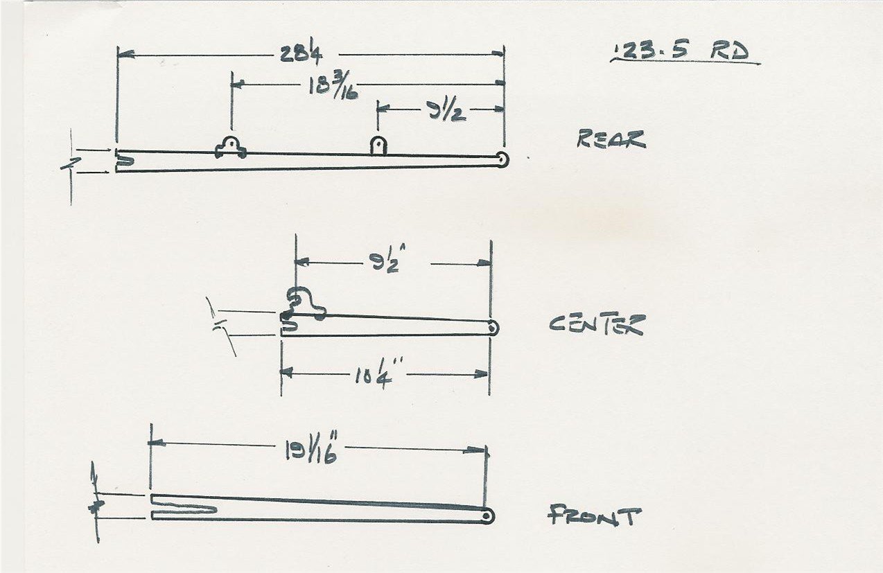

I'm sure you are already aware that the front top bow should be repositioned from the low pivot hole on the rear bow to the higher pivot hole on the middle bow. But if someone new to 1923-1925 roadsters is looking at the photos it could be helpful to them. The front bow should be in the lower hole on the rear top bow when the top is down so the front bow didn't stick out a lot further back when the top was down. But the front bow shuold be moved to the middle bow when the top is up to make it easier to enter & exit as well as for clearance for tall people etc. The photo below captured from Phil Mino's (R.I.P.) website show that clearly:

I suspect -- but I do not know for sure -- that if your current top was installed with the bow in the wrong pivot point, that it will need some additional material added. There is an easy way to check that. Disconnect the top from the front windshield. Get someone to help you put the front bow in the proper pivot point on the middle bow. Lower the front bow down (don't use a lot of force -- or you will rip the top material etc. If it fits -- great. If not -- many of us leave the top down and no one will notice. And if you want to put the top up -- to provide shade etc. it still works the way it is -- just duck your head when you get in and out of the car. And put that on the fix later list. You can also take it back to your family upholstery shop and have them fix it.
