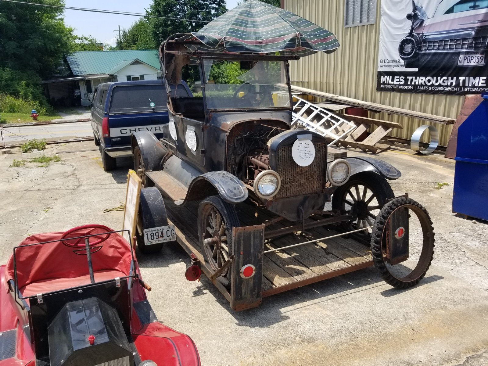

Brought to life after 50 years. The photos are how I found it almost 2 years ago and how it sits today. My uncle parked this in 1972 and it started for the first time since being parked today. So much pride. My first T. Changed the "new" oil and found a few bits. Don't think it is anything to be over concerned about.
