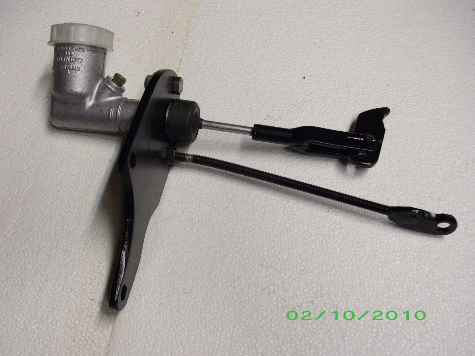

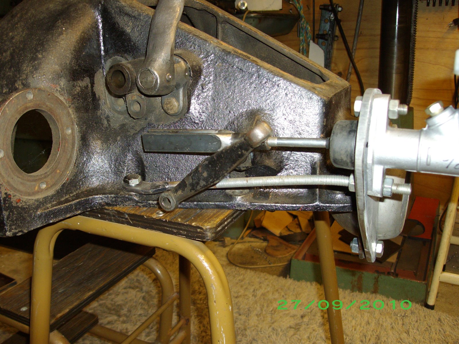

Tom ; do you mean this .
Tmooreheadf
Posts: 437
Joined: Sun Jan 06, 2019 7:31 pm
Last Name: Moorehead
* REQUIRED* Type and Year of Model Ts owned: 24 Touring, 25 Coupe,
Location: Louisville, KY
Re: Disc brake master cylinder bracket
Post by Tmooreheadf » Wed May 20, 2020 6:37 am
Yes, that's the rod. I just don't remember seeing it on current applications, such as some newer sure stops I have seen recently. I am going to put one on just to satisfy my own concerns. And maybe the newer ones don't require the extra support. Or may no one has noticed the movement.
