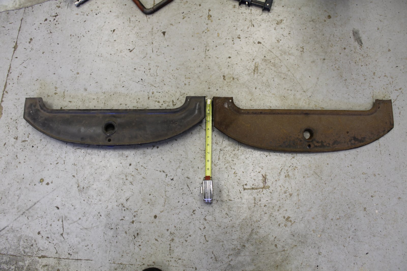

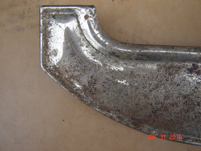

I noticed that the Radiator Apron for the 1924 - 1927 TT is a bit different then the car. The distance of the "face" is longer, see the attached photos. How does the fender's "tab" conner that goes near the front cross member match up with the apron? Is anyone reproducing the TT Aprons?

I believe both of those aprons are for a '26 - '27 as they both have the small hole for the retaining screw to fasten to the later spring clamp/engine mount.

I cannot imagine why there would be a difference. The frame is the same size at the front edge. Checking the parts books might shed some light.

It's not just the length of the end tabs, the crank hole is also mounted lower. The whole apron is stretched.
It suggests that the TT front cross member is different than a T's. Is that true?

That's a TT radiator apron, they are larger for the bigger front crossmember on the TT.
And the motor/spring mount is bigger too for the TT, has longer threaded shanks.
Note the part # for the TT apron, 3977F

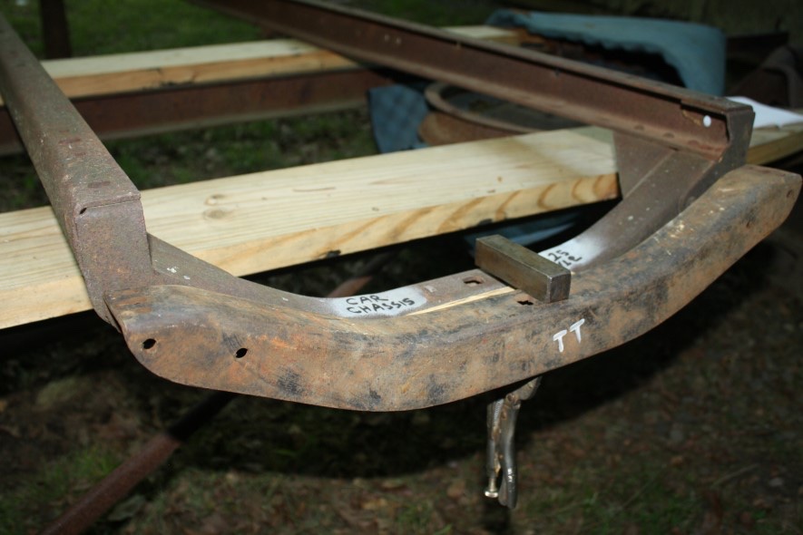

TT front crossmembers ARE different than the car crossmembers!
It’s the usual culprit when someone has an issue with the radiator inlet not properly aligning with the water outlet on the cylinder head. Usually what happens is someone replaces the front crossmember and a car gets a TT crossmember or a TT gets a car crossmember. Many times the radiator inlet gets “fixed” to line up by a radiator shop and when that radiator or crossmember is replaced, there is a problem again.

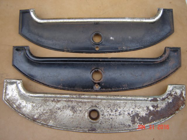

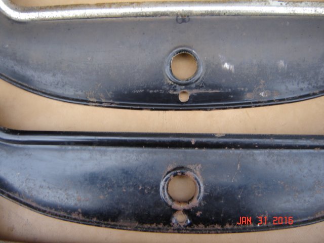

The narrow apron with the hole is actually 1926-27 TT. The 1924-25 TT uses the same as the 1924-25 Model T car.
What makes it confusing, the 1926-27 Model T car has hood shelves that come all the way to the front of the frame, and the radiator is mounted on top, which requires the wider apron. The 1924-27 TT uses Model T car hood shelves, which do not go under the radiator. So, the radiator is lower and requires a narrow apron.
In the classifieds, Mark Chaffin has a nice 1926-27 TT apron for sale.

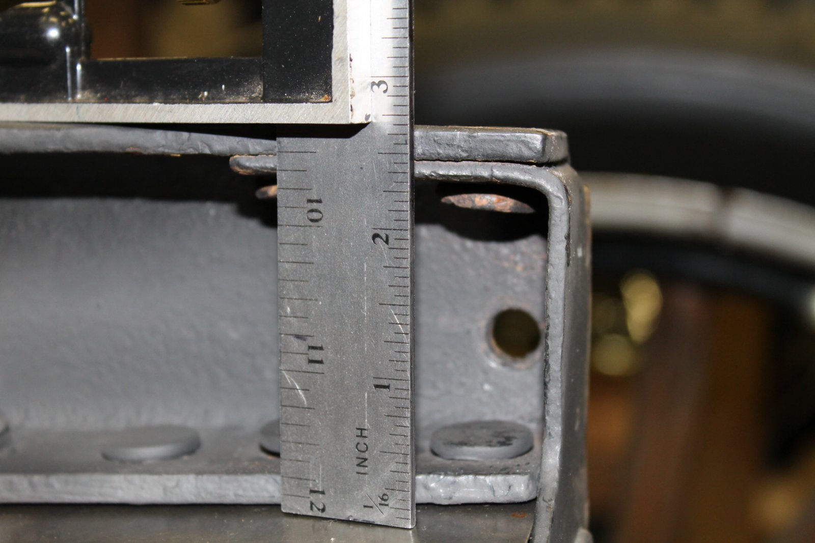

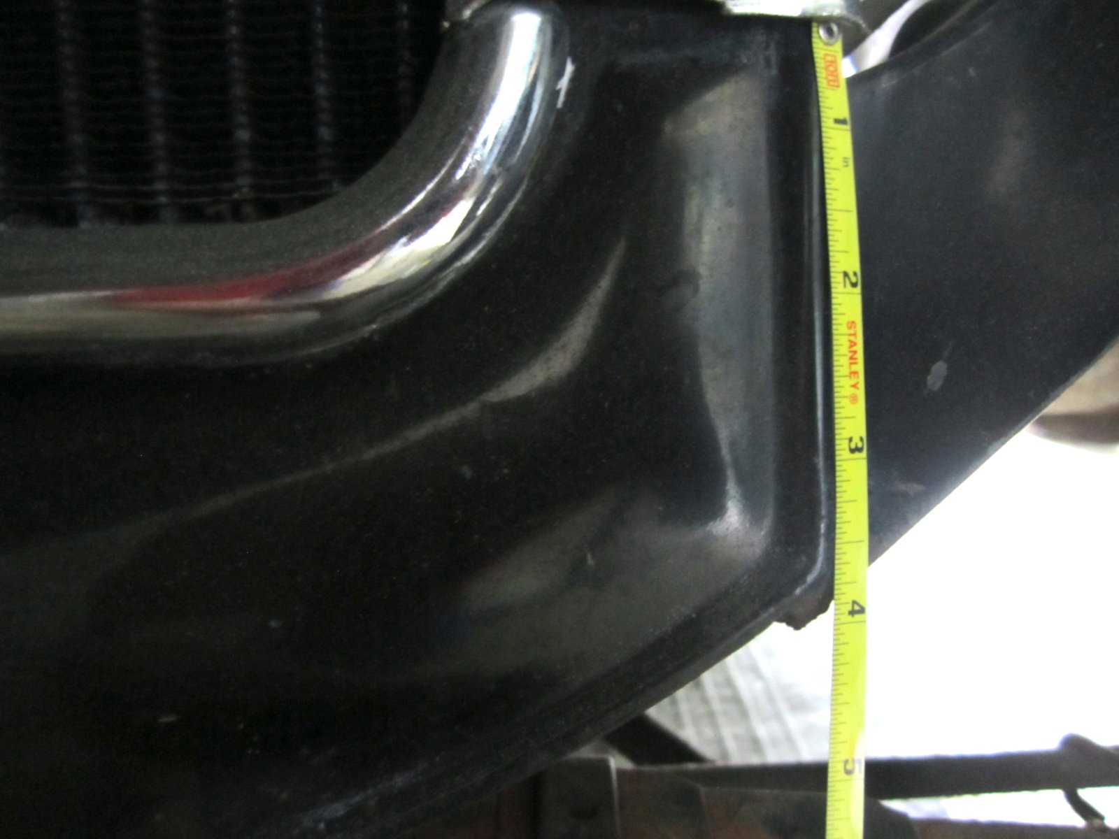

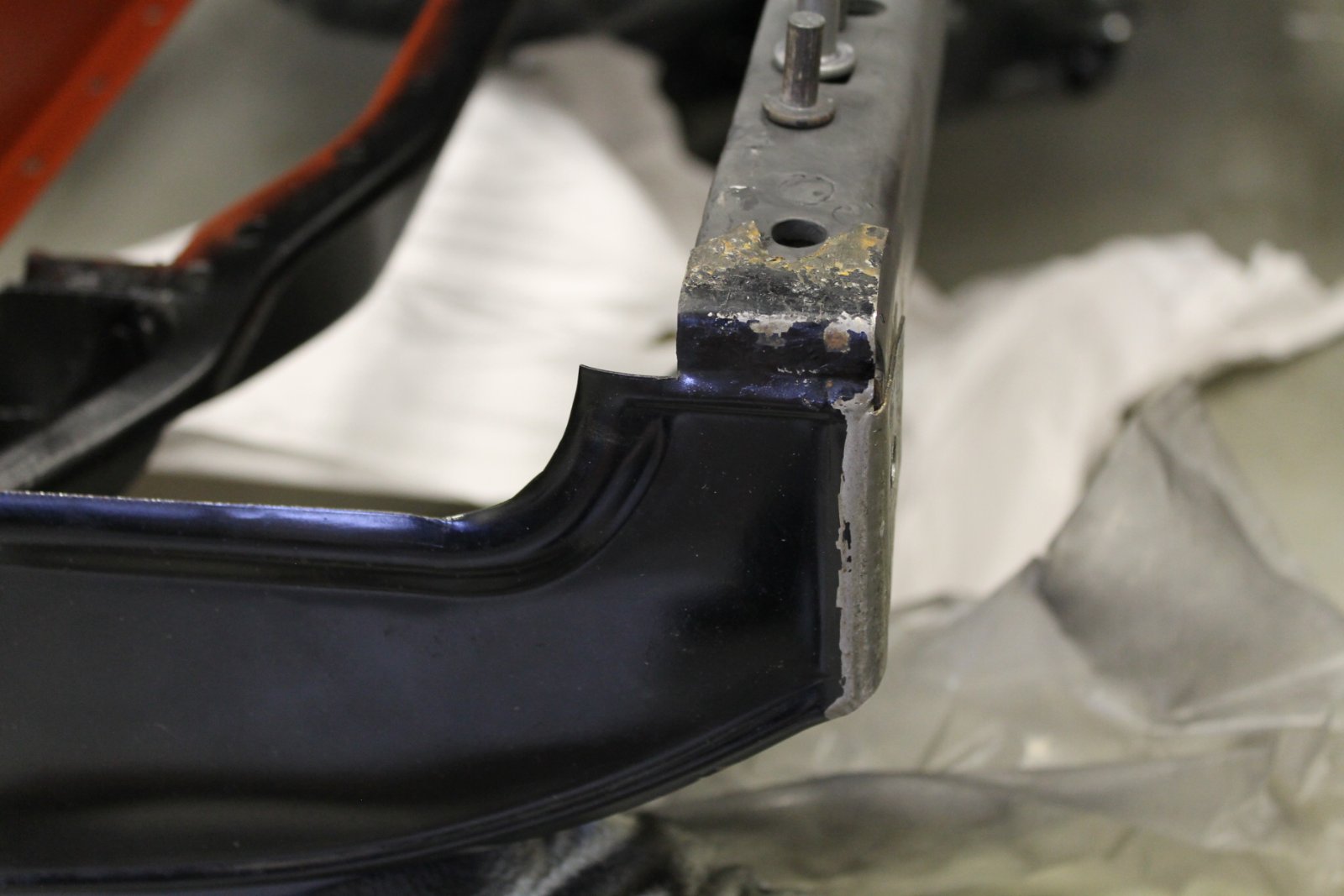

I thought that the front of the TT Chassis / frame was the same as the car but, I took a measurement in the front area where the radiator is mounted and the TT is about 11/16" larger. see photo.
I measured a car, 1925 back, chassis at 2" and the 1926 TT at 2 11/16". I feel this is reason for the difference in the car and TT Aprons. I have only the 26/27 TT frames so I can not say what the 1925 TT back is but I think the frames and cross member are all the same for the 1918 through the 1927 TT? So would this mean the Aprons for the 1925 would be different, 11/16" more the the 1925 car apron?
I show a picture with a "modified" tabs bent to make a 25 car apron fit to align with the pan's crank hole.

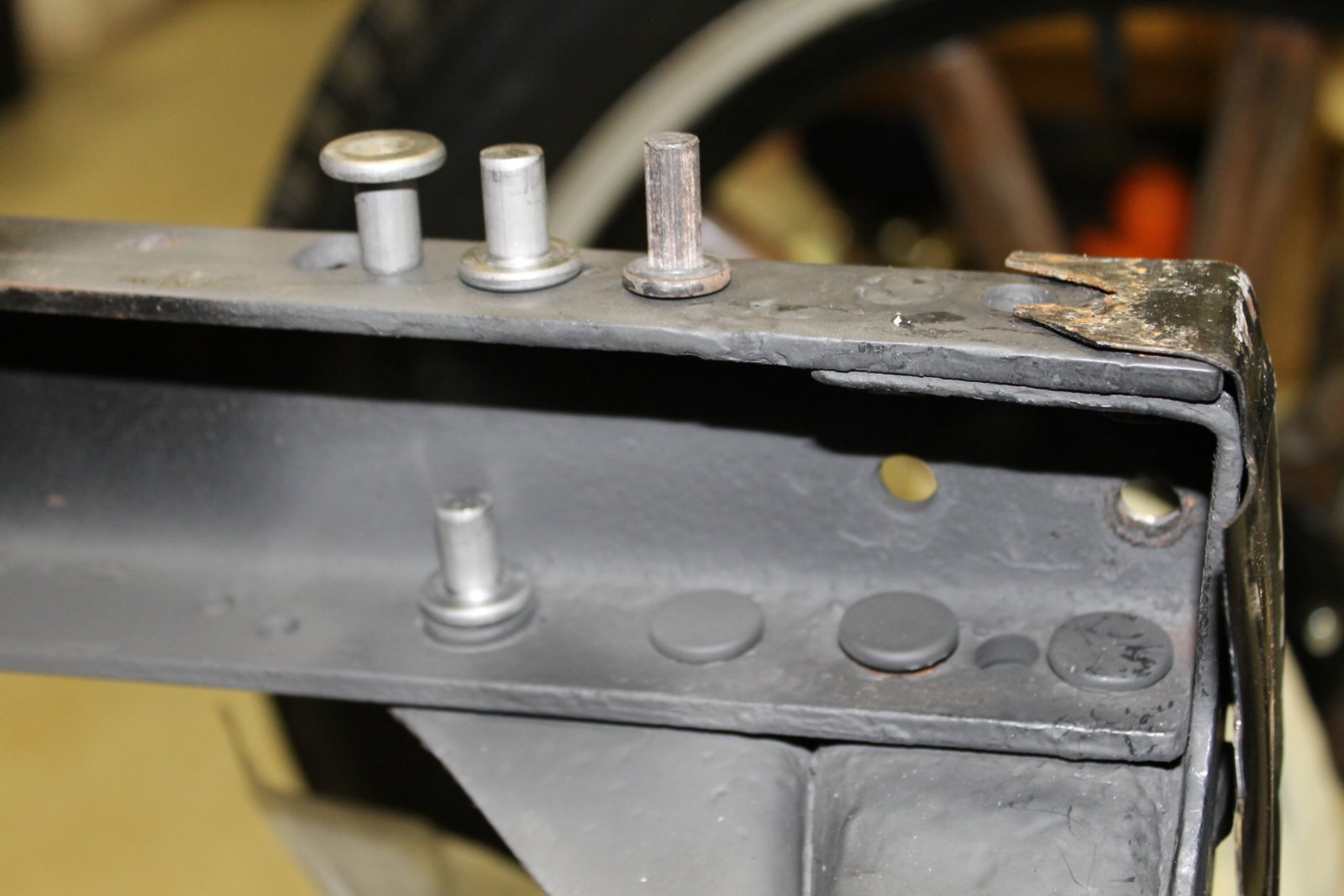

I also, just installed some new rivets which are different then the Cars, larger diameter head. Mcmaster part number 97032A389

Have this apron pictured here. It’s either the middle or lower one you posted. Mine is almost 24” wide. Is that the narrow or wider version. Excess parts Like to verify what it goes to.
Thanks John

The 1925 passenger cars had the option of using a nickel shell. Only once, I saw an apron for a nickel shell with the slots for the nickel trim piece. Knowing Jim Rodell, he probably has one!

Thanks Smith for identifying my apron above. That’s what mine has a separate trim piece held by tabs on back. John

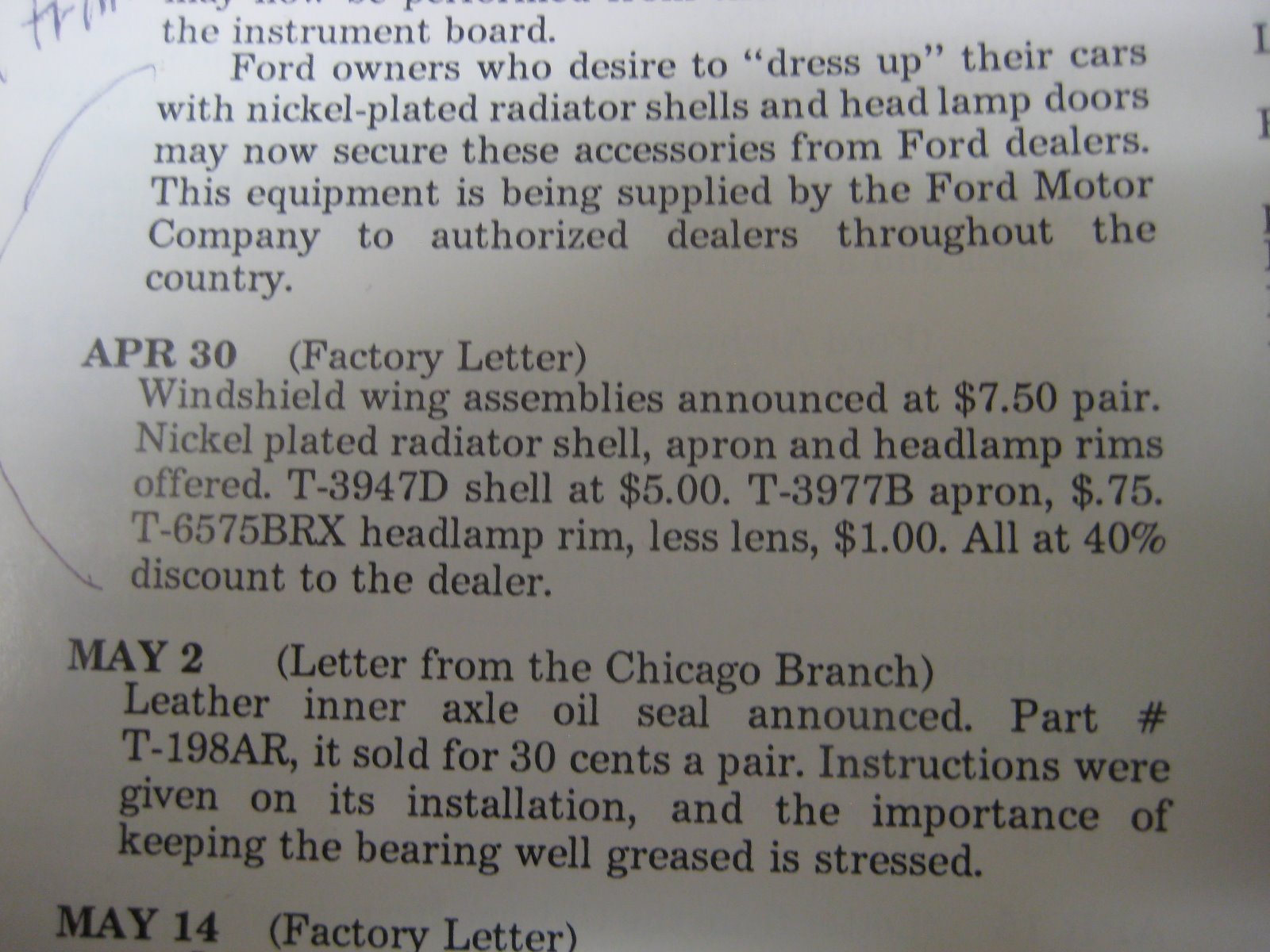

Larry,
I wonder if the 1925 type apron that you saw was made by adding the 1926-27 nickel strip. It is easy to make the three little slots in the 1925 apron. It fits perfectly, and even the little hole matches up for the choke wire.
On April 30, 1925, Ford issued a Factory Letter offering the nickel plated radiator shell, apron , and headlamp rims, to dress up the 1925 models. In June, it was also issued in a Service Bulletin. For a short while they were also listed in the Price List of Parts.
The only nickel plated 1925 apron, #3977B, that I have found does not have very good plating. The nickel plating over steel did not hold up well.
I have never seen an old photo of a 1925 with the nickel plated trim, either. It would be nice to see a 1925 trimmed out with all of the nickel.

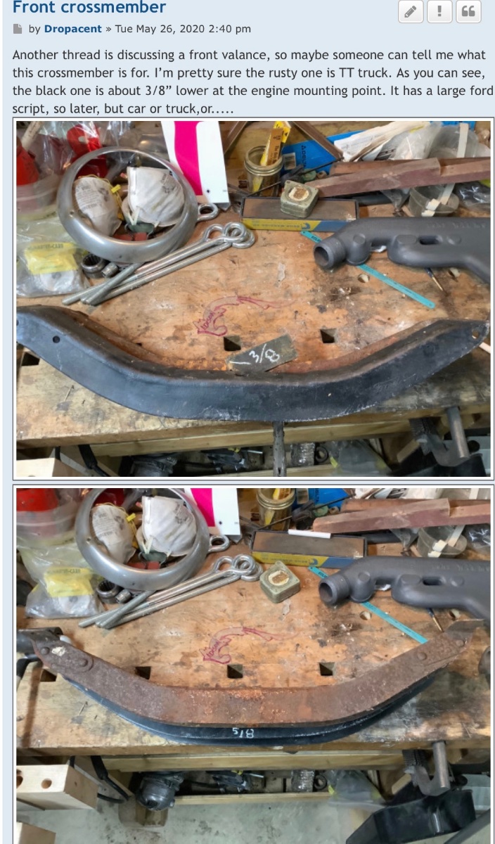

I’m moving this over here to see if I can get a consensus. Reading above, lots of conflicting info, and the encyclopedia is no help. Correct me if I’m wrong, but the longer/taller/wider valance, shown to the right in the very first picture, is late T, 1926-7. The one to the left ( shorter height) would be a TT, and earlier cars, 1923 into 1925.
I have what was likely a commercial chassis, it’s had a station wagon body since new. 1926, it has the fordor style firewall, heavier springs and the center mounting hole below the crank hole does not line up with the motor mount screw hole.
I’m expecting the Longer/taller/wider valance I just purchased will fix that problem. Other than the hole, the shorter valance looks fine and covers the front crossmember well.

The first pictures that started this shows a 1926-27 Model T passenger car radiator apron on the right, T3977-E, without the nickel trim strip.
On the left is an apron for 1926-27 TT, part #T3977-F , factory #TT8016. If it did not have the small hole below the crank hole, it would be a #T3977, which is for 1924-25 Models T and TT.
If you have 1926-27 Model T hood, fenders, and hood shelves that are longer and reach the front of the frame, then the radiator sits higher, and the tallest , 1926-27 Model T radiator apron is required. If you are using 1924-25 Model T or 1924-27 TT hood, fenders, and hood shelves, then you would use a #T3977-F with the screw hole below the crank hole.
1922 Coupe , 1926 Touring

Re: TT radiator apron
Post by keen25 » Wed May 27, 2020 11:16 pm
Jim,
The picture at the top shows a side by side comparison; on the left is a 26/27 car radiator apron and on the right a 26/27 TT truck radiator apron.
The one on the right is 11/16" longer (top to bottom, y axis, height). The extra 11/16" is added in the area at the 12 o'clock location on the crank hole and at "up" to the edge covered by the nickel accent strip on the 26/27 models.
Post by keen25 » Thu May 28, 2020 8:02 am
I added photos with tags to ID dimensions, TT is the truck, T is the car.
The Crank hole to the screw hole appares to be the same in both the TT and T.

We need to get together on this until we have facts we can agree on. Eric, Jim has provided his info, along with part number. I believe Jim Rodell to have it correct and here is why.
I have a 1926 commercial chassis. It’s had a station wagon body on it since it was a pup. It has all the details of a commercial chassis as provided by FoMoCo. It came to me as either a very low mileage vehicle or one that had been well restored somewhere back in time. The “short in height” rad. valance that it came with would never line up well with the additional screw hole that is on the late style motor mount. It’s the example shown in your first post, on the left. The crank fits OK, but I ended up using a fake screw to show that it’s complete. I may have massaged it a bit to get the crank in the hole, but 10+ years ago now, I just don’t remember. It does cover the front of the frame, and I’ll take some pics later today to post.
John Sundstrom is graciously sending me his “taller in height” valance ,example shown in your first picture, on the right. When it gets here on Monday, I’m expecting it will fit right on, and I’ll report back then what I find.
Now, what I don’t know is if the commercial chassis is the same in other aspects to the rest of the passenger car line.
Having said all this, I find it intriguing to still find new to me info after playing with Lizzie for over 50 years now. Let’s hash this out for her sake.
