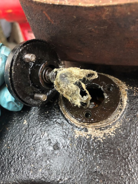

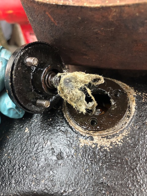

Removed the mag plug for the '25 Coupe motor disassemble prior to pulling the hogshead and found this :(
When there was much fuzz in the oil screen too, at first glance when I got this project, and spied fraying at the ends of the brake lining too, and finding this amount on the mag post (the magneto was working fine), your first thought is drums, drums, drums :o

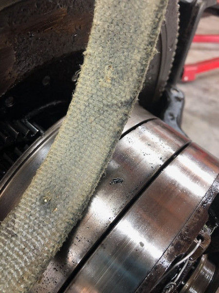

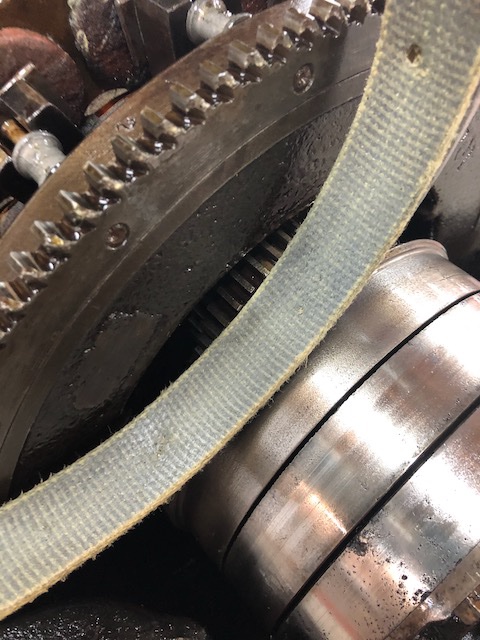

So removed the hogshead, and pulled the bands, here is the look:
Reverse lining, Kevlar, seems ok for reverse. Drum is only fair-to -poor.
Low speed, ah, some fraying on the edge....near the brake drum. The low drum is poor too, has some pitting, one pit still had a fray of Kevlar!.

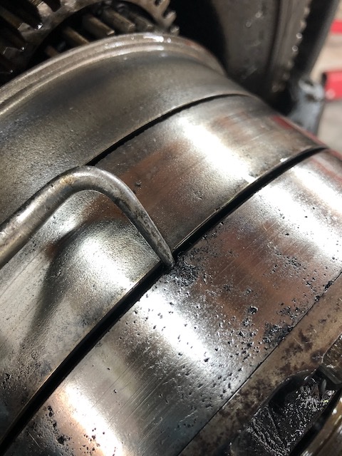

and the main culprit, brake drum. Pitting in many places, and this spot is a busted open pit on the edge. Did in both the low band lining edges, and the brake band lining.
Cause of all that fuzz...pitted drums that shred woven linings. These drums are toast.

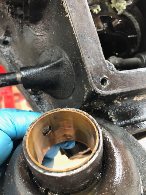

Was supposed to be rebuilt, sure is, with junk parts!
Found this 4th main, have heard of bronze or brass being used instead of babbitt, but this is first one I have seen.
Has some wear, but did fit snug on the tailshaft.

Also, notice the edges of the drums are sharp from wear. If you are going to run Kevlar lining, the edges of the drums need to be chamfered and polished as well, in addition to no big pits or excessive roughness on the drum surfaces.
